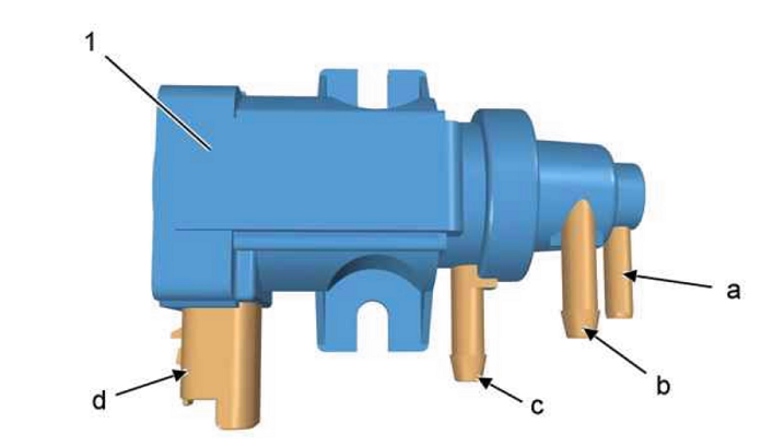

P0234: Boost pressure regulation - Air pressure above the reference value. This is a very similar fault, and points to the same suspects as the previous description.

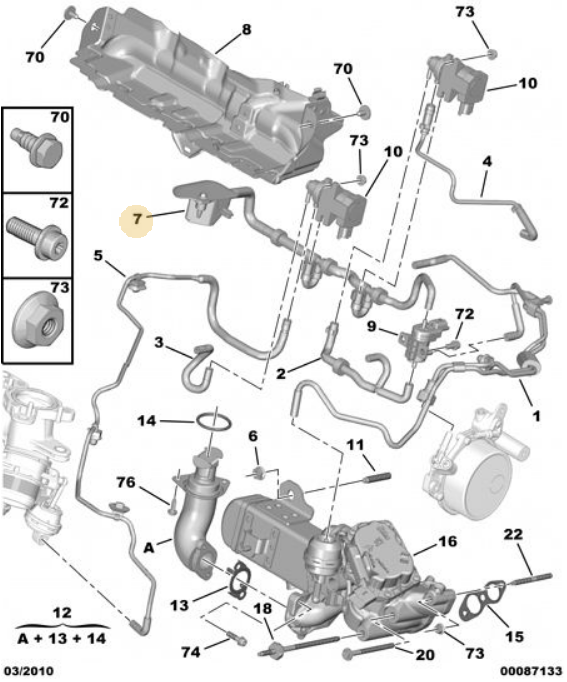

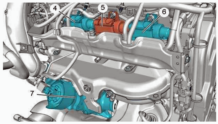

This is where it is located - the specific electrovalve is number (4)
Here's a close up of the valve:
These all vary slightly in appearance - there are videos out there on taking these off and cleaning the gauze or sponge filter - depending on type.

The most likely suspect is the turbo solenoid electrovalve - these have a sponge or gauze mesh filter contained in the module somewhere that can become blocked up over time. Take it off, clean the sponge out, dry it and put it back. That may restore the vacuum.
(4) Proportional electrovalve controlling the variable resistance turbocharger. (5) Cold air circuit electrovalve. (6) Hot air circuit electrovalve. (7) Variable geometry turbocharger. |

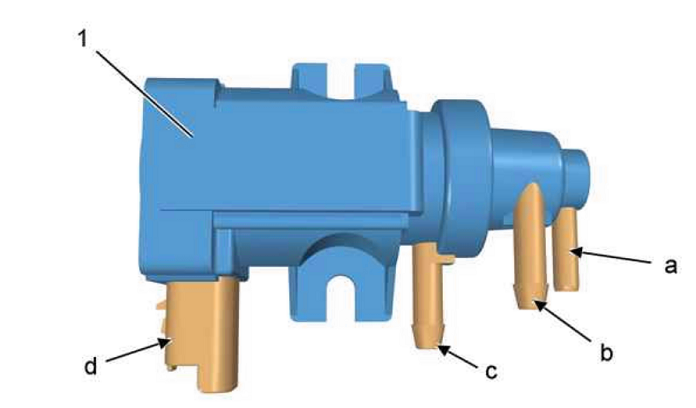

(1) Proportional electrovalve. "a" Vacuum inlet. "b" Vacuum outlet. "c" breather. "d" 2-way black connector . make: BITRON/PIERBURG. The solenoid valve is a solenoid valve that is normally closed. |
If you have a vacuum testing kit you can use that to check pressure - incase you need the part number, it is 9801887680 - which is for the DW10CTED4 engine. Post your VIN up and I can confirm the part number.

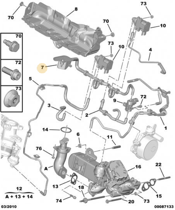

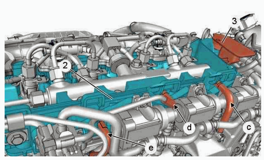

On looking further on this engine - I may have answered my own point about the electrovalve filters - on the DW10CTED4 engine, it seems there is possible a central air and air filter for all the electrovalves, as can be seen in the picture below - item (3):-
So on this engine the box shown should contain a sponge that filters all the crap out. When this starts to disintegrate it can cause some weird noises especially when switching the engine off -
It's shown here as number (7) and is part 1618QL. So may be worth checking out the condition of it. So a few things to check - the electrovalve electrical connector, the electrovalve itself as in testing there is sufficient vacuum and then the filter box below:
(2) Air inlet manifold with integral vacuum reserve. (3) Breather and filter for all the control electrovalves. "c" Outlet towards the proportional electrovalves controlling the double mixer. "d" Pressure drop inlet for the vacuum pump. "e" Outlet to electrovalves :
