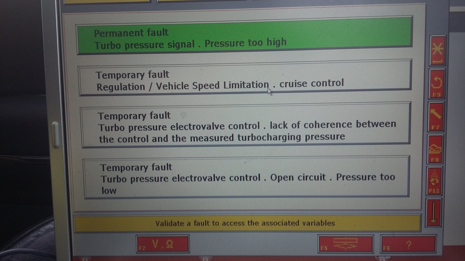

Having replaced with new the Electro Valve I got this today.
On going Turbo pressure problems C5x7 2ltr HDi

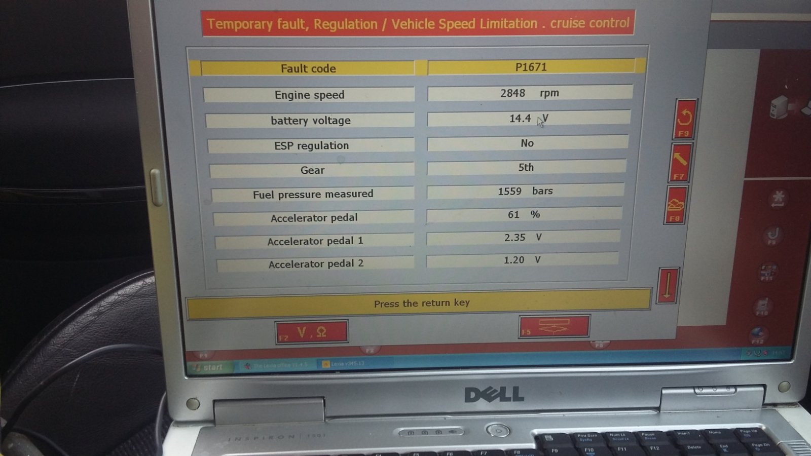

Ignore the Cruise Control issue Alasdair - that's the result of a downgrade mode applied due to the other faults:

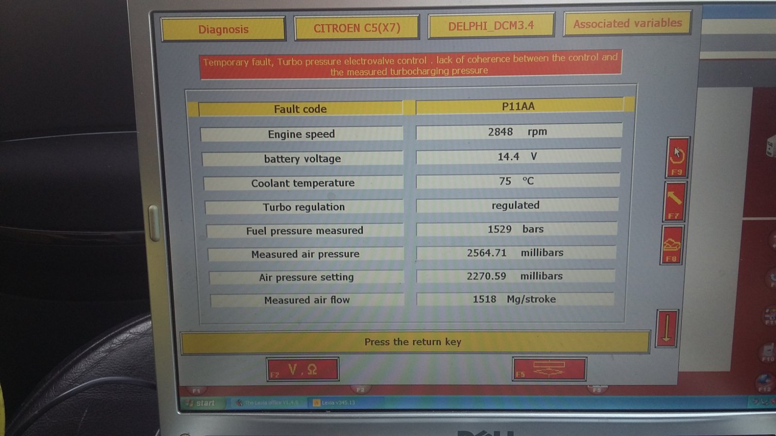

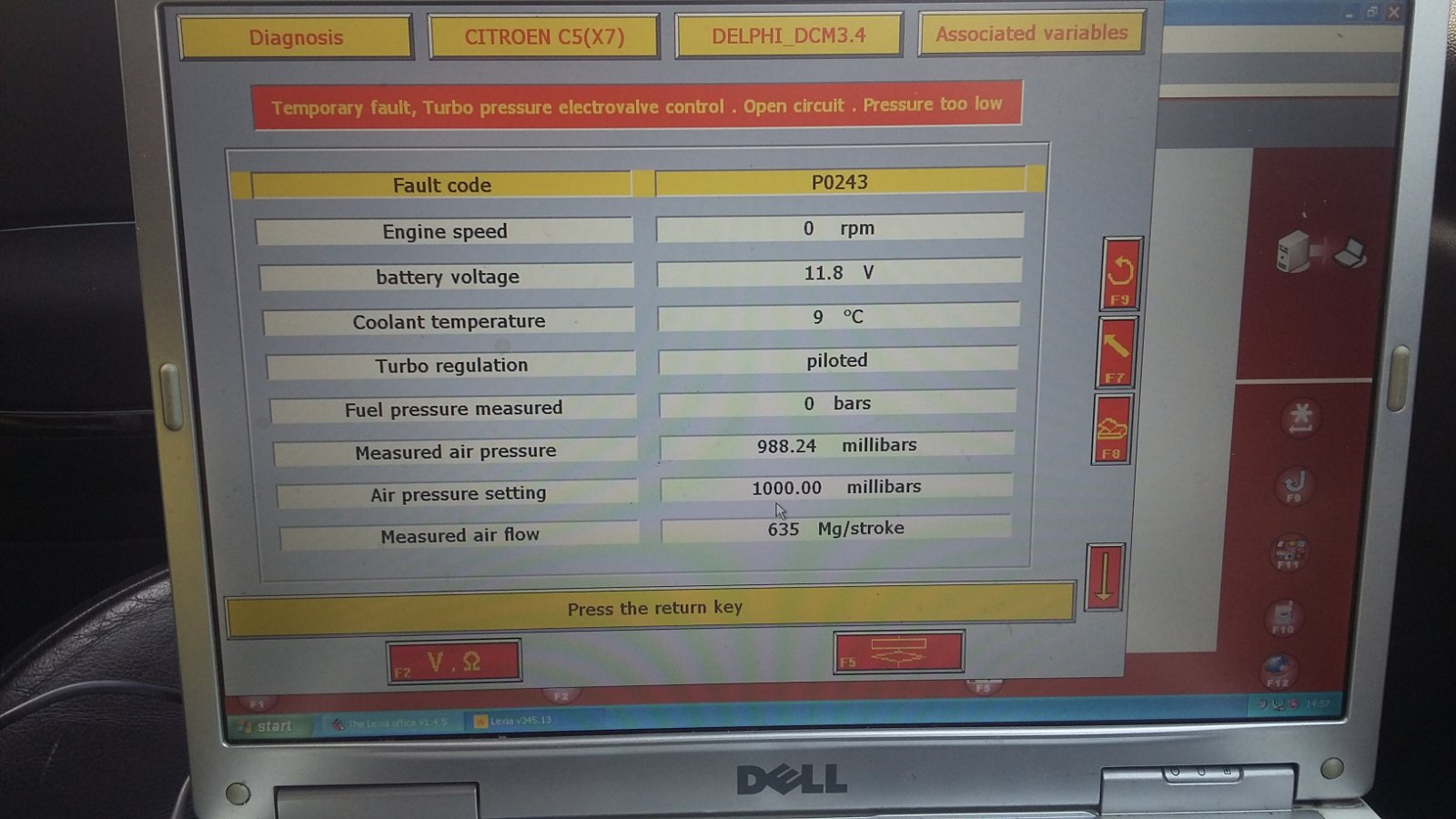

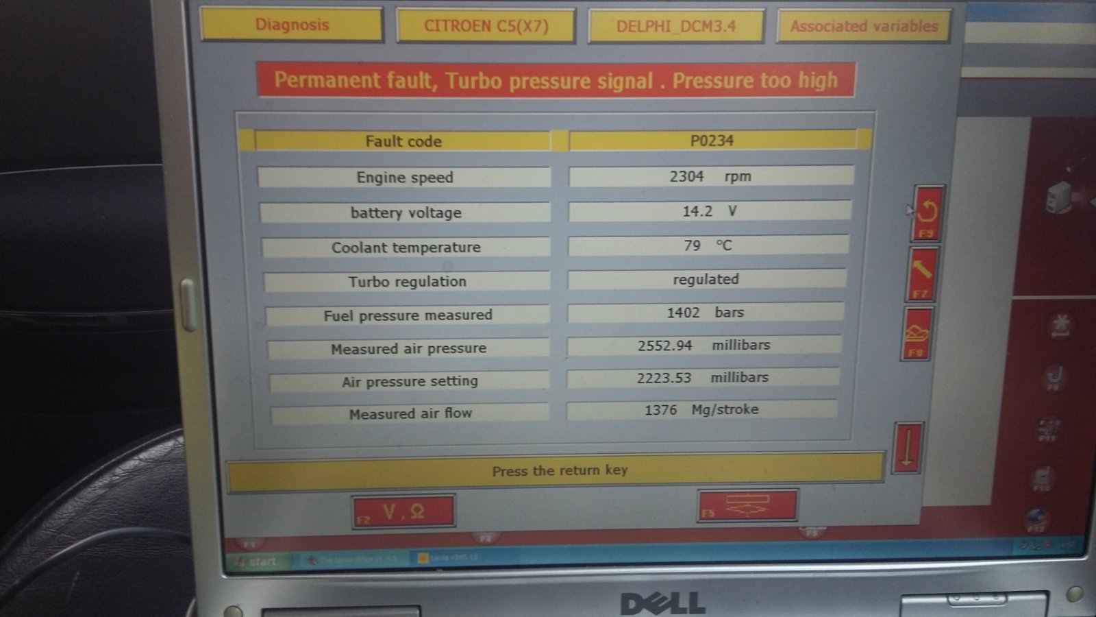

Here are the code descriptors in more detail - is there a common denominator from your original problem - did you use the correct replacement solenoid valve after all? Did these additional issues occur after replacing it? Some things to think on possibly.
P11AA: Turbocharger pressure regulation solenoid valve control: Incoherence between the command and the measured turbocharging pressure. Incoherence between the position of the turbocharger solenoid valve and the measured turbocharging pressure for 3 seconds: With the engine running, the airflow must be below 40 kg/h compared with the theoretical flow for 3 seconds.

P0243: Turbo pressure regulation electrovalve control: Open circuit. Open circuit on the turbo pressure electrovalve for 1s (pressure too low).

Negative difference between the turbocharging pressure reference value and the turbocharging pressure measured for 10 s : The pressure measured exceeds the reference value by approximately 100 mbars at high load and approximately 500 mbars at low load.

If you clear the faults, does the permanent one come back right away? If you go into parameter measurement, what does it say about the pressure with the engine off, and then when it's started, and if you rev it up a bit?

It will come back when I put load on it (live data at that point is hard as the laptops battery is pants)
I cannot seem to make it "ping" by revving it static.
I will do what I can tomorrow to look into "parameter measurement" and screen shot.
