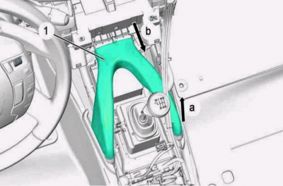

Recommendations are that the central console trim be removed, so that the footwell air duct can be slid back to reveal the Airbag ECU. Disconnect the connectors (which may need the ECU bolts undone).
Slide towards 'a' first, then 'b'......to reveal the Airbag ECU

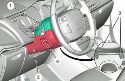

Remove:
  • The bolts (2)
    The steering column upper half cowl (1)
Release: The steering column lower half cowl (3).
Disconnect the supply connector of the headlamp beam corrector (at "a").
Remove the steering column lower half cowl (3).

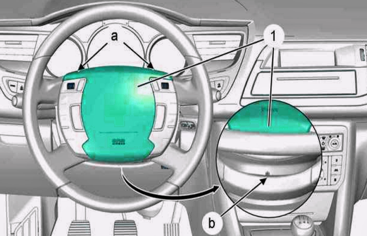

Engage a pin punch (6 mm diameter) in the opening ( as "b").
Compress the retaining spring using a pin drift.
Unclip the airbag (1) (pull towards you) ( as "a").
Detach the driver’s air bag (1).

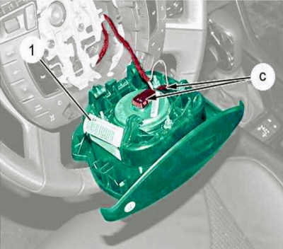

ESSENTIAL: When removing an airbag, disconnect the supply connector first.
Disconnect the connectors (Driver’s airbag ) ( as "c").
Remove the driver’s air bag (1).

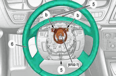

CAUTION: Do not hit the steering wheel with fixed central controls.

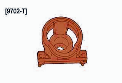

Fit the tool [9702-T] before removing the fixed centred controls steering wheel.
Immobilise the steering wheel with fixed in central controls (6) using tool [9702-T].
Clip the tool [9702-T] at "b" on the fixed centred controls steering wheel (6).
Remove the 3 nuts (5).
Release: The steering wheel with fixed central controls (6).

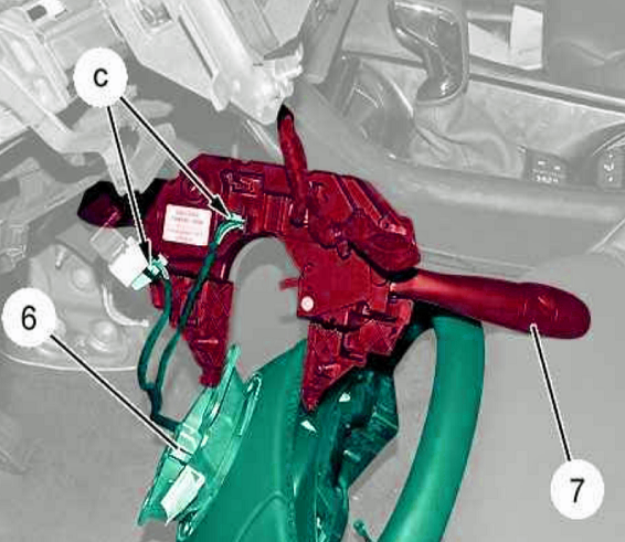

Release: The controls module at the steering wheel (7).
Unplug te steering wheel control module connectors (7) (at "c").
Remove the steering wheel with fixed central controls (6).

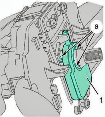

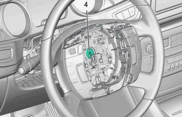

Unclip the steering wheel angle sensor (1) at "a".

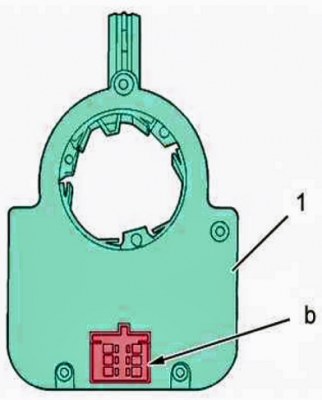

Disconnect the connector at "b" behind the steering wheel angle sensor (1).
Remove the steering wheel angle sensor (1).

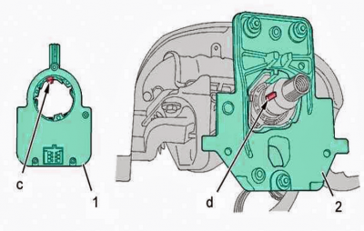

Refit the steering wheel angle sensor (1).
N.B.: Align the foolproof "c" of the steering wheel angle sensor (1) with the groove "d" of the steering column (2).
Connect the connector ( as "b").
Clip on the steering wheel angle sensor (1) ( as "a").
