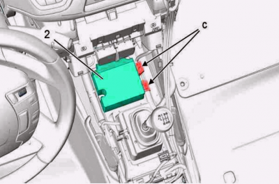

When working with Airbag components leave a minimum of 10 minutes after battery disconnection for Airbag ECU energy dissipation.

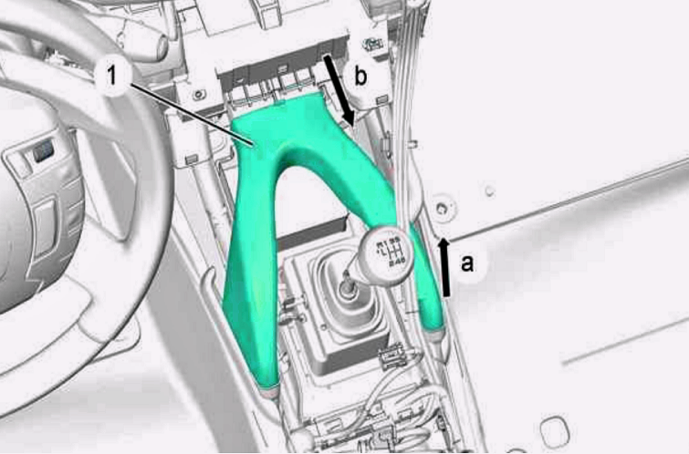

Recommendations are that the central console trim be removed, so that the footwell air duct can be slid back to reveal the Airbag ECU. Disconnect the connectors (which may need the ECU bolts undone).
Slide towards 'a' first, then 'b'......to reveal the Airbag ECU
Note: When later reconnecting, always attach the earth connector first, then tighten the bolts (2) to 0.8 m.daN

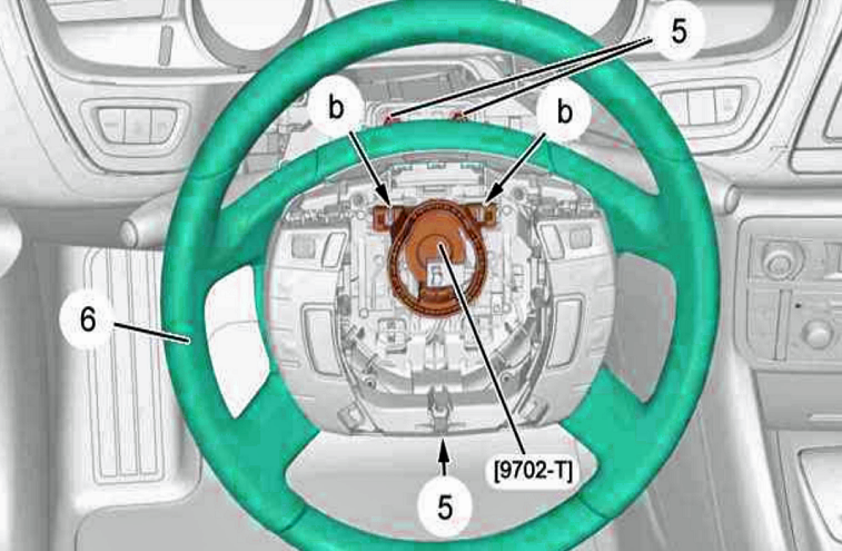

CAUTION: Do not hit the steering wheel with fixed central controls.
Fit the tool [9702-T] before removing the fixed centred controls steering wheel.
Immobilise the steering wheel with fixed in central controls (6) using tool [9702-T].
Clip the tool [9702-T] at "b" on the fixed centred controls steering wheel (6).
Remove the 3 nuts (5).
Release: The steering wheel with fixed central controls (6).

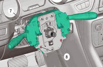

Remove the bolts (8).
Release: The controls module at the steering wheel (7).

Many Thanks.. even with all this information its incredibly hard to track this down I don't think its wiring issue I think it is one of many ECU,s what makes this hard is the fact the first thing on the dash is faulty braking system put Lexia points to just about nothing on the braking system and does not ever put a ABS light on, so Lexia says all faults are on the ESP81 , and the main thing has to be no communication with the gyrometer, so ive tried 4 second hand units and all say the same so I don't think the issue lays with the gyrometer , so the only credible thing Lexia tells me is that the steering wheel angle sensor is Faulty and will not calibrate up , remember that if there is no coms with gyrometer evidently you cant calibrate the SWAS, so ive got to try changing the SWAS first and if that makes no difference then its could be the ESP/ABS unit ..it could be the BSI, it could be the main fusebox, or the Main ecu see what I mean there is just to many variable's.. next stop is the scrap yard....
