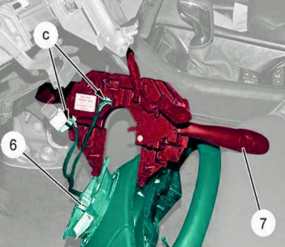

CAUTION: Do not hit the steering wheel with fixed central controls. Fit the tool [9702-T] before removing the fixed centred controls steering wheel. Immobilise the steering wheel with fixed in central controls (6) using tool [9702-T]. Clip the tool [9702-T] at "b" on the fixed centred controls steering wheel (6). Remove the 3 nuts (5). Release: The steering wheel with fixed central controls (6). | Remove the bolts (8). Release: The controls module at the steering wheel (7). |

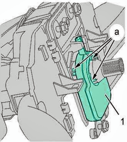

Unplug te steering wheel control module connectors (7) (at "c"). Remove the steering wheel with fixed central controls (6). | Unclip the steering wheel angle sensor (1) at "a". |
Disconnect the connector at "b" behind the steering wheel angle sensor (1). Remove the steering wheel angle sensor (1). | refitting: Refit the steering wheel angle sensor (1). N.B.: Align the foolproof "c" of the steering wheel angle sensor (1) with the groove "d" of the steering column (2). Connect the connector ( as "b"). Clip on the steering wheel angle sensor (1) ( as "a"). |

Many Thanks.. even with all this information its incredibly hard to track this down I don't think its wiring issue I think it is one of many ECU,s what makes this hard is the fact the first thing on the dash is faulty braking system put Lexia points to just about nothing on the braking system and does not ever put a ABS light on, so Lexia says all faults are on the ESP81 , and the main thing has to be no communication with the gyrometer, so ive tried 4 second hand units and all say the same so I don't think the issue lays with the gyrometer , so the only credible thing Lexia tells me is that the steering wheel angle sensor is Faulty and will not calibrate up , remember that if there is no coms with gyrometer evidently you cant calibrate the SWAS, so ive got to try changing the SWAS first and if that makes no difference then its could be the ESP/ABS unit ..it could be the BSI, it could be the main fusebox, or the Main ecu see what I mean there is just to many variable's.. next stop is the scrap yard....
2002 2.2hdi C5
- Posts: 99
- Joined: 24 Dec 2012, 14:35
- Location: Cumbria
- My Cars: Citroen c5 , Audi A3 S line TDI
Re: fuse box under the bonet c5 x7 2.2hdi PSA
quick update on this is its not to hard to get the SWAS off following the above from marc, im just waiting for my second hand one to arrive and then if that doesn't work im going to look into the ABS/ESP Unit
