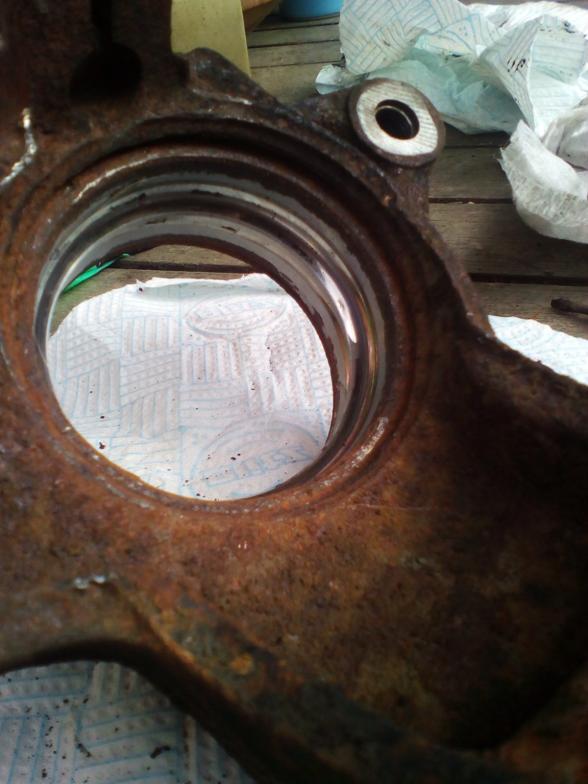

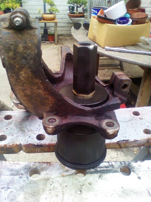

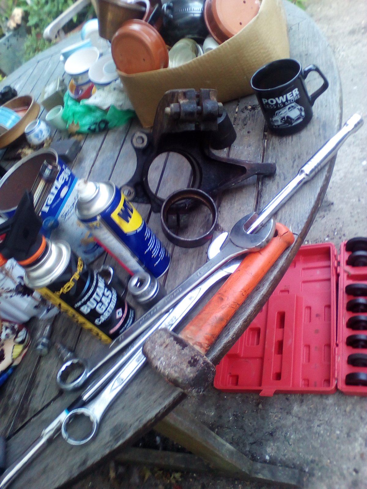

A few hours over 2 days a bit of blow tourch wd40 other brands are for sale and my bearing kit ... Final ready for a new bearing.
Thank you all whom helped this really is a fantastic club..

I saw the mortar hammer there, but no sign of the pneumatic drill...
Looks like your having fun anyway.

I've pulled a few bearings using one of those kits - certainly get a sweat on by the time it is out!!

I would cut that bearing with a dremel rather than press it out.

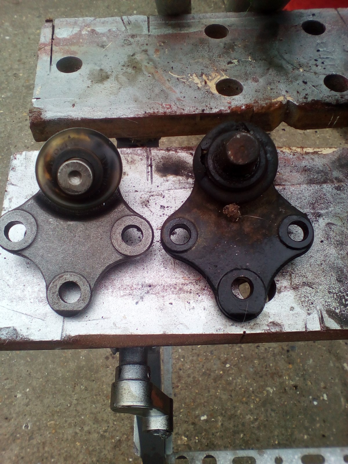

moizeau wrote: 12 Jul 2019, 18:24 When your done with repairs.....is it for sale? I need to replace the BX.
No not yet , just got it back on the road ,all what I'm doing is due to a pinch bolt failing on the lower ball joint, the company whom sold it are playing the out of warranty card, considering it only did 800miles the photo says it all really,

If you have a welding set, put a run of weld around the outer bearing race(where the bearings would have run) The heat will shrink the race and if it doesn't fall out, It will require only light taps.
