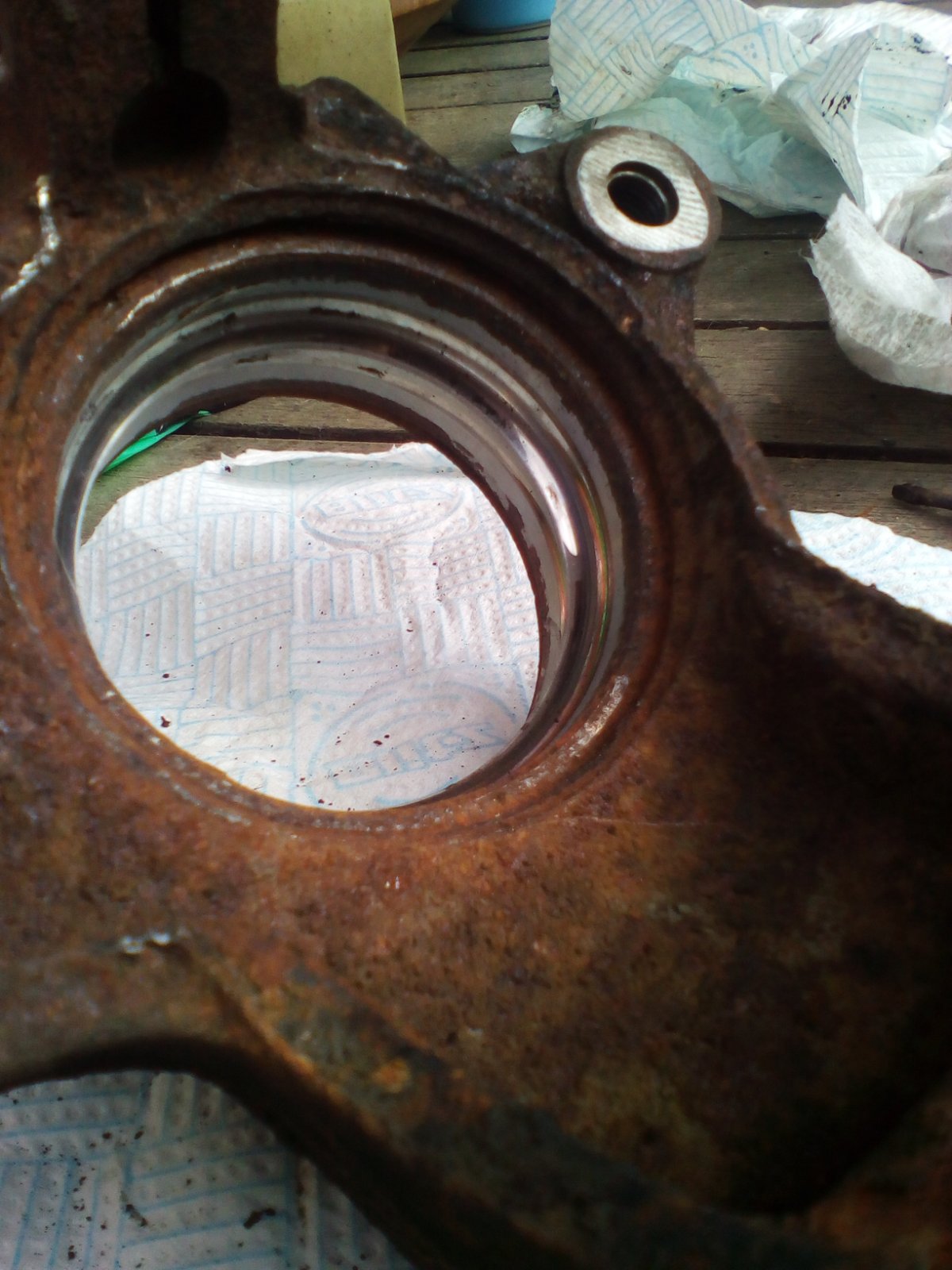

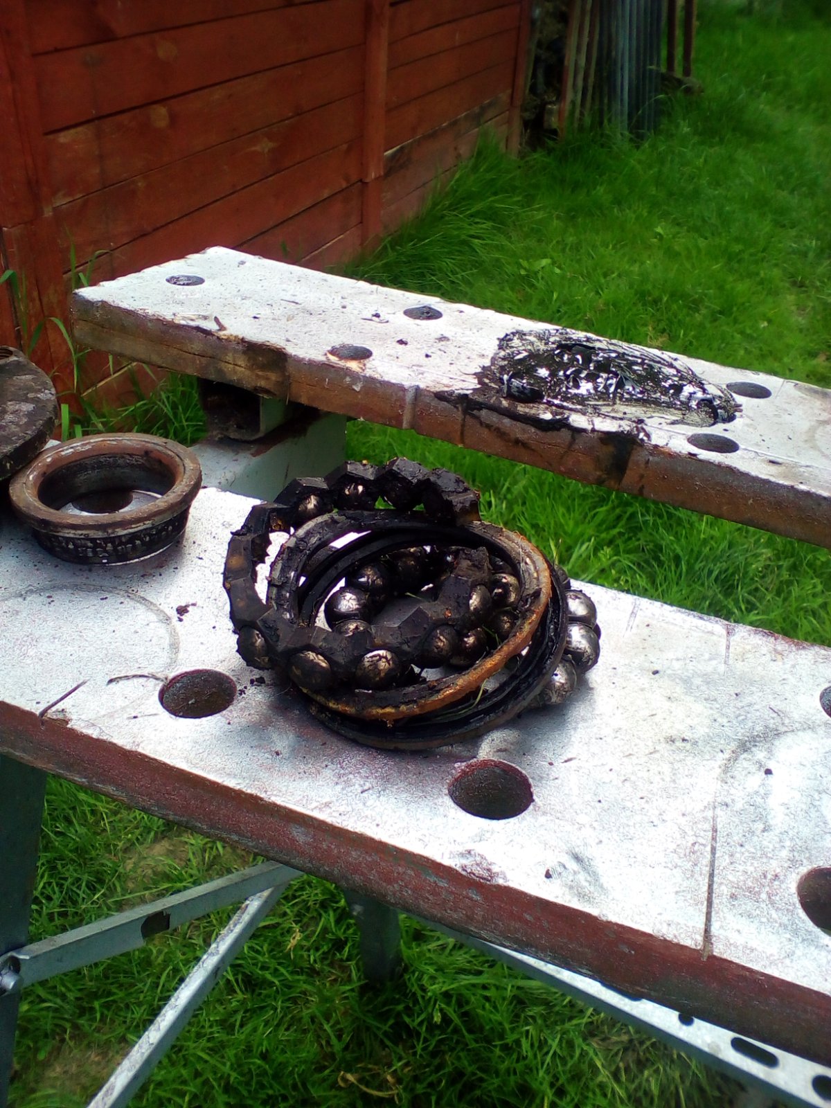

Re: Front suspension , Drive shaft rebuild, Help
RichardW wrote: 08 Jul 2019, 12:23 There's only 1 part number for XU engined ZXs - 335016. Surprisingly only £37.04 at the dealer - however, it's a widely used bearing, so I would expect it to be easily available aftermarket from SKF (I would only fit an SKF or SNR bearing - unless you want to do it again in a few months!). e.g https://www.mister-auto.co.uk/wheel-bea ... /vkba-915/ if you search on VKBA-915 you will no doubt find plenty of others.
That bearing looks like it might put up a bit of a fight before it is released from the hub carrier!!
Mine are double roller type I'll try post a picture
Husky.
- Posts: 12532
- x 1474
That's right - the outer race of your bearing is still in the hub carrier and needs to be pressed out - after you remove the circlip that's presumably hiding in there somewhere disguised as rusty crud...!

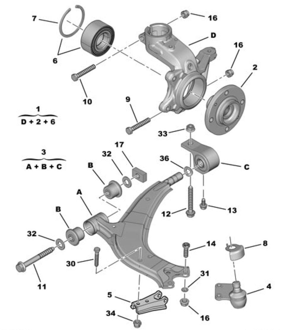

Item 6, part number 335016 £37.04 for an original part, Or there is a cheaper one supplied by Citroen, part number: 1623948380, priced £27.12, all inc. VAT.
RichardW wrote: 08 Jul 2019, 22:18 That's right - the outer race of your bearing is still in the hub carrier and needs to be pressed out - after you remove the circlip that's presumably hiding in there somewhere disguised as rusty crud...!
Oh my ... That's going to be hard
See photo

Thank you so muchGiveMeABreak wrote: 08 Jul 2019, 22:24 CD2E7010-8062-40C8-89DD-AE1CCA4991B8.jpeg
Husky.
- x 6963
If you identify any other part numbers you need, just tell me the item numbers in the diagram. I wasn’t sure if you needed the self locking nut (16), but ask if you do.

GiveMeABreak wrote: 08 Jul 2019, 22:33 If you identify any other part numbers you need, just tell me the item numbers in the diagram. I wasn’t sure if you needed the self locking nut (16), but ask if you do.
Thank you,
As many numbers as possible.
I'm rebuilding the complete side so all and any parts numbers would be great.
What threw me was the wheel bearing I thought it had all come out , till someone confirmed on here the rest was still in the hub, I've got a pressing kit so that a be fun , said no one ever..
