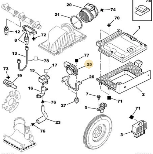

Item 25:
Accelerator pedal intermittent no response - C5 2003 2.2 hdi MK1 manual

Re: Accelerator pedal intermittent no response - C5 2003 2.2 hdi MK1 manual
Yes it has cruise control. It’s the 2.2 exclusive.
So possibly the Comms 2000 unit?
Thanks Marc.. that’s the bit I changed....twice!
No, that won't be anything to do with it. The cruise will only vary according to controls pressed at the stalk to increase, decrease, pause, resume and activate or deactivate. It can NOT autonomously engage itself and you didn't mention that you had activated cruise control. If you didn't then absolutely this cannot engage for safety reasons.chasqui wrote: 01 Jul 2019, 21:31 Yes it has cruise control. It’s the 2.2 exclusive.
