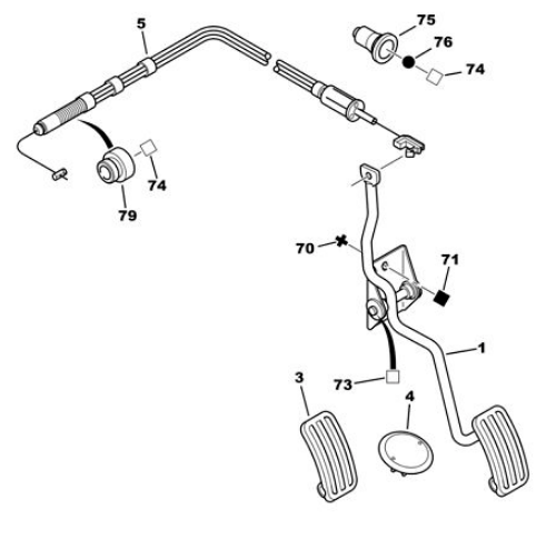

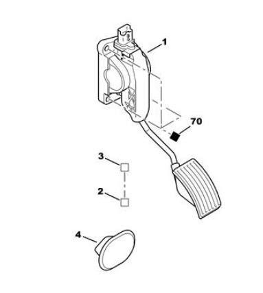

Well that wasn't really much help unfortunately as either type could be fitted - so you'll have to do a visual check to see which you have:
None of the accelerator pedals are available from Citroen now (NFP)
So I would expect some sort of code to be stored if it is loosing speed - unless the accelerator pedal is faulty (assuming the electronic one) and that it is just thinking you have removed your foot off the pedal so is slowing down. So a careful check of its condition may be in order - but honestly I don't think there is much you can do if the tracks have or are beginning to wear on it, short of replacing it. If it was engine related - again I would expect a code.
| Electronic Type | Mechanical Type with Cable |

I guess 5 in the mechanical diagram is the cable going in to the throttle position sensor from the pedal?
I’m not with the he car now but I did remember having re attach a cable to the throttle position sensor when I changed it.
There were no faults shown in Lexia at the time though I will check again during the week.
I’ll try to source a used part off eBay to see if that makes a difference.
The car just slowed down without me moving my foot. Pressing down had no response. Releasing the pedal and then pressing down caused it to work again. (Except the one time I mentioned in first post)
Thanks Marc

No worries - yes the wire will work on similar TPS in the engine.
