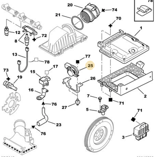

chasqui wrote: 01 Jul 2019, 15:52
myglaren wrote: 01 Jul 2019, 15:27
chasqui wrote: 01 Jul 2019, 15:24 No! Never heard of the stepper motor,, where is it? I’ll have to research!
Not certain but presumably on the throttle body.
Marc will know :)
I’ll explore that. Thanks
Item 25:

GiveMeABreak wrote: 01 Jul 2019, 17:36
Marc will know :)
Item 25:
Thanks Marc.. that’s the bit I changed....twice!
