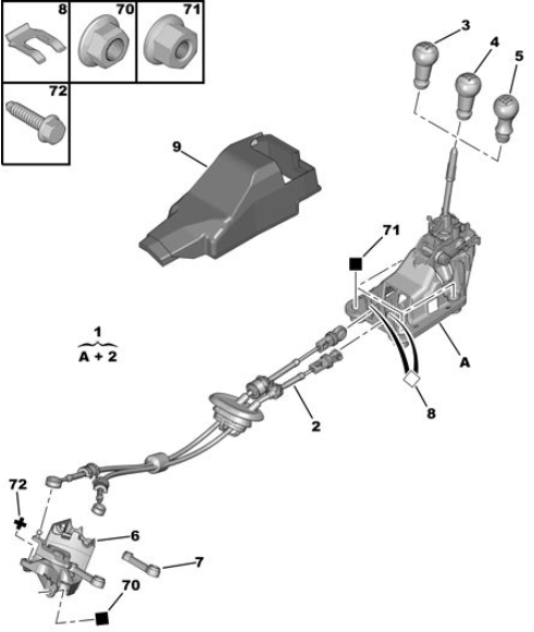

Ok, so the cables are not available separately. Part (1), the gearshift control lever comes as a whole unit including the cables.
The part is: 2400JZ and they are £274.25 inc. VAT direct from Peugeot, as of this post.

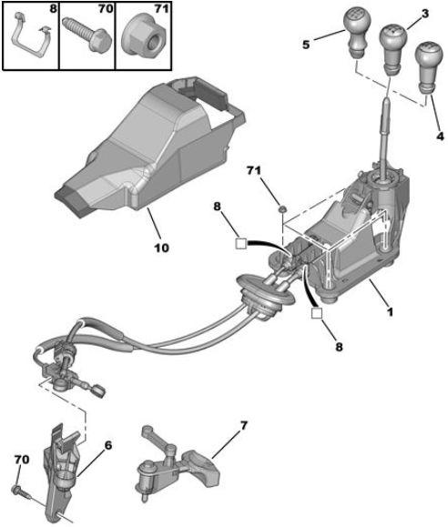

The temporary fix I applied in August (following my previous posts) has now failed and one of the cables has snapped. Given the car is 14 years old I want to try to find a cheap set of cables on an auction site!
Trying to figure out which are the correct ones for VIN VF3**************[VIN obfuscated, can be read by forum staff] if someone could tell me what the official part number is.

Yours is slightly different:
The gear cables on this box (2) are available separately, part: 2444CZ
They are £228.58 inc. VAT from Peugeot as of this post.
