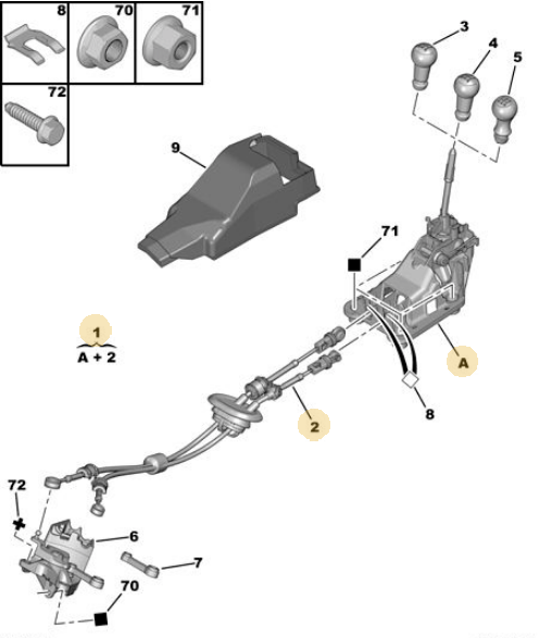

Re: Help required Identifying what 207 gear linkage cable
Unfortunately they do not sell the cables separately on this gearbox / engine combo, as you can see: Item 2 is not available or listed.
Your build code is: 12002 (18/09/2009)
These were no longer supplied from build code: 11683 (03/11/2008)
Item 2 (control Cable) was part 2444CZ - so whether there was a modification to any associated parts or not I can't say, nor whether it will fit or not. But is does cost £238.70 inc. VAT, which is the same as the whole thing as you were quoted any way

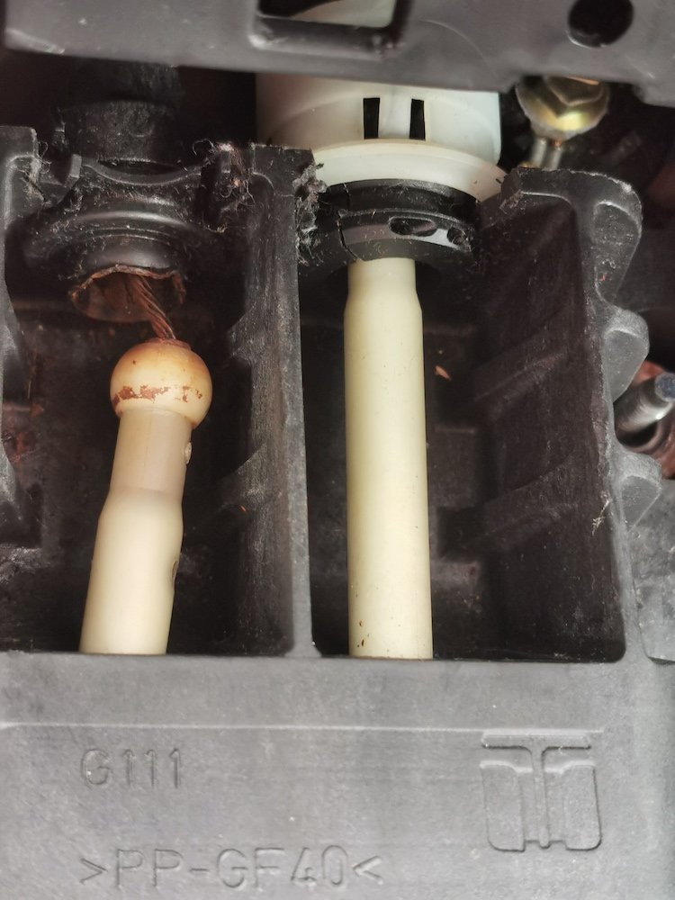

Apologies for re-opening a two year old thread but I have the same identification issue for ?a 2007 registered 207 1.6 HDi Sport.
Having removed the centre console it appears that item 2 (in the image above) is starting to fail. The ball of one of the white plastic parts (the one pointed to by the number 2 actually) seems to have come out of the socket into which it looks it should be inserted.
As the car is now 14 years old and has been relegated to the duties of teaching the learner to drive I don't want to spend huge sums of money but need to make sure any second hard parts are going to fit.
Related question, is it possible to fit the gearbox end of the cables on a driveway?
-Andy.
This is what I am dealing with:
I was wondering whether it would be possible to shape some kind of acrylic block to force the lever to into the correct place.
The issue that caused me to start poking around was not being able to move the gear stick to the left to engage 1st or 2nd gear.
-Andy.
-Andy.
In theory you could bond it into place but it looks like the inner cable has now kinked which means it may jam in the outer cable.
