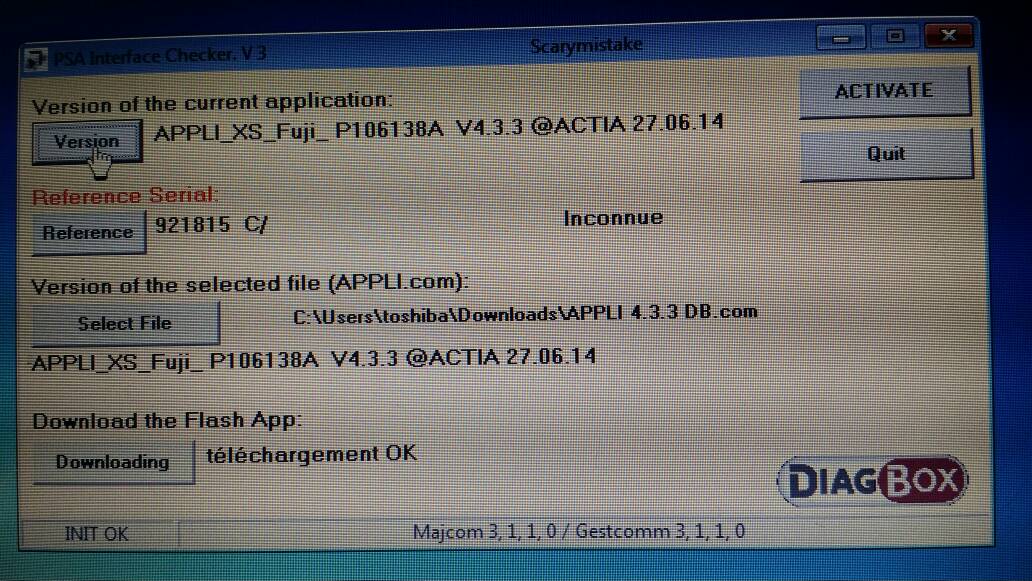

I have run the checker on my Lexia and the results are below.
If it's one I can flash, please can you direct me to the files please Marc. I've emailed you..

Great, thanks a lot Marc. I've flashed it, as per your suggestion of one step at a time up to v4.33
I'll now reinstall DB7.02 and upgrade it to 7.15 and seen if it works this time.

Well, despite Marc's great help - Diagbox 7.15 now installed and activated, Lexia interface updated to 4.33, I still can't get any dialogue with any ECU - every single one comes up with NO. I suspect the cable between the Lexia and the socket is duff, as I get exactly the same result when I simply leave it unplugged.
I checked fuse F6 - the diagnostic socket fuse, it's ok but I replaced it anyway.
So, looks like my hardware is duff :( I'm even more inclined to think this as Hell Razor James Lexia worked fine on this vehicle a couple of weeks ago.
Damnit.
Sent from my SM-N9005 using Tapatalk

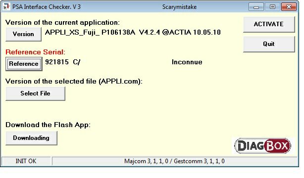

Well, Ben's cables work on my system, but when I try using his Lexia I cannot 'talk' to the ECUs. However, the firmware checker works. I know that my Lexia, the short USB cable and the interface cable work.

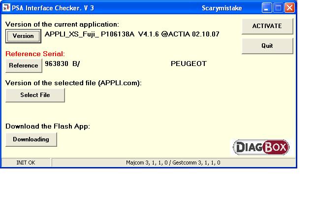

I am trying to check the version and diagbox compatibility of my old Lexia interface.
When I run the PSA Interface Checker.exe file, I get as far as the language selection screen, and then the installer crashes.

As there was no question in the post John, I'll just jump in and confirm you have the older blocked revision 'B' interface. You should be fine with Diagbox versions prior to V7 - or and a big or - you may get away with an early V7 - but it is hit and miss. If you don't need to upgrade your Actia, leave it as is. (I can't tell what car you have as you don't have it on your Avatar / profile :)

My interface is as old as I thought... I don't suppose that there is much chance of it working with a Peugeot 308?
x 6945
Re: Lexia woes
What year is the 308? Here's the thing - depending on the year, some of the ECU software may of been written after the older PP2000 software was written, so some ECUs may not be readable; so now in addition, we have the added problem that Revision 'B' clone interfaces were 'blocked' by PSA. The revision 'C' clones are ok and should work fine with the all the current line up of cars, with the exception of a few commercial PSA vehicles. There are some guys who say they can reflash the Revision B interfaces to revision C for a small fee - before you can upgrade to the later versions of Diagbox - which in turn supports some of the newer cars.
Also, your firmware is currently 4.1.6 and Diagbox 7.01/02 needs 4.3.0 - but not much point if your interface may not work with V7. Appologies if this is all a bit confusing!
