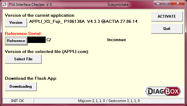

Here is a screenshot of the software, where you can see the info:
Connect your Lexia to the USB port (but not the car)
Load the PSA Checker software
Click ACTIVATE (this just enables the interface, nothing else)
Click VERSION to give you the version info - in the example above you can see mine has been flashed to Firmware V4.3.3
Click REFERENCE to display the serial reference of the unit and the revision (in this case Revision 'C')
Don't choose SELECT FILE and DOWNLOADING buttons - as these are a) SELECT FILE tells the software where the Firmware file is located on your PC and b) DOWNLOADING tells it to start flashing the file to your unit. Only use these buttions if you know what you are doing!
:-D
This tool can be used to safely check what version and revision your Actia interface is and what firmware you have. This may highlight one possibility as to why the ECUs can't be read on some vehicles by having an older revision or firmware. One of the other reason's of course is a broken solder joint or damaged pin for example.
