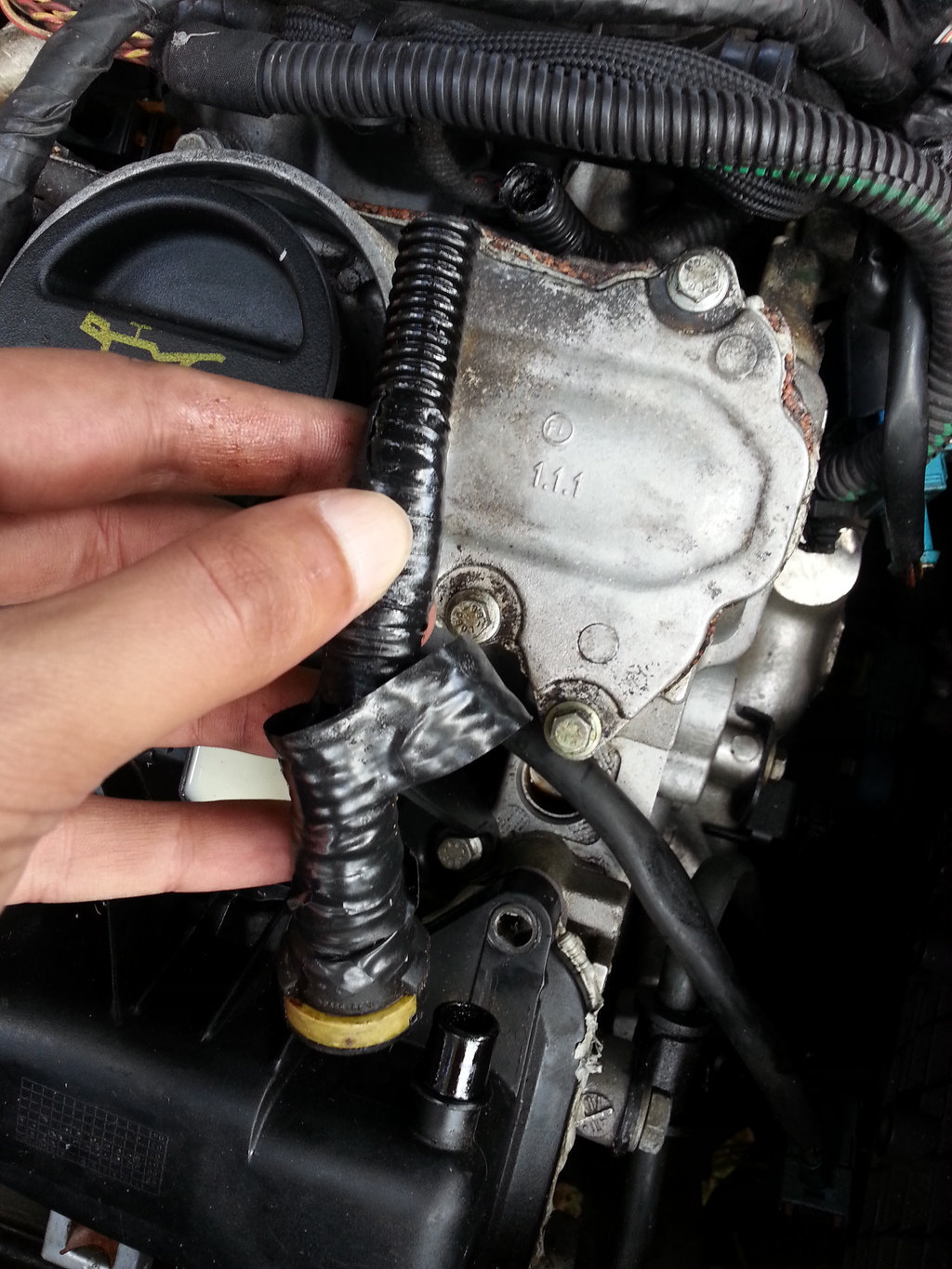

Anyway here is another pic
The hose was so brittle it just snapped off. Easiest cheapest way to fix?
Is insulation tape enough?
Posts: 10825
Joined: 09 Nov 2005, 22:03
x 1392
Re: 2002 Citroen C5 3.0 V6 oil burning smoke smell...help
Unread post by xantia_v6 »
That is just an oil breather hose, so can be replaced with anything the right diameter that will withstand engine heat and oil fumes. The hard part is joining it without breaking anything else.
I did fix one by finding a piece of copper tube (about 50 mm long) that fitted snugly inside, smeared the outside of the copper tube with silicone sealant, slipped it in and coated the outside of the joint with some sealant so that i could see that it wouldn't leak.
