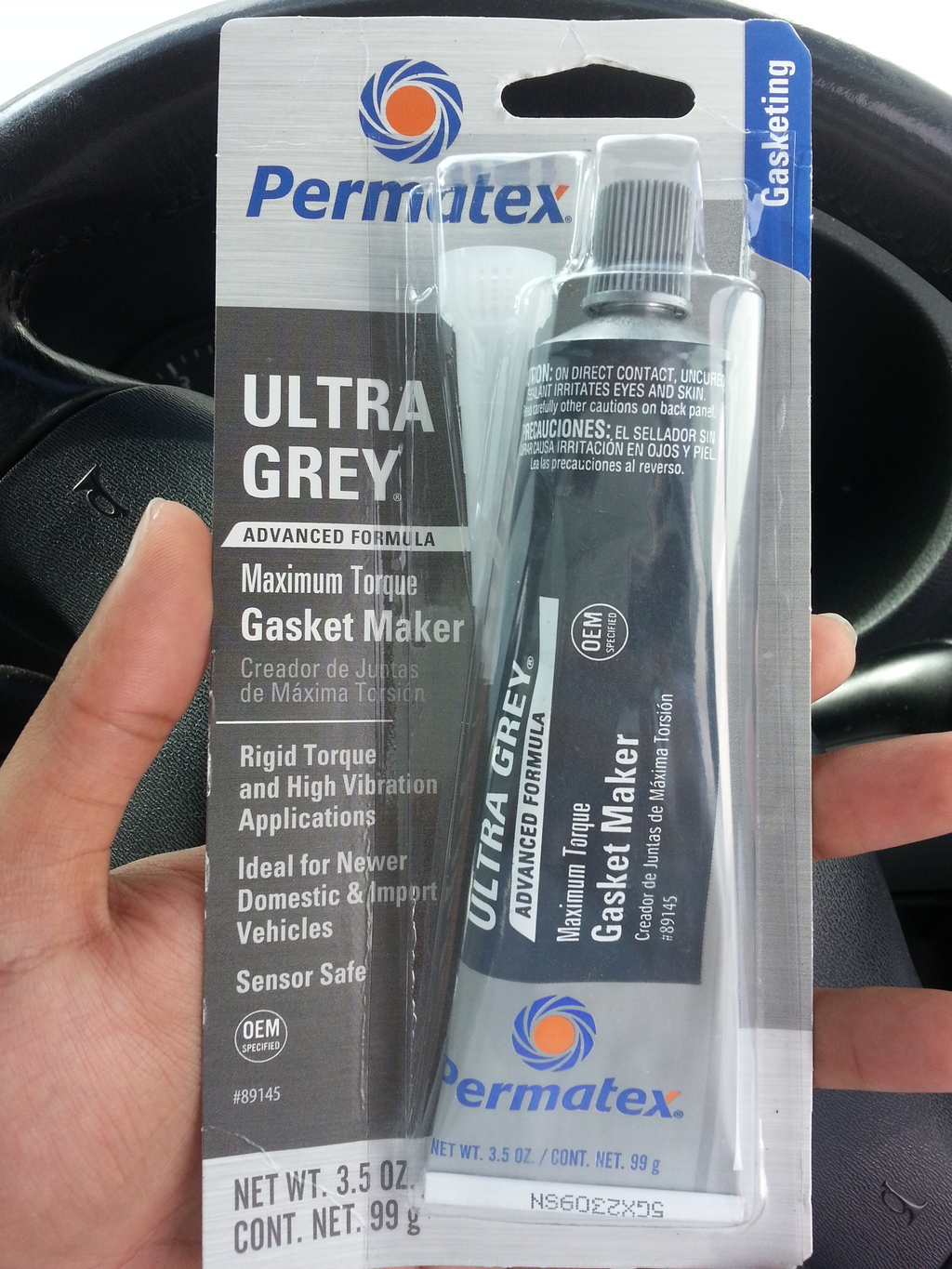

luqies
- Posts: 16
- Joined: 08 Feb 2016, 14:38
- x 1
- Posts: 11014
- Joined: 09 Nov 2005, 22:03
- x 1484
Re: 2002 Citroen C5 3.0 V6 oil burning smoke smell...help
That stuff should be OK, certainly better than nothing.
