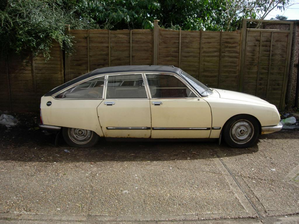

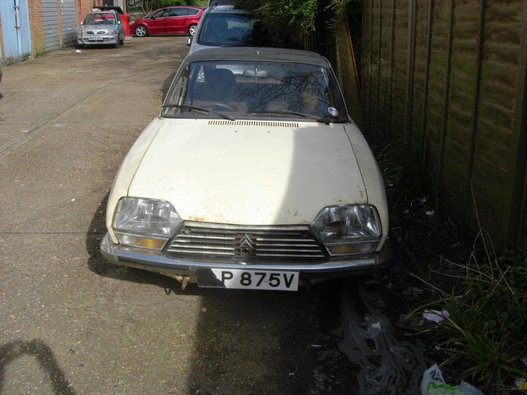

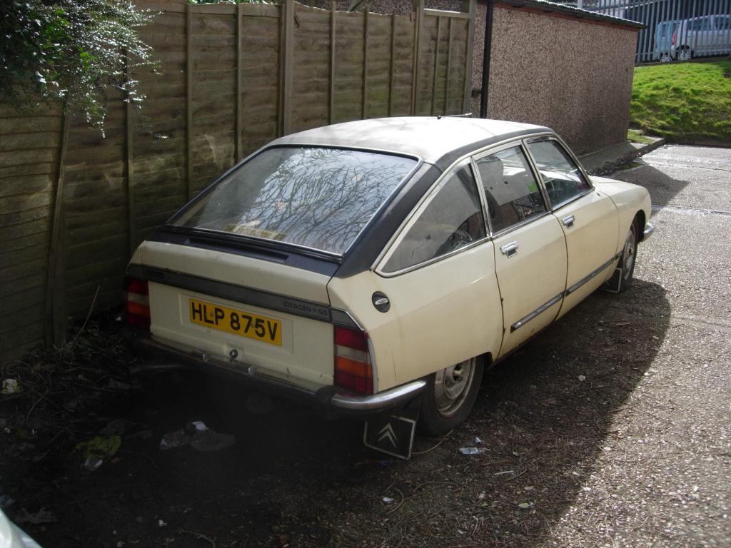

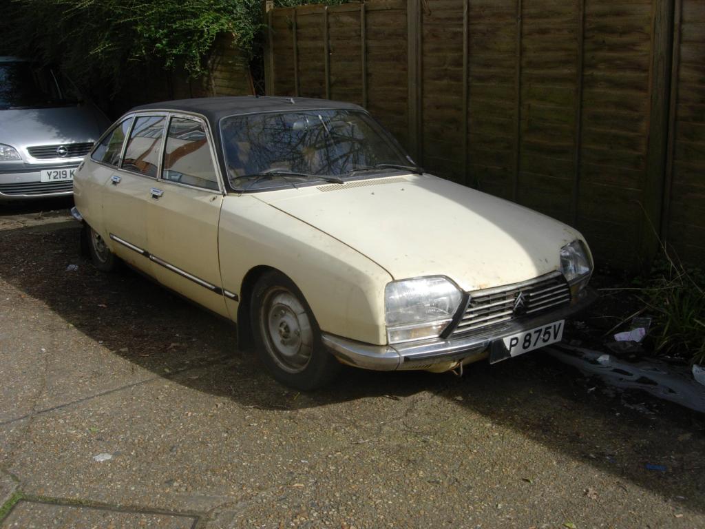

Well done bud, fingers crossed that your blinding flash isnt just a senior moment!! Here are some more piccies of the old girl!!
