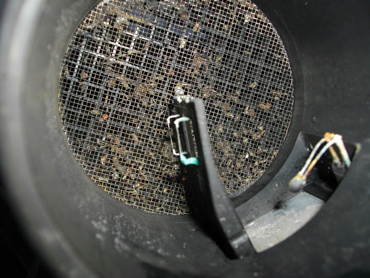

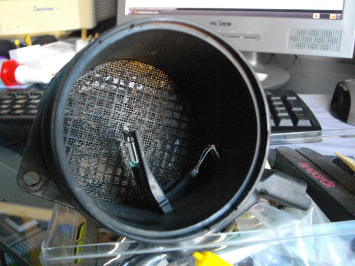

Bought a MAF from the dealer - at long last, had to order it as they don't hold them in stock.
Ironically the car shot down there effortlessly with no Antipollution fault showing, whizzed along as though nothing was wrong.
Changed the MAF and found the old one much corroded and th 'flyscreen' has a lot of crap in it.
Rather more worrying was that the air filter was soaked - fairly new one, been on about four months. New one ordered.
I did also notice while I was out and about yesterday and today a slight noise a bit like an electronic screech but may be a pneumatic
Very faint but needs investigating.
Old MAF, apologies for crap photo's - it is sitting on the desk and they are just p&s shots.
Still haven't found what the code (P1637) was.
