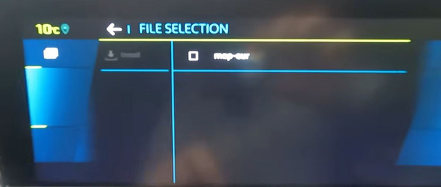

Unread post by rui_saraiva »
denis1304 wrote: 01 Sep 2026, 18:09 Hello
I have 42.03.31.32_NAC-r0 on my Peugeot 508 hybrid, from 2022.
Is there any meaningful difference between 42.03.31.32_NAC-r0 and 44.06.44.22_NAC-r0 or 44.07.33.32_NAC-r0? Currently everything works OK.
The MyPeugeot app is telling me I can update FW to the 44.06.44.22_NAC-r0 version and maps to the 20.0.0-r0 version.
Can I just update maps I'm interested in without updating the FW to 44.06.44.22_NAC-r0 or 44.07.33.32_NAC-r0?
How long does it take to update FW and a map for one country?
Thanks
In your case (NAC_EUR_WAVE4 system), using the Peugeot Update software, you can only update the maps. The 44.06.44.22_NAC-r0 firmware version has an expired signing certificate and is impossible to install. You can install the 44.07.33.32_NAC-r0 version, but you have to use the link on my page. Except for bug fixes, you shouldn't expect any new features in those firmware versions - if it ain't broken, don't fix it.
You can just update the maps.
The firmware update takes about 30 minutes and the map about 45-60 minutes. In NAC_EUR_WAVE3 and NAC_EUR_WAVE4 systems, you can individually choose the countries to install, but it really doesn't make much difference (it verifies all the files anyway). The system is prepared to update the maps whilst driving.
Regards,
Rui Saraiva
All NAC, CRONY2, AIO, RCC & RCE updates: https://sites.google.com/view/nac-rcc

denis1304
Posts: 10
Joined: 10 Feb 2023, 10:49
Re: PSA NAC RCC Updates
Unread post by denis1304 »
rui_saraiva wrote: 02 Sep 2026, 23:18
Thanks for the replay.
Can you clarify one more thing for me...
When I started updating maps, it asked me if I wanted to update maps, I selected YES.
Then it gave me an option to select map-eur and install... Here I stopped the process since I wasn't sure if I would be able to select just the countries I want to update.
Is there an option to select wanted countries after I select map-eur and install?
Thank you

rui_saraiva
Posts: 135
Joined: 15 Feb 2023, 10:31
x 63
denis1304 wrote: 03 Sep 2026, 09:32
Thank you
Yes, the list of countries is in the next screen. Remember that you cannot install just one country that you didn't select in any previous installation - you've to reinstall all of the countries you want.
Regards,
Rui Saraiva
denis1304
Posts: 10
rui_saraiva wrote: 03 Sep 2026, 20:11
Thank you
I'm sorry, but I don't quite understand what you mean by saying, "Remember that you cannot install just one country that you didn't select in any previous installation - you've to reinstall all of the countries you want."
Let's say I want to update Albania. On the next screen I select Albania, and it will update just Albania? What will happen to the rest of the countries already installed in the navigation?
Thanks
rui_saraiva
Posts: 135
x 63
@denis1304: All other countries will be removed.
Regards,
Rui Saraiva

Solarriors
Posts: 110
Joined: 14 Nov 2025, 01:55
x 7
Unread post by Solarriors »
denis1304 wrote: 04 Sep 2026, 08:22 I'm sorry, but I don't quite understand what you mean by saying, "Remember that you cannot install just one country that you didn't select in any previous installation - you've to reinstall all of the countries you want."
It means you cannot add countries piece by pieces after one installation. Every installation combination replaces entirely the previous installation. You have to install the full combination you want at once.
