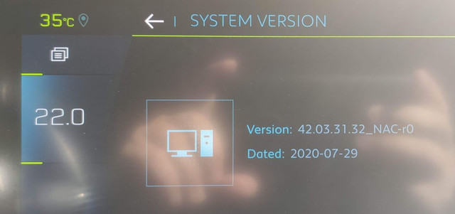

denis1304
- Posts: 10
- Joined: 10 Feb 2023, 10:49
Re: PSA NAC RCC Updates
Hello
I have 42.03.31.32_NAC-r0 on my Peugeot 508 hybrid, from 2022.
Is there any meaningful difference between 42.03.31.32_NAC-r0 and 44.06.44.22_NAC-r0 or 44.07.33.32_NAC-r0? Currently everything works OK.
The MyPeugeot app is telling me I can update FW to the 44.06.44.22_NAC-r0 version and maps to the 20.0.0-r0 version.
Can I just update maps I'm interested in without updating the FW to 44.06.44.22_NAC-r0 or 44.07.33.32_NAC-r0?
How long does it take to update FW and a map for one country?
Thanks
Thanks
Onlinerui_saraiva
- Posts: 135
- Joined: 15 Feb 2023, 10:31
- x 63
This is what I see. Because I'm not forum staff, I can't read the VIN.MDRAGOGIAS wrote: 30 Jul 2026, 07:12good morning i have 42.01.72.32_NAC-r0 end my vin is VR7**************[VIN obfuscated, can be read by forum staff]**************[VIN obfuscated, can be read by forum staff]**************[VIN obfuscated, can be read by forum staff]rui_saraiva wrote: 28 Jul 2026, 12:17 @MDRAGOGIAS: I can't read the VIN. You need to write your actual firmware version, "first software version" isn't enough to identify it.
Input your VIN in my page, if it is identified as a NAC_EUR_WAVE3 you can't upgrade the firmware, but you can install the maps for the NAC_EUR_WAVE4.
If it is identified as a NAC_EUR_WAVE4, you can upgrade the firmware to the 44.07.33.32_NAC-r0 version, but you need to use the link on my page.
You can't use the Citroën/DS/Opel/Peugeot/Vauxhall Update in any of those cases.
You can only use the official software to update the maps if your system is identified as a NAC_EUR_WAVE4.
