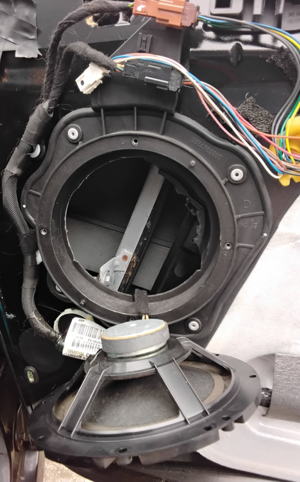

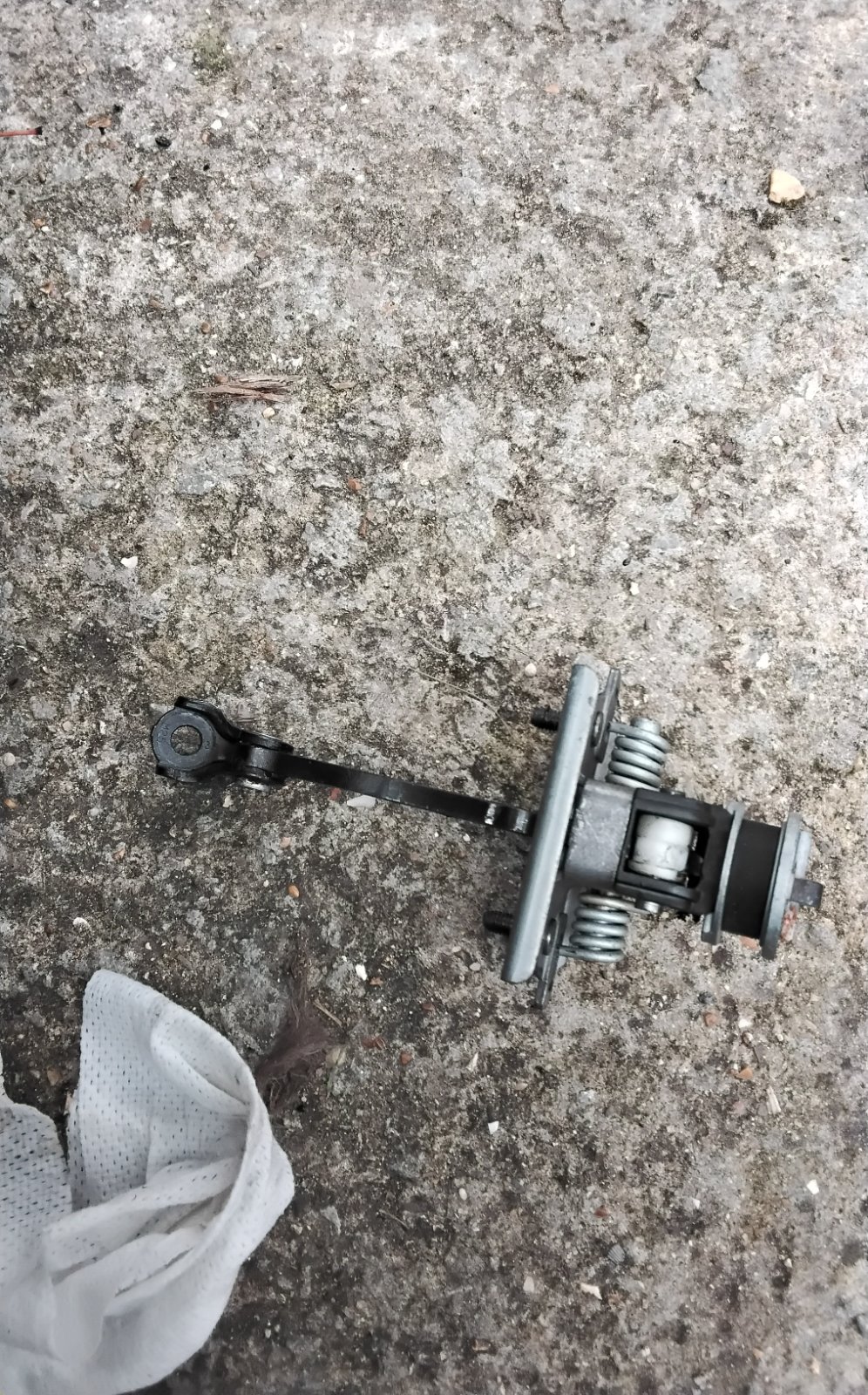

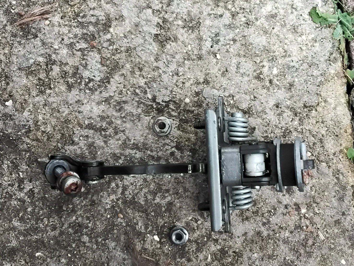

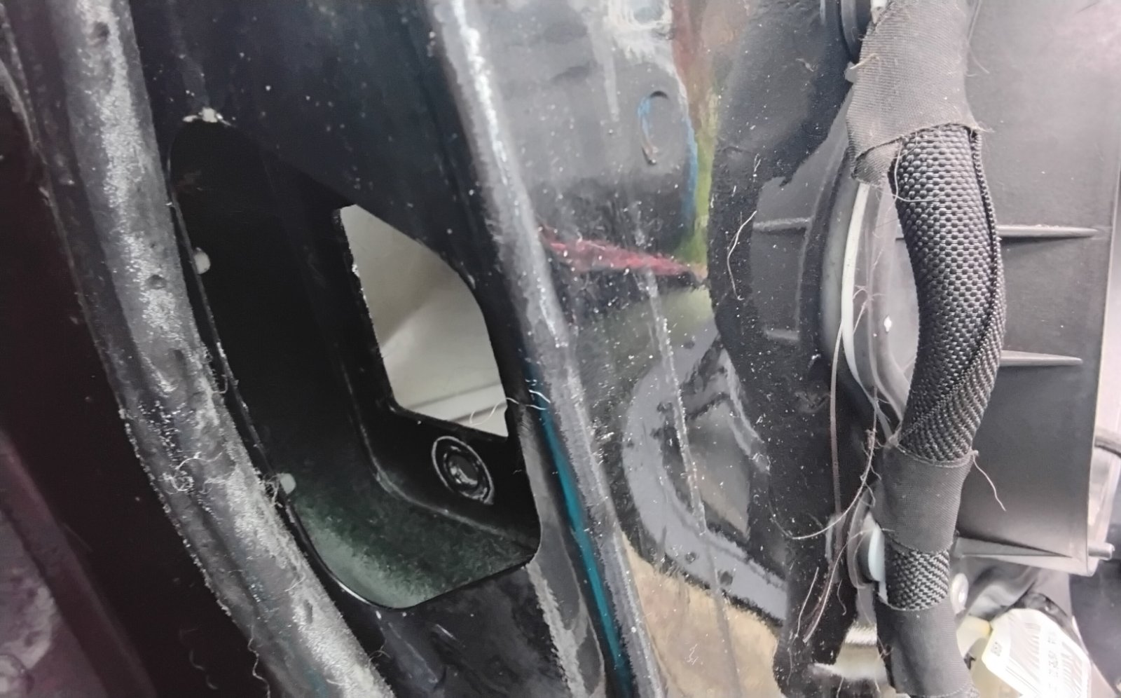

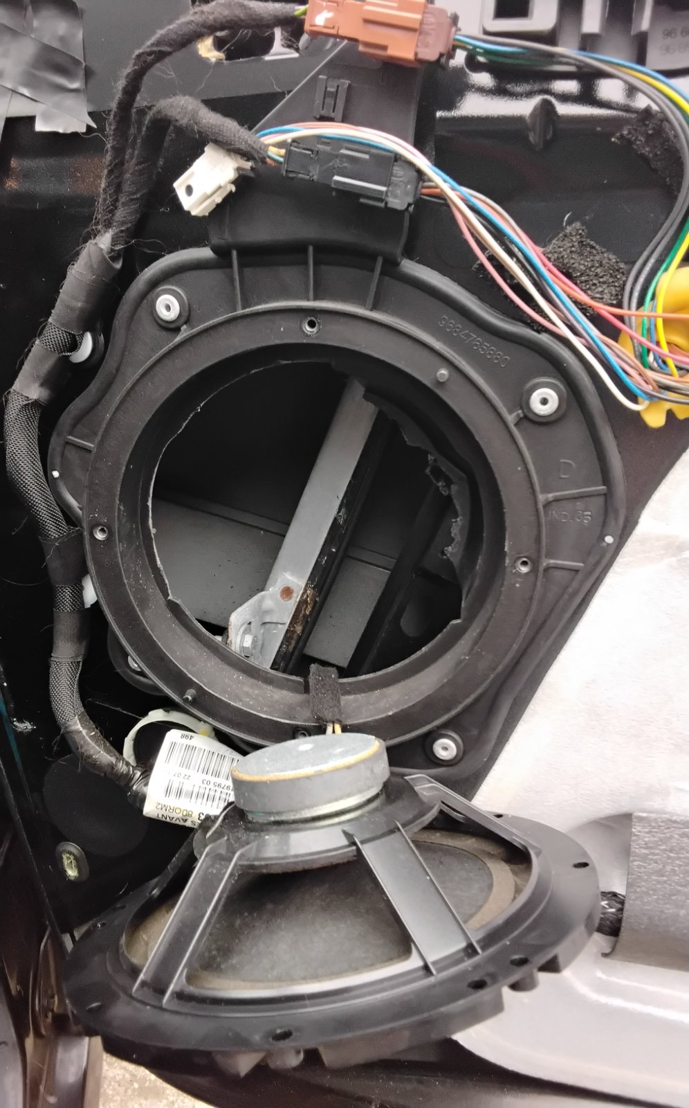

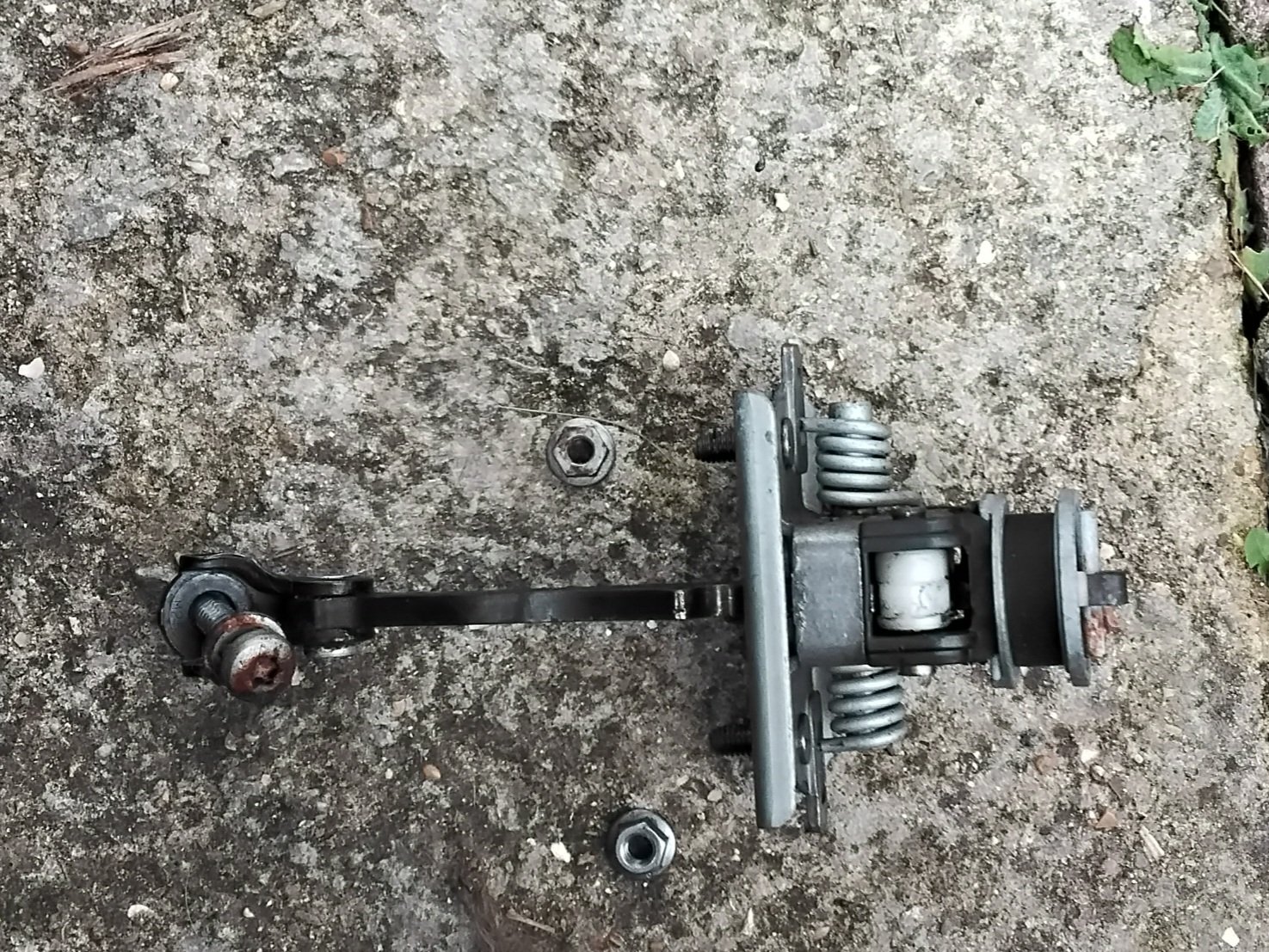

So, the door strap was really making a noise so its been removed & a new one has been ordered, door card off, speak out then hole to get your hand in to reach the strap , a hex bolt on the door post & 2 10mm nuts holding the strap to, bolt off nuts off too then remove via speaker hole, refit reverse of removal , theres a video on here of how to remove door card , i dont own the video its posted as educational use. Photos not in order but im sure they can tell the story.

Nylon roller on these parts wear out , then that horrible clonk knock noise when you open n close the door

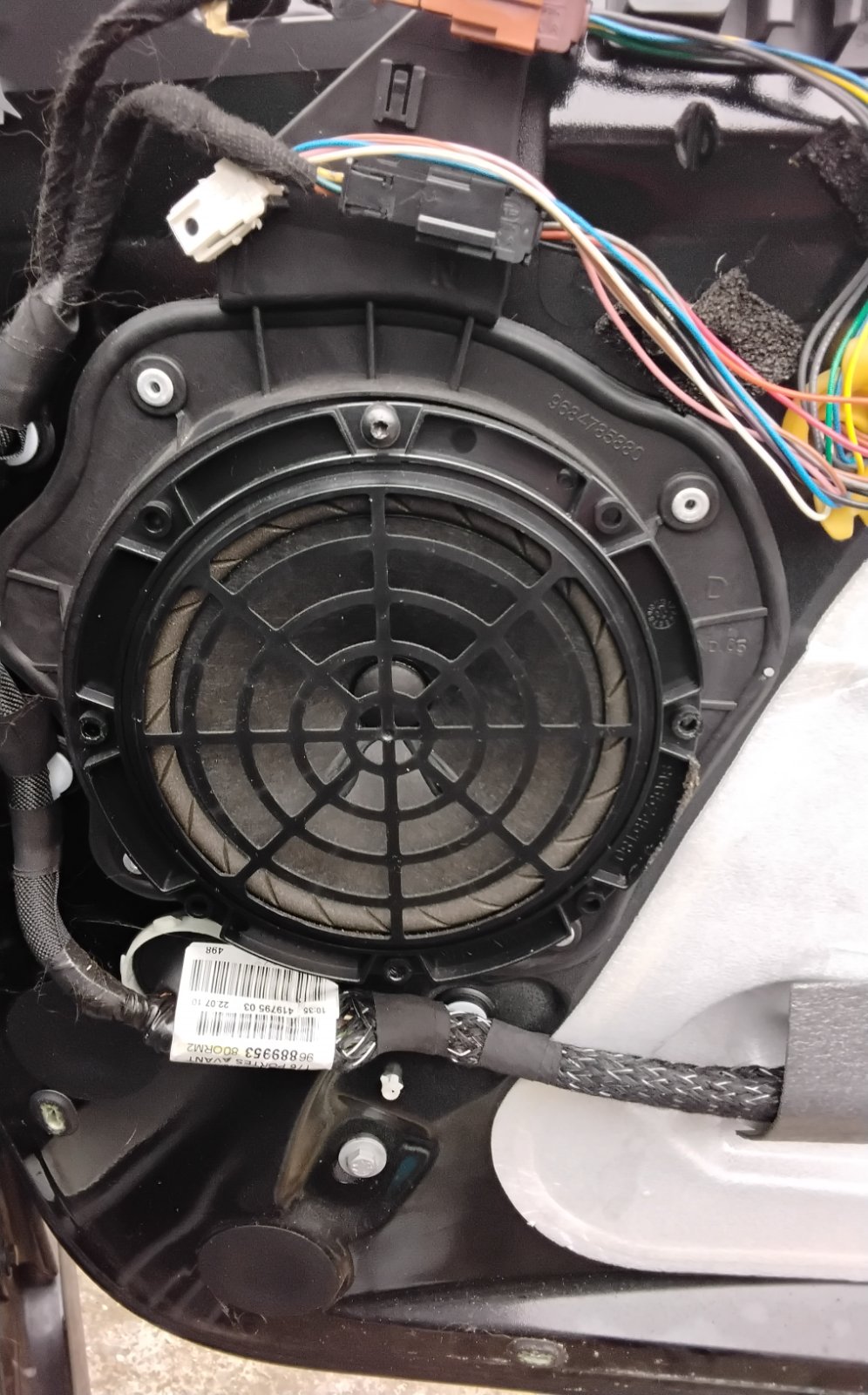

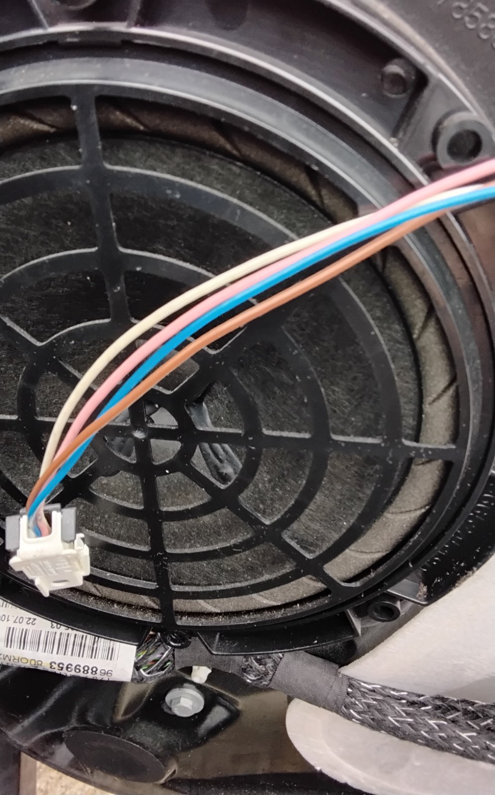

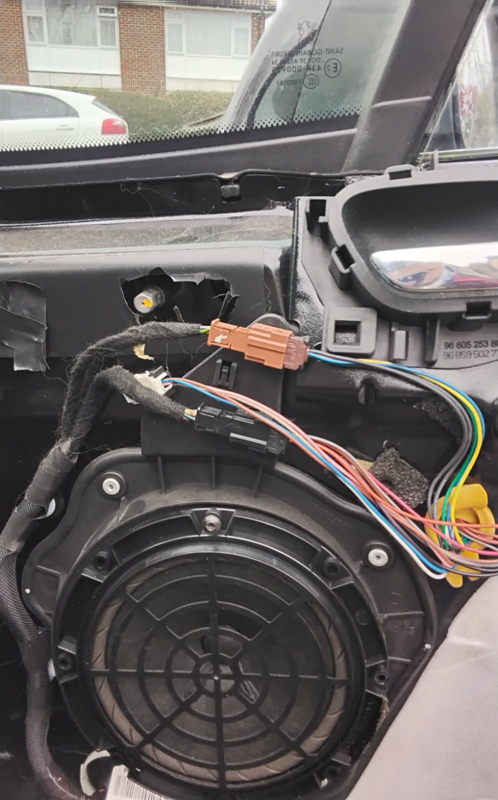

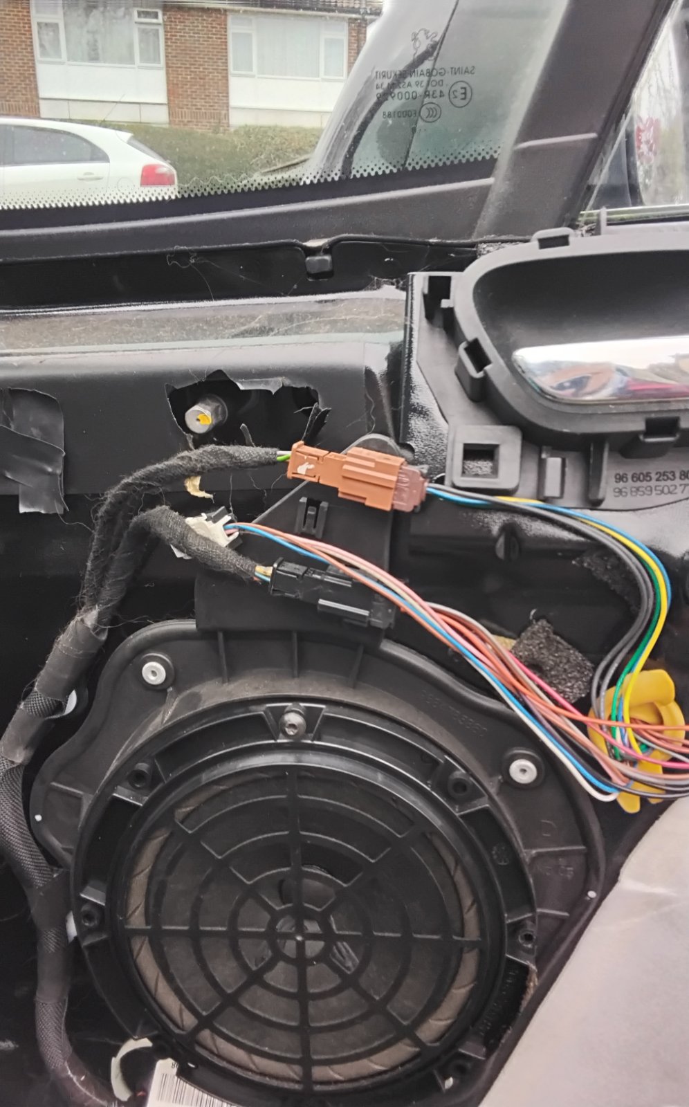

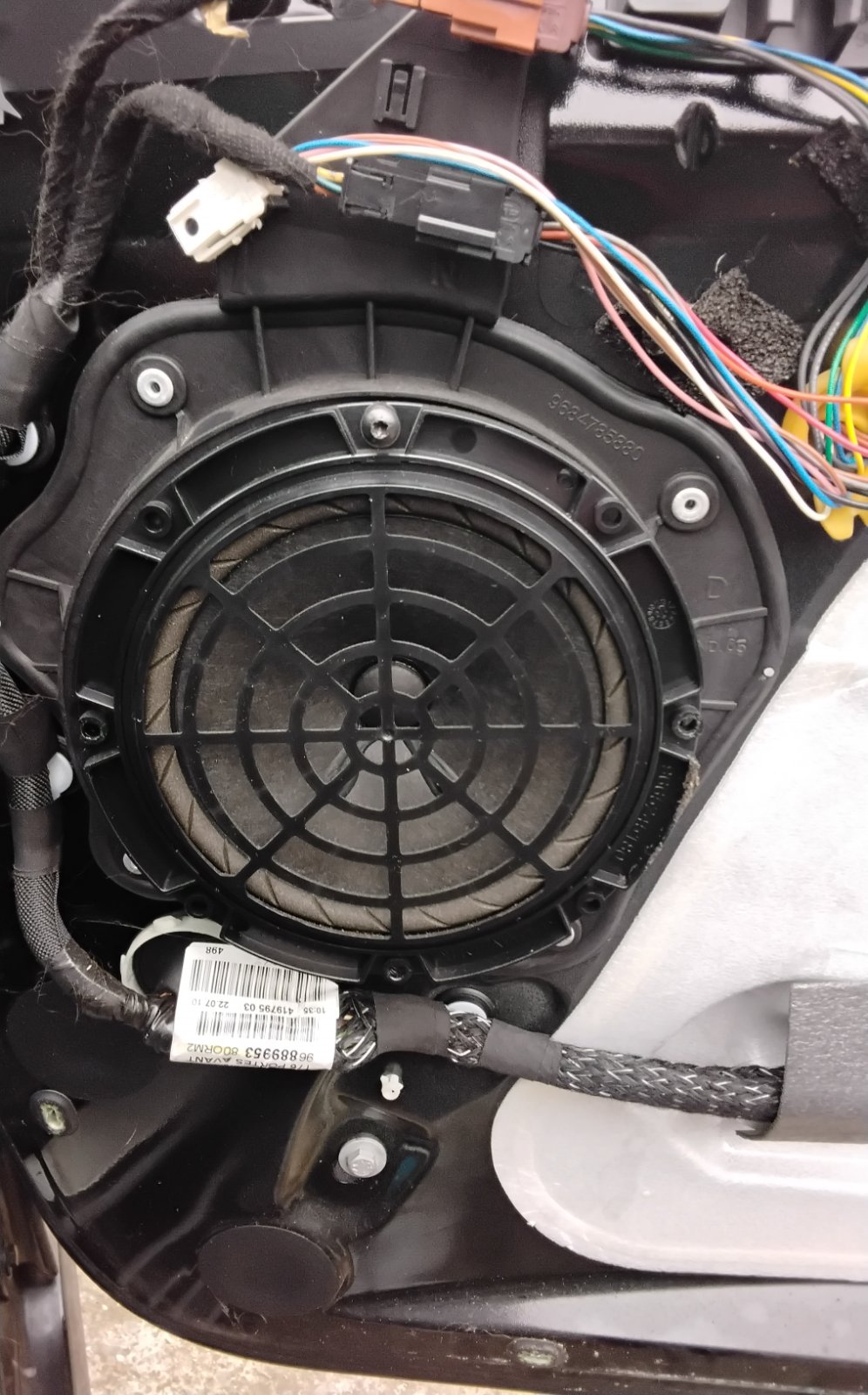

When i took the door car off i noticed this spare loom
Any idea what it is for ? Door mirror is all plugged in so is the speaker .
I assume my door mirrors have the deicing feature which i think they do as i recall the mirrors deicing last winter when the demist feature was used . So any body know ? Maybe it could be used to power something else ?

Door strap replaced with a DS4 strap
Which is a perfect upgrade can be found here. https://www.ebay.co.uk/itm/133163362405 ... media=COPY

Maybe it is something to do with the optional CD changer? Some wire codes and plug description would help identify it.

@ Huskyxantia "Door strap replaced with a DS4 strap
Which is a perfect upgrade can be found here. https://www.ebay.co.uk/itm/133163362405 ... media=COPY"
And you fitted this DS4 strap to your 308CC?
fits and works Ok?
Reason I ask I changed the wife's driver door strap and now the passenger is clonking when you open, I did the same on my Megane CC the 1st time I bought a Coupe check strap it looked the same from the image, the guy on Ebay said it is the same, same size door, but when it ws fitted it didn't fit as the CC had a slight bend in the rod were as Coupe was straight, so I would be interested to know if this DS4 strap fitted your 308CC and works ok as they are hefty doors, I think I paid in the region of £35 for her 308cc strap, so a tenner is a bargain if it works ok.
fits and works Ok?
