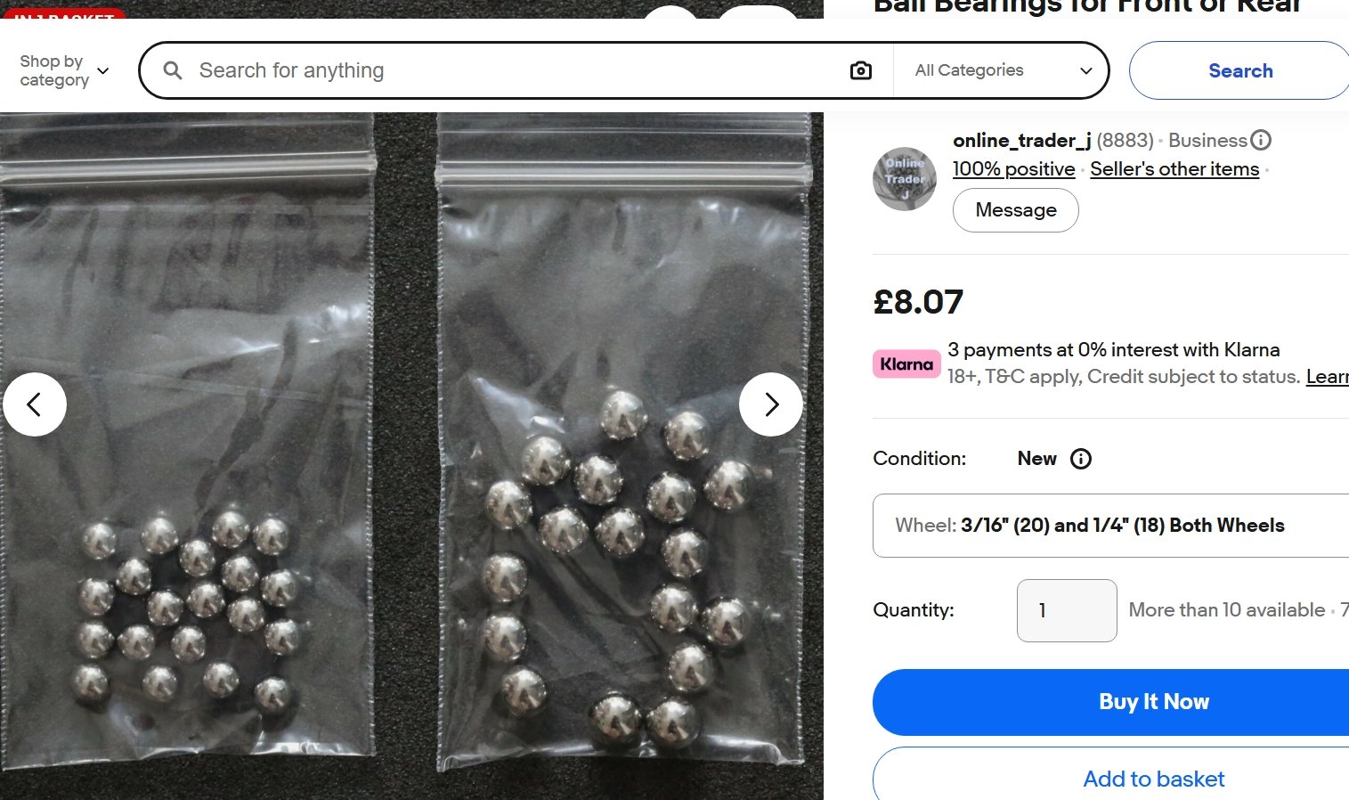

I myself have been paddling around the world of bicycle mechanics and hub bearings in particular.
Our youngest has acquired a NSCYCLES "Movement" what I think is a "Dirt Jumper Bike" from his Uncle. No faffing with Derailleur Gears...No gears.
The rear wheel has a wobble, which I interpret as worn hub bearings.
From a small amount of research, and probably a smidgen of AI of dubious accuracy, my conclusion is that it probably has "cone" type bearings. for which a dismantling, throw away the old ball bearings, a bit of grease and some new ball bearings of 1/4" or 3/16" in a little packet should result in a more stable rear wheel.
Don't think I have been that impressed with some recent dalliance into "Bike Shop" maintenance, or its pricing so on the verge of DIY, should have the transferrable skills from many years of car fixing. Thing is I have had my roadbike for over 40 years and it has never gone anywhere near a "bike shop" tyres/brakes DIY, but mechanically as good as the day I bought it!

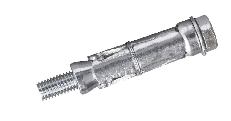

I have also watched videos on the Cartridge type bearings, which may not apply in this case. Yes I saw the array of expensive professional tools, and some cheaper but still too expensive this largely one-off job in my view. I don t think it has the cartridge type bearings but if it does, how about a cheap rawl bolt for removing "blind cartridge type cycle hub" bearings , if you can't easily get behind them due to the "compression tube" to whack them with more rudimentary hammer and drift!

My bike has cartridge wheel and freehub bearings Neil and they need replacing...
That Rawlbolt may just do the trick

I used to use those Rawl bolts to bolt a diamond drilling rig to the wall, roughly 45kgs of horizontal load on it. Then add in the force of me turning a handle to drill into the structure and drill through concrete and steel. Then add the weight of the resulting core at 900mm diameter and 400mm thick. Those Rawl bolts can hold alot of weight when installed correctly and reusable.
