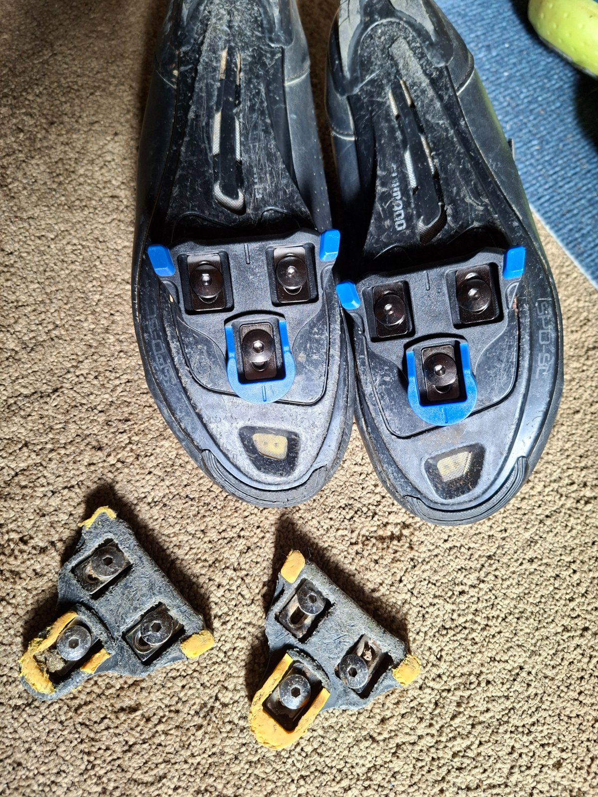

New cleats fitted to my cycling shoes...
That job was well overdue... I think I may have got maximum value from the old ones

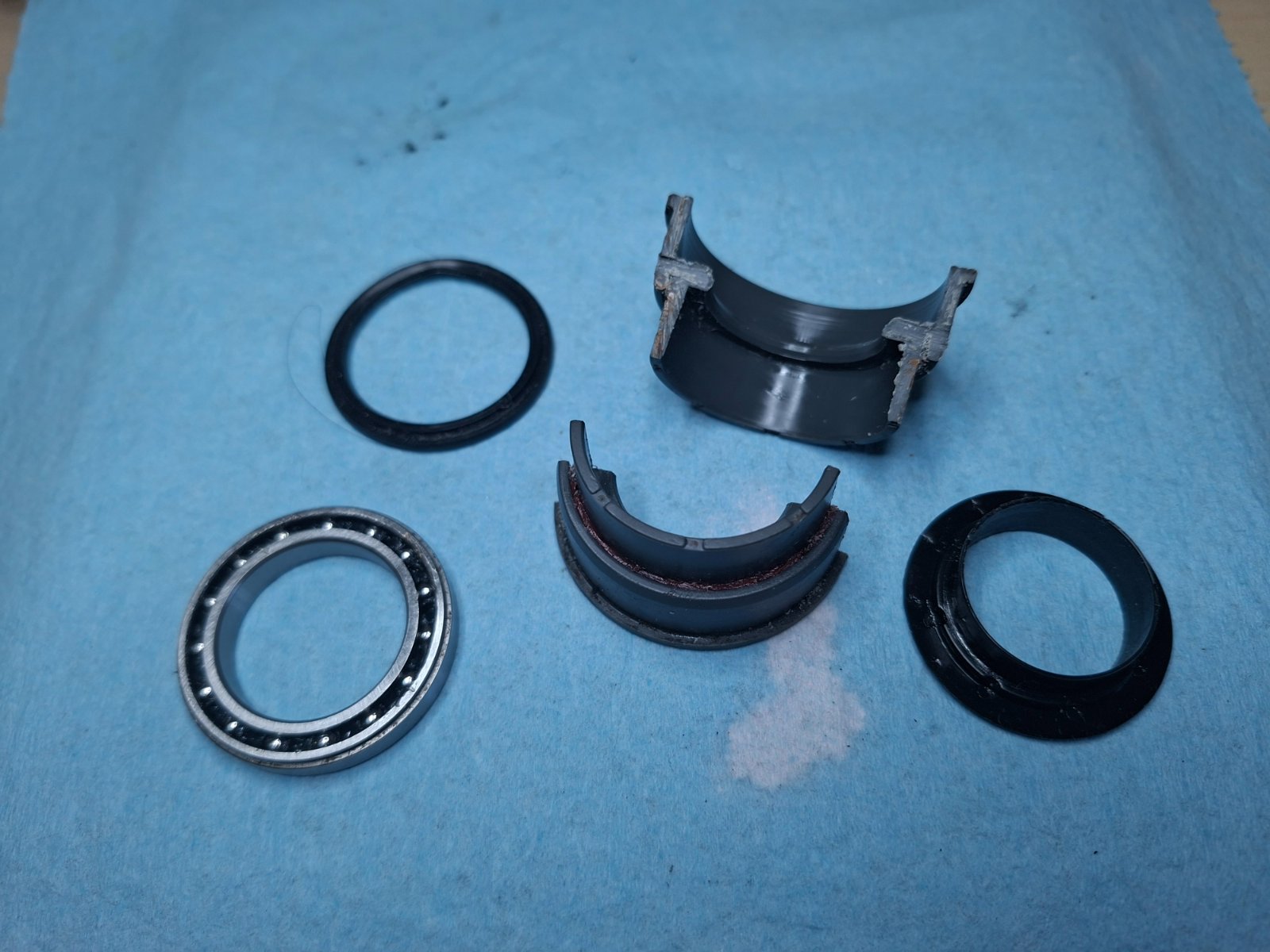

Yesterday I had new bottom bracket bearings fitted to my Propel...
On this particular carbon framed bike, it's a job that needs a few special tools that I don't have. Fortunately a friend of mine does
Although now I've seen them, I could easily fabricate them...
I cold not resist dissecting one of the old bearing assemblies...
In doing so I discovered the actual bearing bit is a standard ballrace that can be quite easily replaced with nothing more than a small blind bearing puller. And for a lot less money than the Shimano assembly...
The bearings are very heavily loaded and suffer failure from galling. They manifest failure by making a ticking noise under heavy load such as when standing on the pedals going up a steep hill or going for a sprint finish...
An interesting morning
