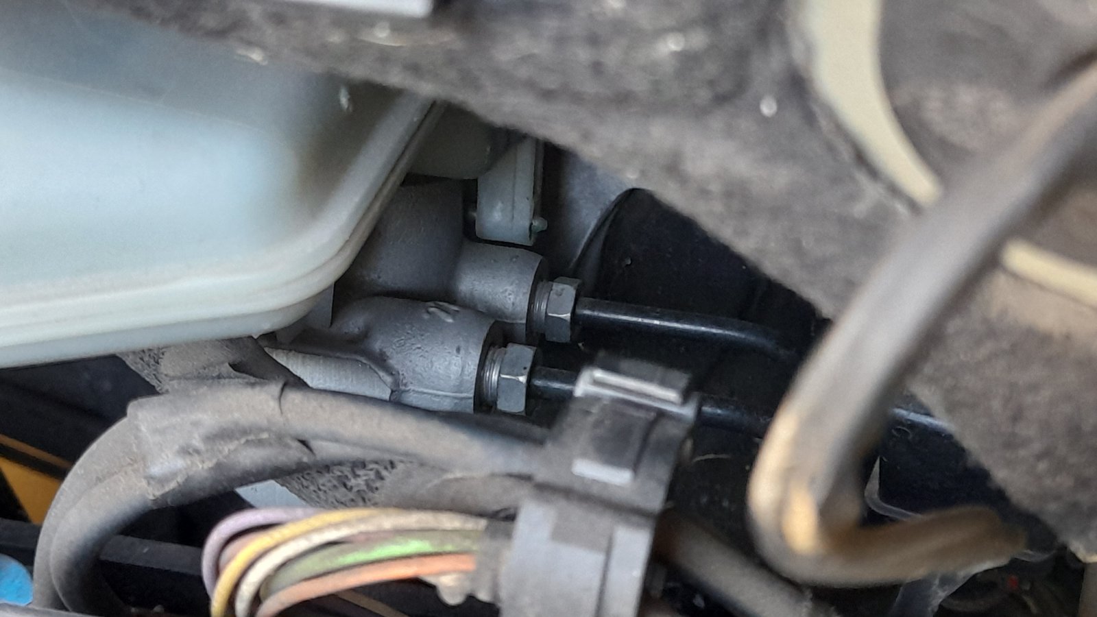

In the meantime I took an awkward photo that I think reveals it's identity.

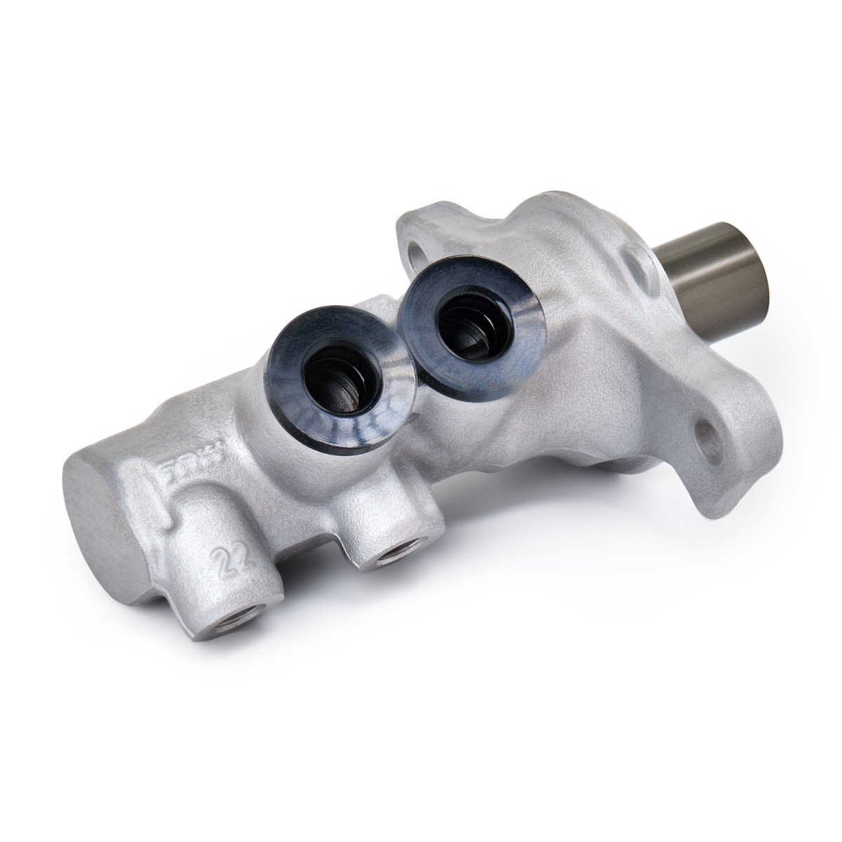

The cast '22' is visible in the attached photo and notice the stumpy, short look. The first reservoir column is just in front of the 2nd brake line.
I suspect it is TRW PMH900 (4601 R6), which matches the photos here https://www.autodoc.co.uk/trw/2209031#b ... r-cylinder
I was able to feel and see the tiny TRW casting to the left of '22'.
as opposed to TRW PMH940 (4601 R0) here https://www.autodoc.co.uk/trw/2209046
Notice those rounded brake nuts....someone didn't use a brake spanner!
