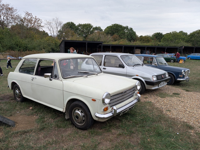

Some photos from Sunday. May be some more to follow as I took quite a few on film.
Aside from the extra 300cc and being a year newer (and the colour of course) this is pretty much identical to my last one. It surprised me how many little details changes there were between a W and a Y plate (indicator stalks, seatbelt buckles, rear washer jet location, and deletion of the fasten seatbelt light on the dash are what I've spotted) when actually looking at one. Wasn't a single one there on a W plate that I saw, X was the earliest.
Many Metros.
Not as good as XAN71A on a certain Xantia, it I thought this reg was a good effort.
This was a LOT of green...and I thoroughly approved of course given my penchant for brightly coloured cars, especially with its colour matched partner in the background - apparently one of only nine ever sold in that colour, which makes the fact that any survive kind of miraculous.
Definitely had some weather throughout the day, but the showers were pretty brief so it didn't really impact things much.
The owner of the Metro was also there in his Morris 1300, so as things thinned out at the end of the day we took the opportunity to get a photo of them together.
Then the owner of the Vanden Plas 1300 which has featured on this page a year or two back also showed up.
In general I usually don't rate single marque shows that much, but BMC covered such a diverse range of the market over so long that there's actually near as much variety as you'd see at any show. Plus it seems to always attract a good number of proper greasy rag cars and motors clearly in regular use as well as the usual the concourse show queens.

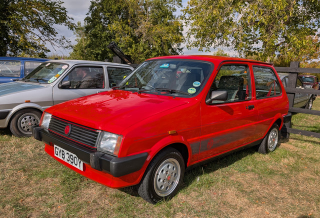

Metro has a little tinkering time going on.
First thing I want to deal with is one that anyone who's dealt with the A or A+ Series engines at all will be well familiar with - a blow from the manifold to downpipe joint. These use an honestly daft, fiddly, finicky and just utterly hateful band clamp to hold the downpipes to the manifold. Trying to get these properly lined up and fully sealed is a recipe for frustration (and in my experience, repetition). It was quiet when I picked the car up, and clearly started blowing after about 15 minutes of driving. The head was off about a year ago, so guessing things weren't perfectly lined up back then. Going to see if I can get it to seal a bit better as it's horribly annoying.
The choke light on the dash wasn't working. This one was nice and simple in a dirty switch.
That's the sort of silly thing that will drive me mad. Especially when it's a nice neat and clear panel like this.
I need to have a poke around the engine bay as I'm not convinced there's not a vacuum leak somewhere. Something seems to be whistling, and it's on the wrong side of the engine bay to be from the belts. Hoping it's not the brake servo as it's never fun having to be the bearer of bad news!
The carb I think needs the base mixture tweaked slightly, though I'm not touching that until I've finished hunting vacuum leaks. The carb was apart not long ago to change the bowl gasket, so things might have been moved then. We also could just be dealing with stale fuel as the car is used so rarely - pretty sure what's in there is what I put in there last time I was driving it, and that was in 2022 I think! So I'm going to try to get it down a bit then stick some fresh stuff in to see if that changes anything.

Last time I owned a Metro and therefore spent any regular time tinkering with one was 21 years ago.
One thing I despised ever having to touch back then was the stupid band clamp between the exhaust manifold and downpipes. They're an absolute git to get properly lined up and fastened together, and everything has to be done blind because the fluffing manifold is buried down the back of the engine.
A good bead of sealant in the groove of the clamp and some patience will usually get it sealed. Though I do remember it being something that had to be revisited now and then.
One or both of the clamps on here started blowing shortly after we got the car out of storage. Being an optimist I attacked the outboard one first as it's immeasurably easier to get at. Of course that's not the one that was blowing, no it's the inboard one that's a swine to get at.
Coming back to that. I'm pretty sure given where the clamp is that it was fitted from under the car just to make it more awkward. On the plus side, I know one branch is sealed now!
The choke light remained functional for precisely one cold start. About situation normal for BL electrics then. I'll try to get in there with a points file to see if I can clean the contacts a bit better. The switch really isn't designed to come apart so I'm not getting too involved there.
Some fresh fuel has definitely helped with general running, though still a bit lumpier than it really should be.
Noticed another very early car difference - the scale on the temperature and fuel gauges is labelled differently. Older car had a solid white bar in the operating range in the temp gauge and didn't have the 1/4 and 3/4 markers on the fuel gauge.
Pointless knowledge, but the sort of nonsense I find interesting.

That ADO16 looks lovely Zel and I'm especially liking it because it's a 2-door
An early MKII too!
Zelandeth
- Posts: 5328
- Joined: 16 Nov 2014, 23:36
- x 1607
Re: Zel's Fleet Blog - BX, Jag XJ-S, Sinclair C5, Mercedes 208D & 230TE, AC Model 70.
I figured it must be quite rare being a two door. Unlike the Metro this one is quite a tired car, but it generally seems solid enough. It of course decided to start running horribly on arrival, despite having been behaving perfectly for the owner for months aside from a failed battery earth strap a few weeks ago. It feels like fuelling, so first thing I'm going to do is look at the ignition given that 90% of carburettor problems are actually ignition problems (and 90% of ignition problems are fuelling issues). Could just be crud on the points. At the end of the day, it's an A series, there's not much to it!
Despite the horrible misfire under load it's developed, a clutch release bearing that sounds more cranky than I do before the first coffee in the morning, it still is a very likable thing. Feels a much more honest car than the VDP variant, and I think that suits it better.
Still think the biggest immediate surprise for anyone who's not been in one of these cars though would be just how comfortable they are. That's before you even get to how well the suspension irons out imperfections in the road surface which knock the fillings out of my teeth in the Volvo. I always forget how well the Hydrolastic system worked when I've not driven a car with it for a while. Definitely more suited to the state of roads these days than anything made in the last twenty years I reckon!
I will say though that they do feature possibly the most immediately noticeably offset driving position I think I've ever come across in a passenger car.
Of course it wouldn't be a visiting car here without a dash at night photo.
They've done the same clever thing as on the centre control panel in the facelifted P6 by edge lighting the plastic of the panel to get an extremely even light over the whole thing for the time, when a lot of cars had very rudimentary panel illumination still. Good example of a design that tells you everything you need at a glance and nothing you don't. Only gripe is the common for the period totally unlabelled warning lights aside from those for the indicators. Red one, two orange ones and a blue one. You're left to yourself to work out what they're telling you.
