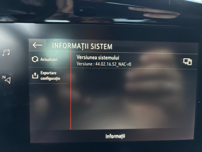

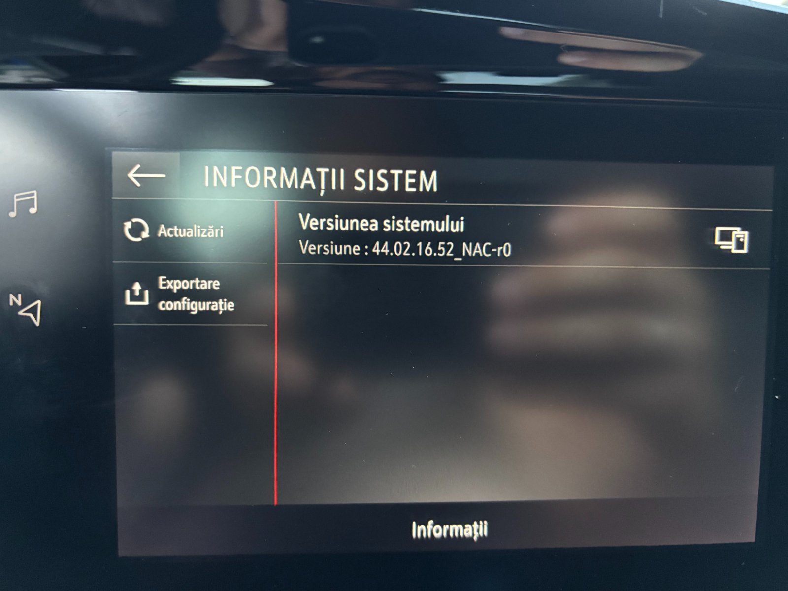

Hello,
This is my current system version, I wanted to use E-routes that my car it have built in, but somehow is requesting to have an update in order to work
My current version is 44.02.16.52_NAC-r0, i want to update to the latest one but I could not do it by MyOpel app, I also read the other forum, but its hard to see a stept by step instructions there.
I have done the checking with my VIN and downloaded the file and extracted to my USB flash drive with 32 gb in fat32.
What should I do next?
After this I will update also the MAPS as well.
Thank you in Advance!
