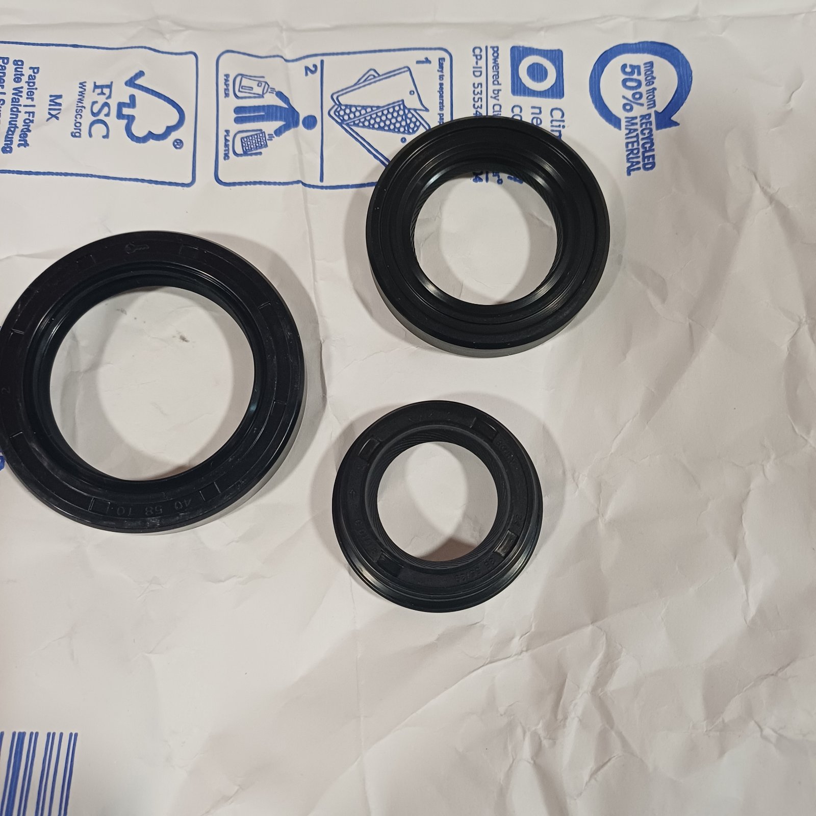

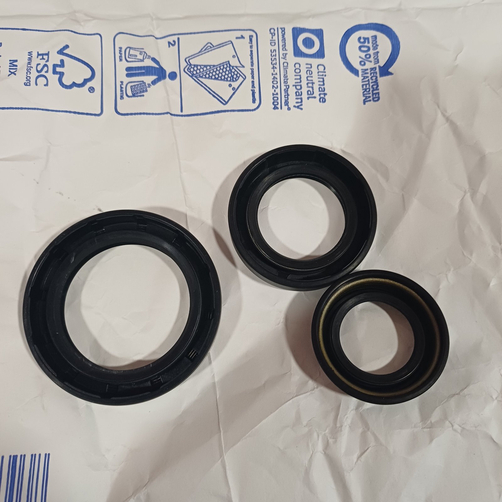

Arrived home earlier today and the seals have arrived, nice , pity now though ive not good light to do the job plus its drizzling aswell . There's always the weekend.
Nice new seals
Nice new seals

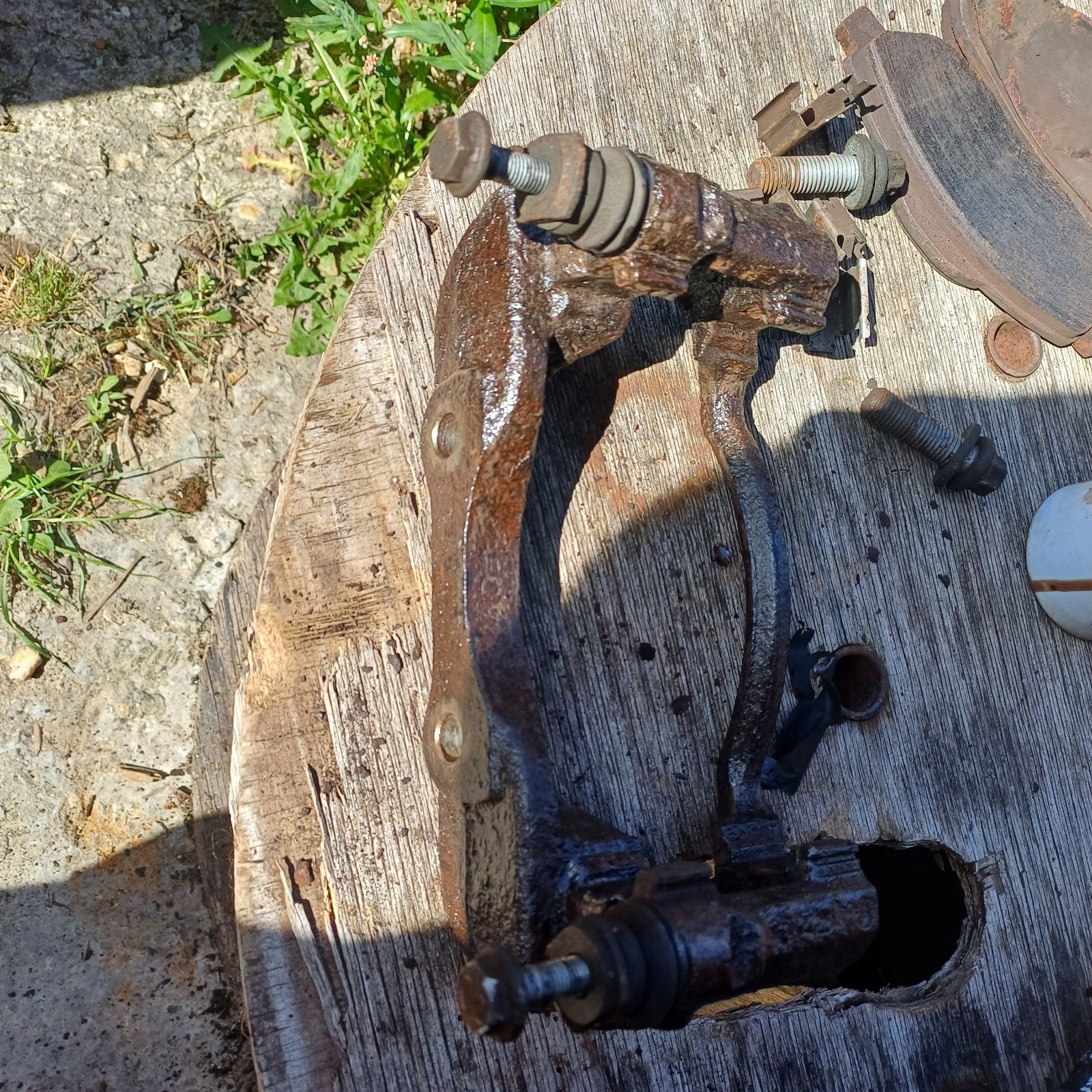

These are crusty so they got a wire wheel treatment with the cordless drill then rust proofed afterward driver side is all done .
Cleaned the caliper housing and rust treated
