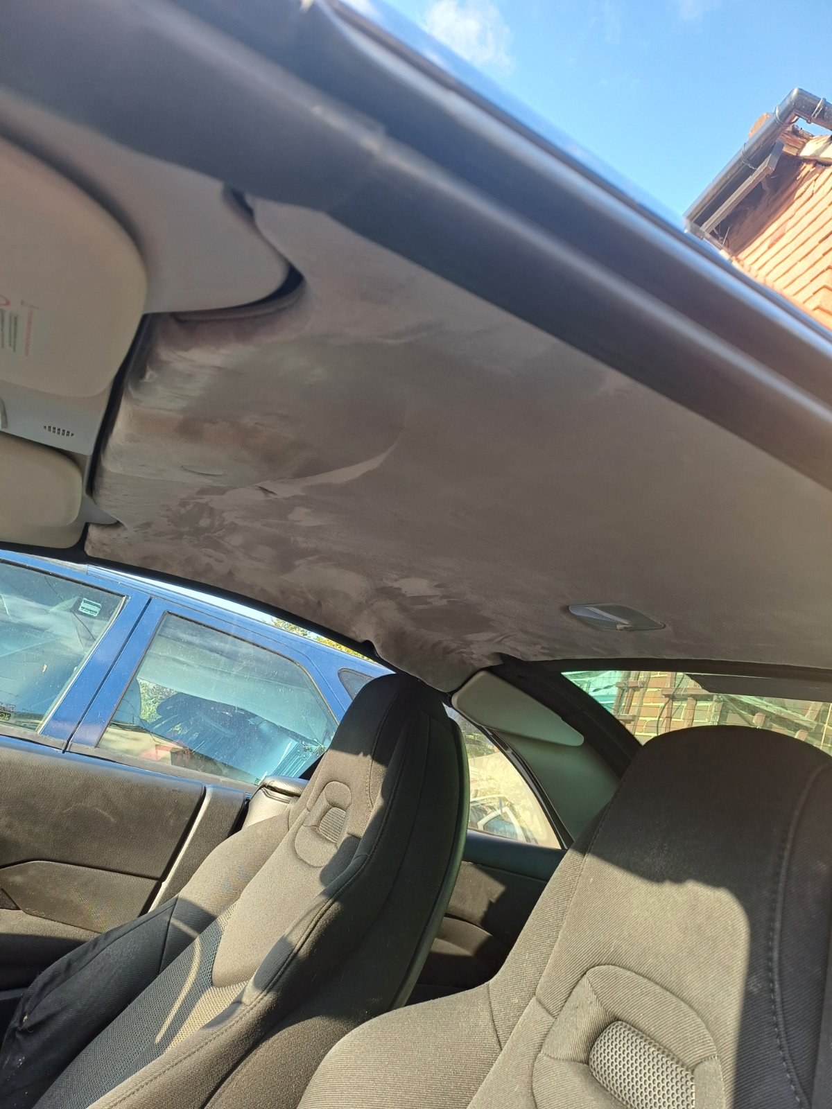

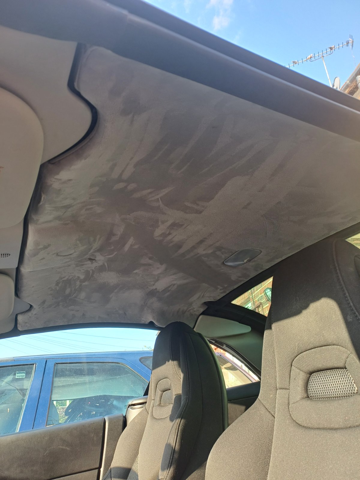

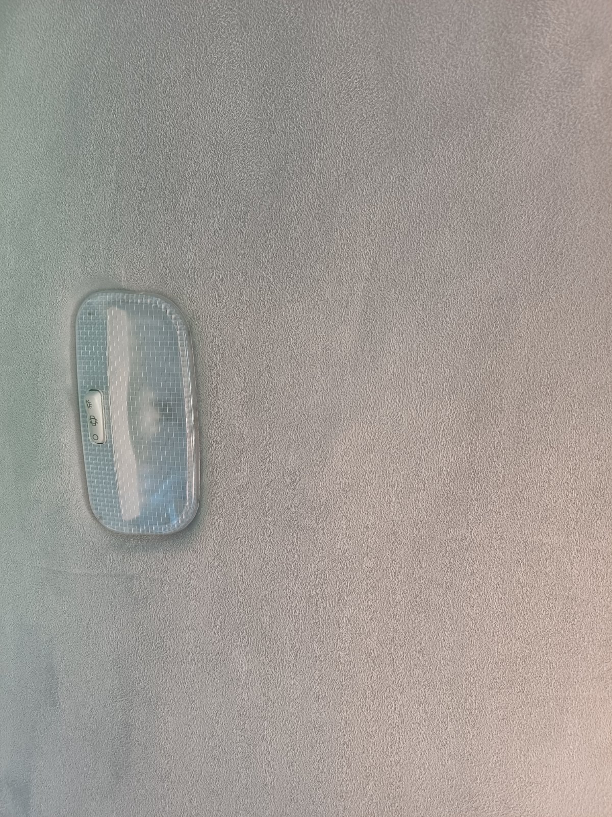

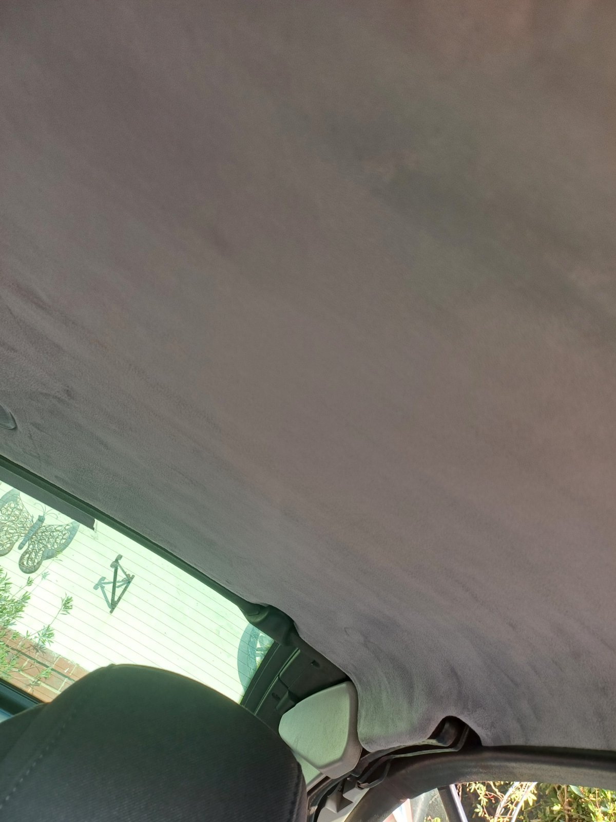

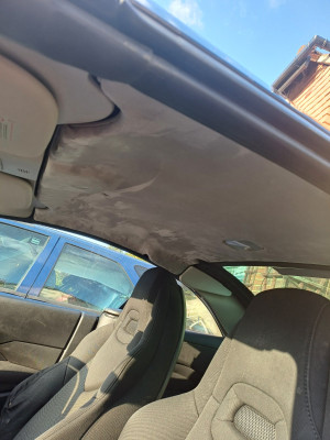

Ok so think i mentioned I was having problems getting the roof to behave so today was the day I had been waiting for . I had to do the liner again the black liner was to thick..... 1.2mm to be exact.
Last week I did find a nice grey light velvet colour with foam backing and got another can of spray glue gunky messy stuff, so manual roof thing again then liner board out , new cloth on ... oh my it looks ok this one ... then fitted it all back manually closed the roof .... moment of truth button time and bingo roof opened , push again roof closed ... who would of though that the thickness of the liner would of cause so much bother .
Photos soon.

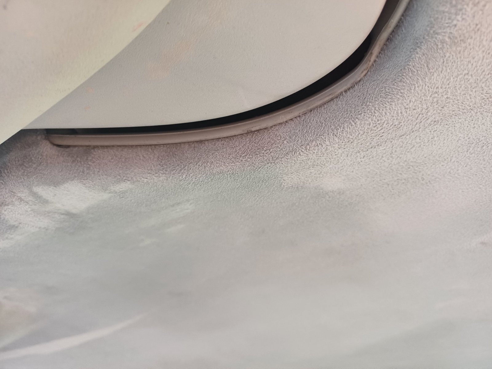

​"Haha, the battle with headliner tolerances is clearly timeless! Glad to report the thinner fabric did the trick—roof is opening and closing perfectly now with no binding."
Some photos of the new brushed velvet type of cloth , feels so nice its worth the touch to mess it's pile up lol

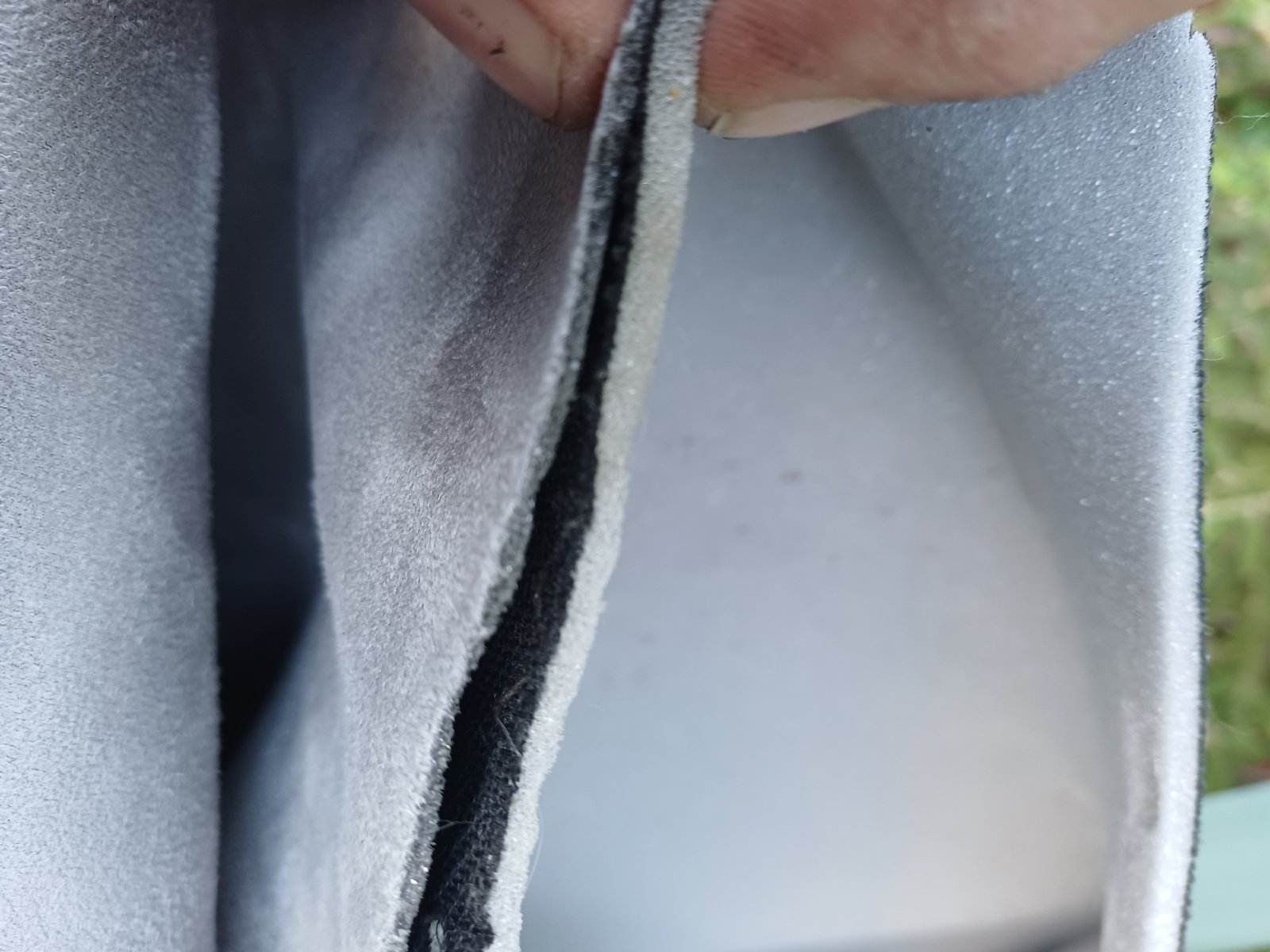

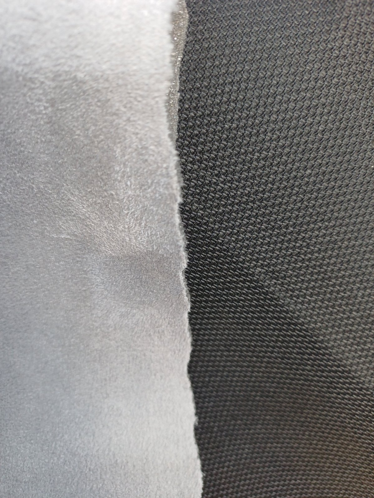

There we go, anyone wanting to under take this headliner replacement/renewal... don't go to thick.
1st attempt black 2nd is grey
Look at that thickness difference

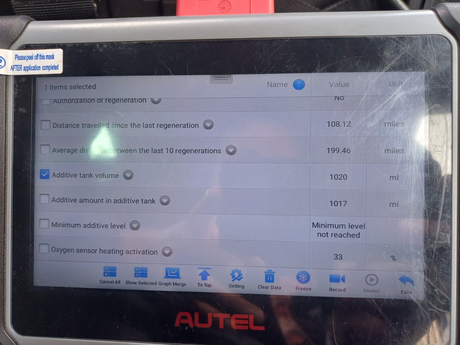

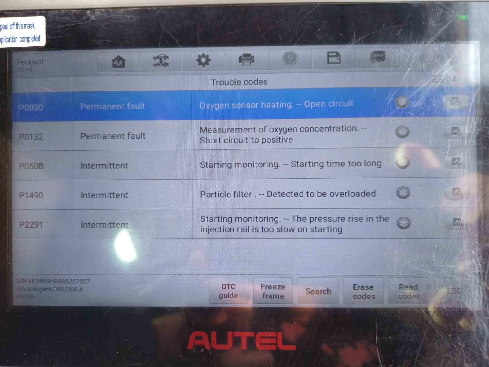

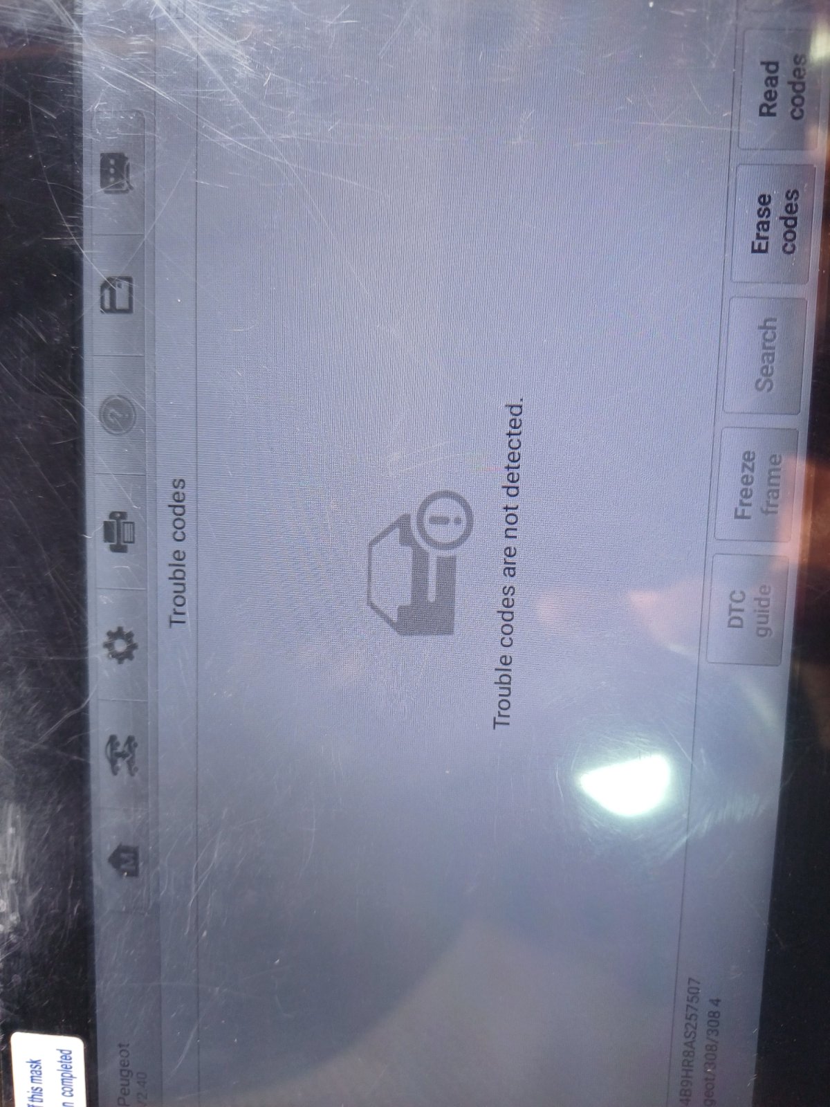

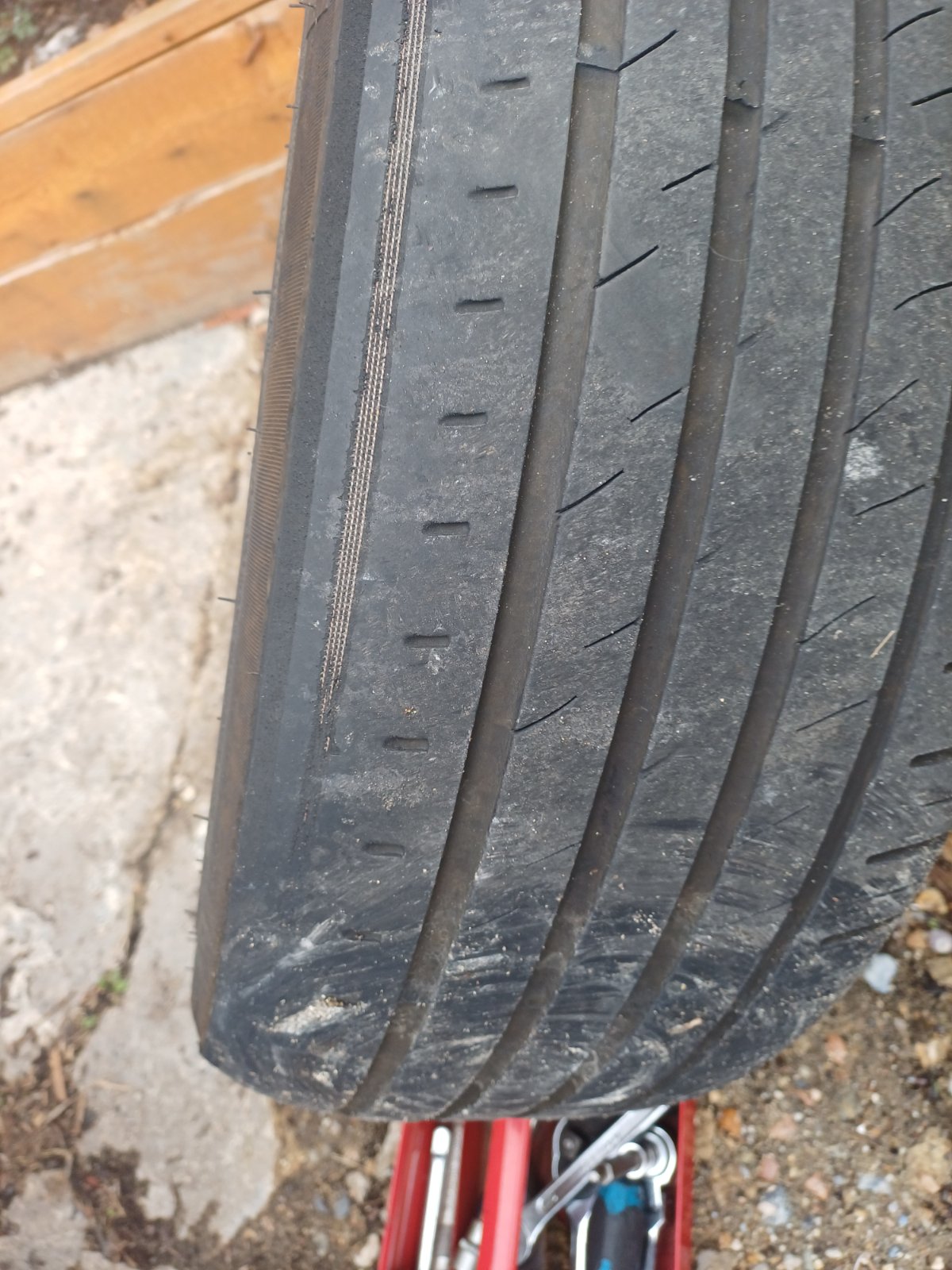

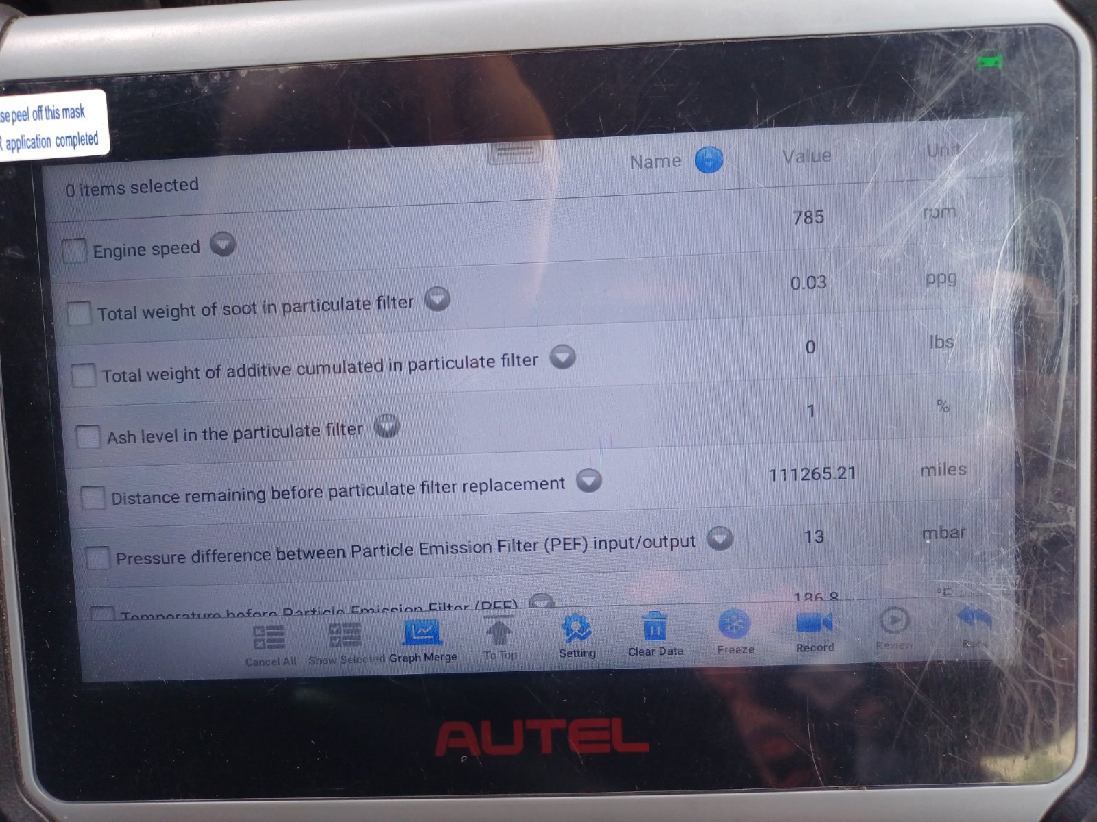

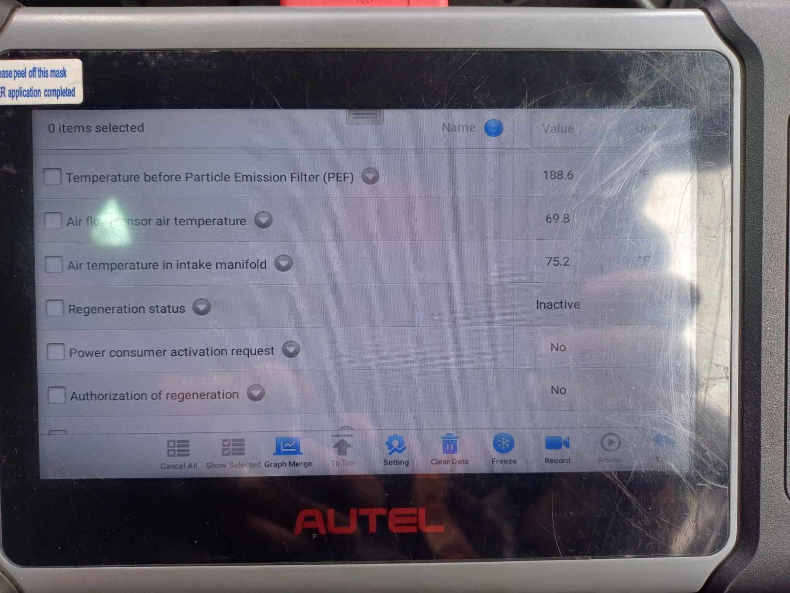

Running a session with my autel maxicom 808s
So my dpf according to the diagnostic machine isn't full, blocked or looking like it needs a regen..

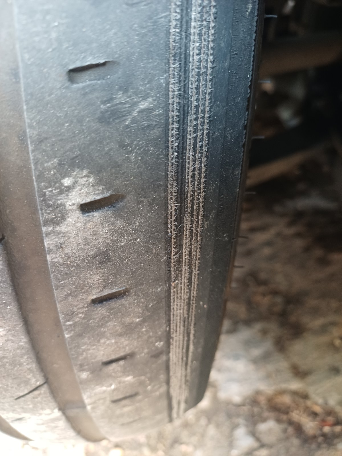

So this may well be a sensor that's dirty, packing up the ghost and throwing a tantrum when it feels like it , also while opening the car i noticed my front off side tyre..... see photos of my jabber jabber
What the .... this was all tracked in about a year ago .... kwik White... i mean fit
Silly little warning light....

So the saved faults are , then I wiped them , re scanned and its all clear ... ive got some thinking to do about this car.
Do I use it enough
Do u need to keep on top of more than one car especially when im not to good or other stuff happens.
Should I part ex this for something smaller
I Don't know......

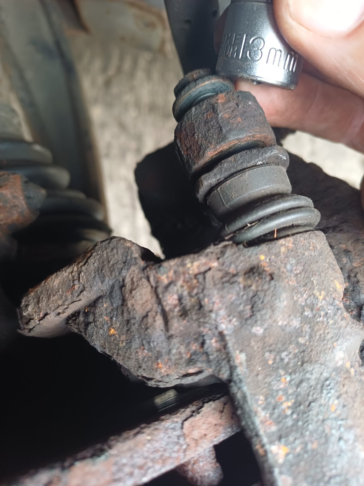

So ive still got the new o rings to fit on the leak off pipe clips , I did purchase a new inner and out steering tie rod set plus a lower ball joint aswell , for both sides. If I do part with the car these can go with it , im still doing the o rings.

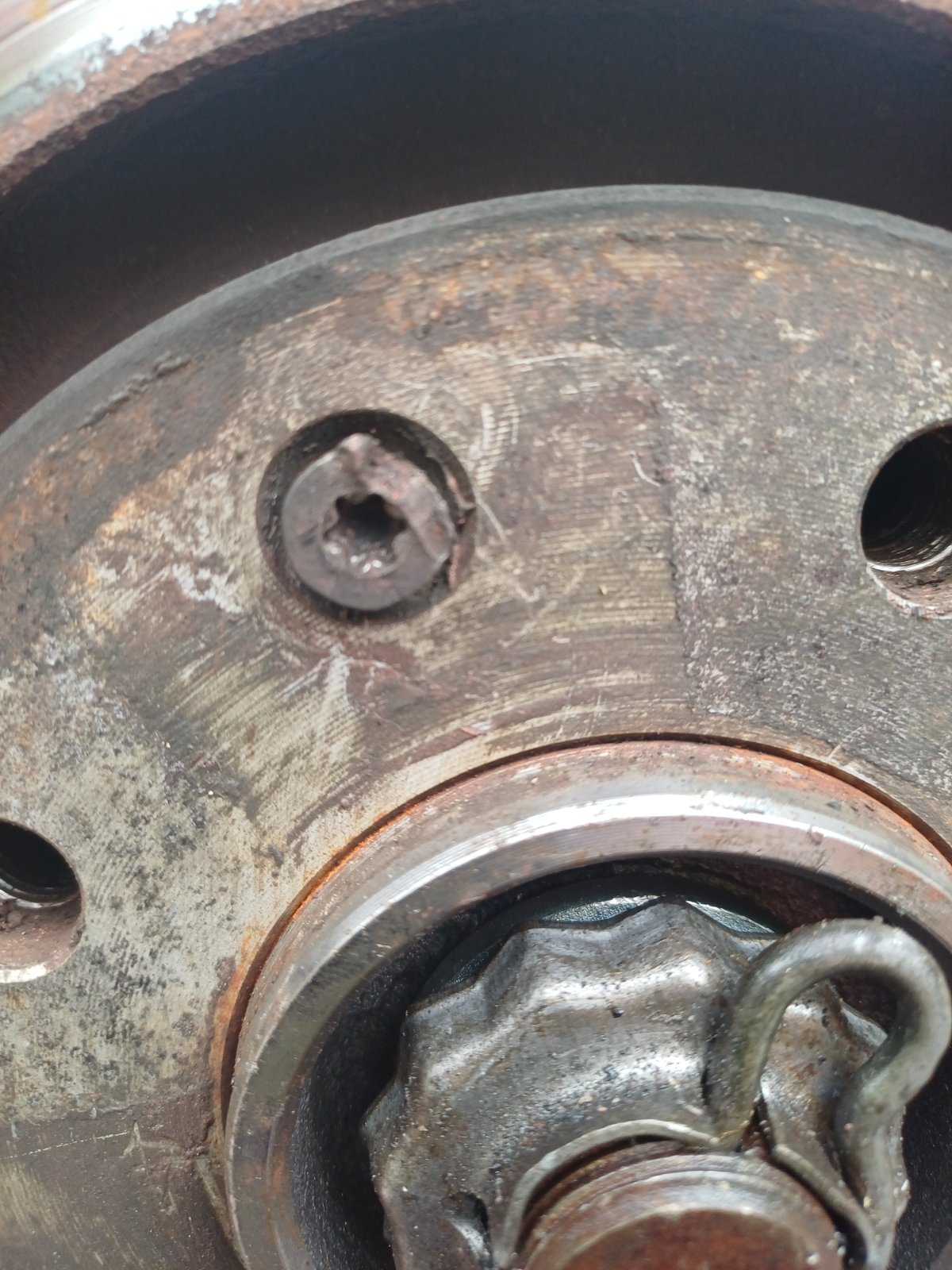

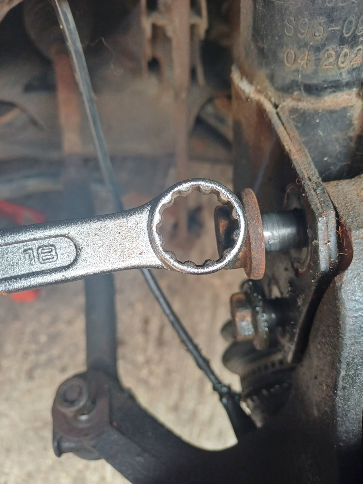

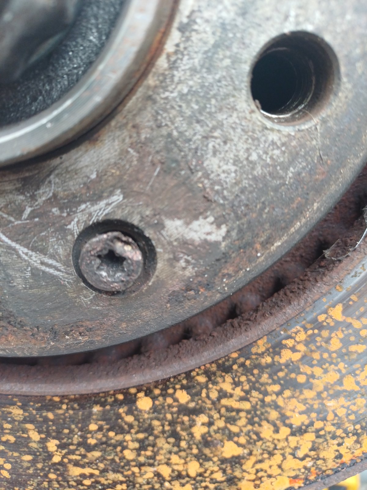

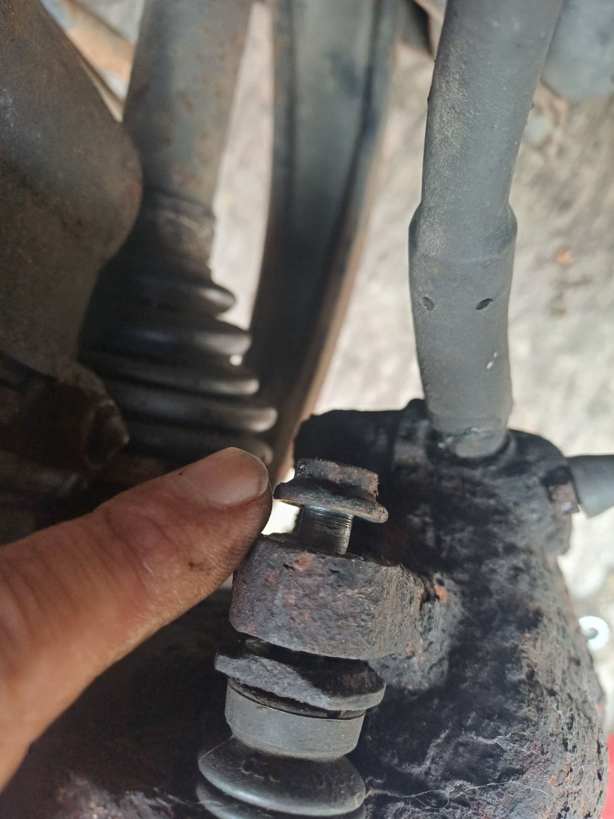

Anyone know what causes this time happen to these little disc screws

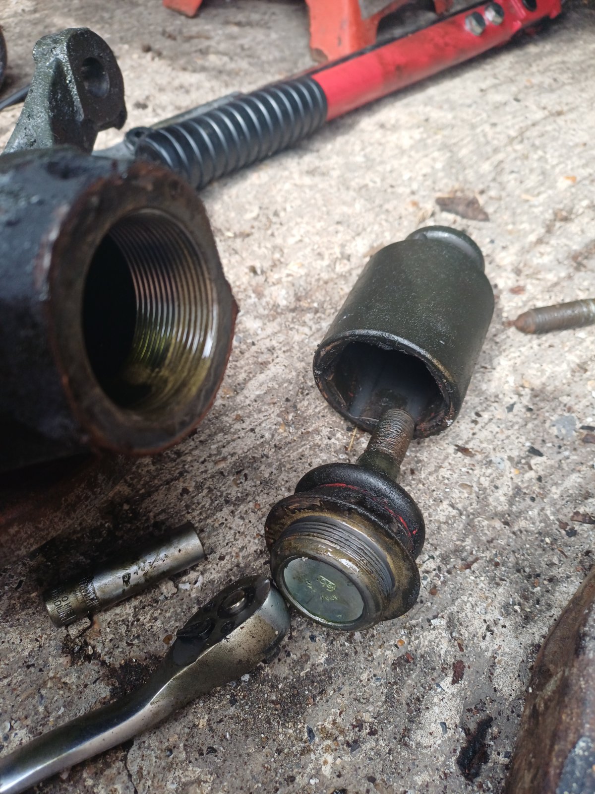

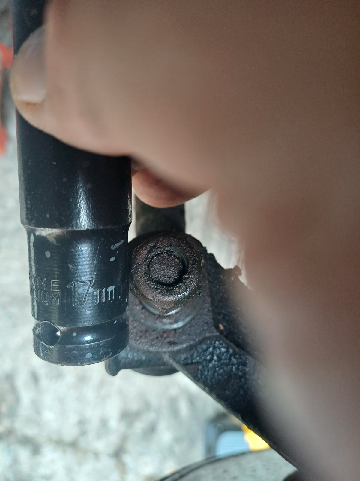

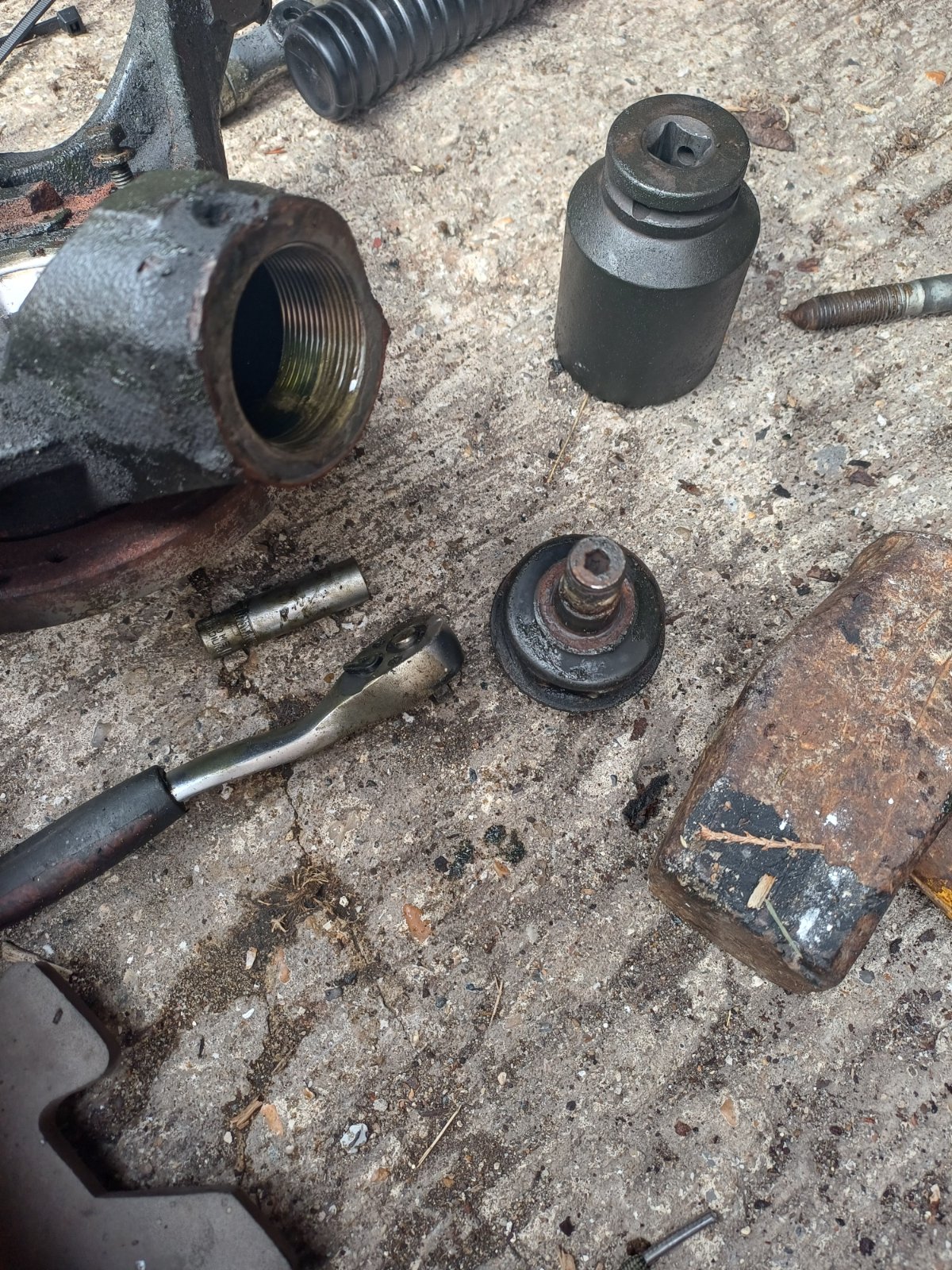

Lower balkjojnt naff , 41mm deep socket to the rescue

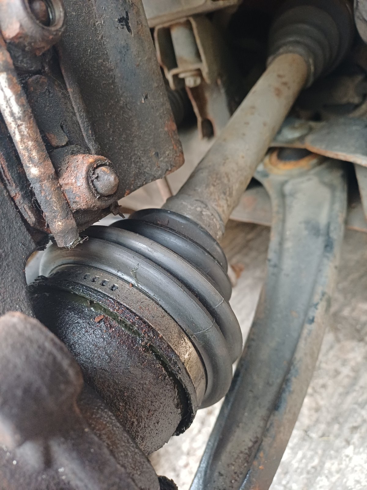

Re: 206cc to a 308cc How ? Why ? Everything 308cc
Unread post by Huskyxantia »

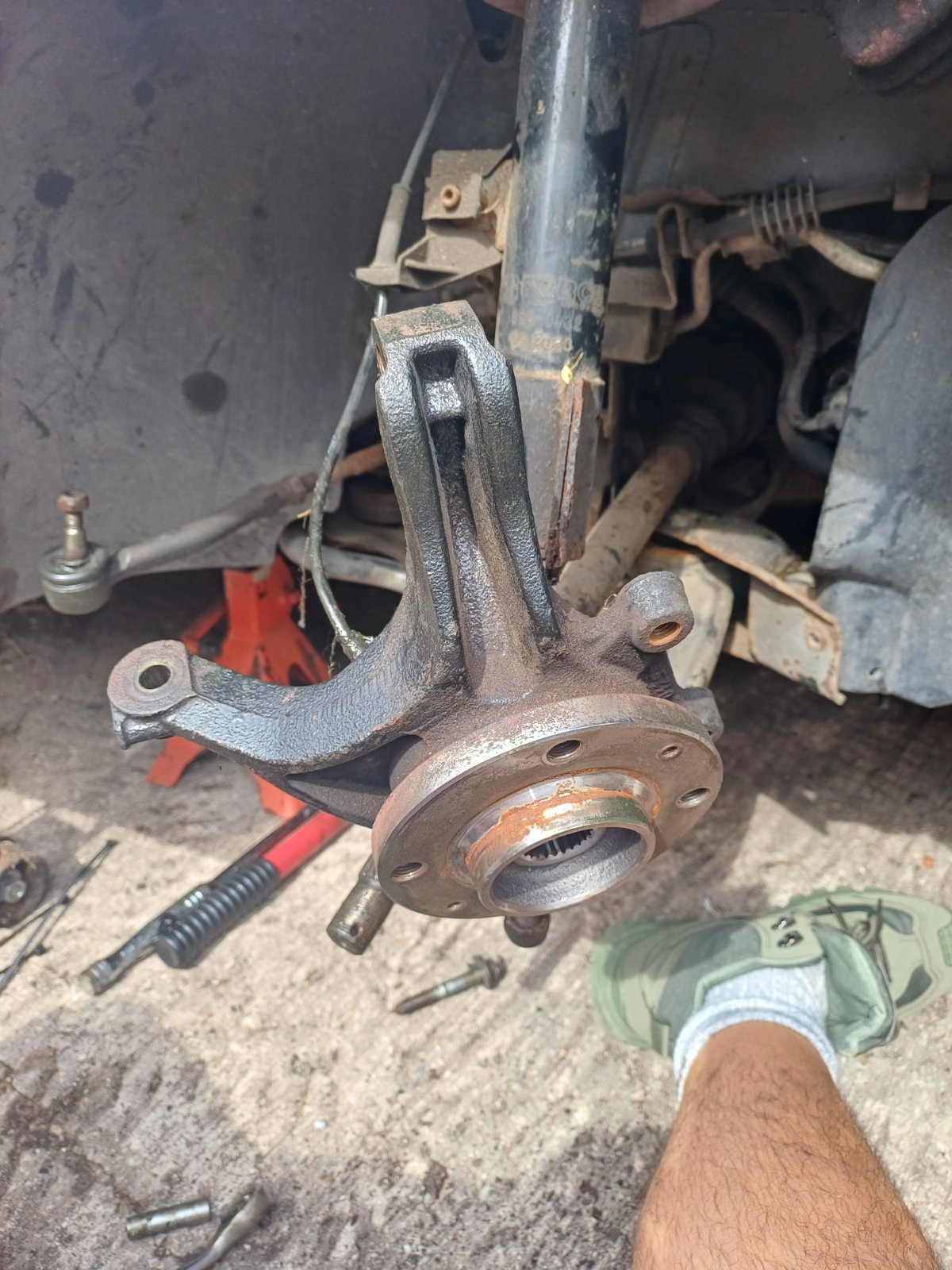

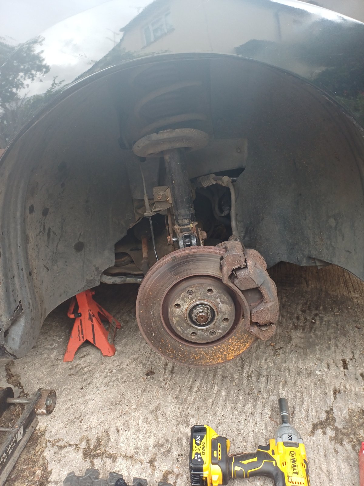

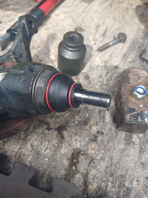

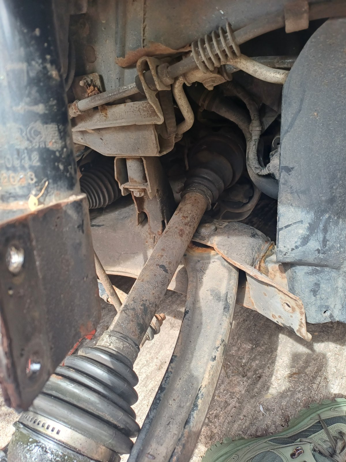

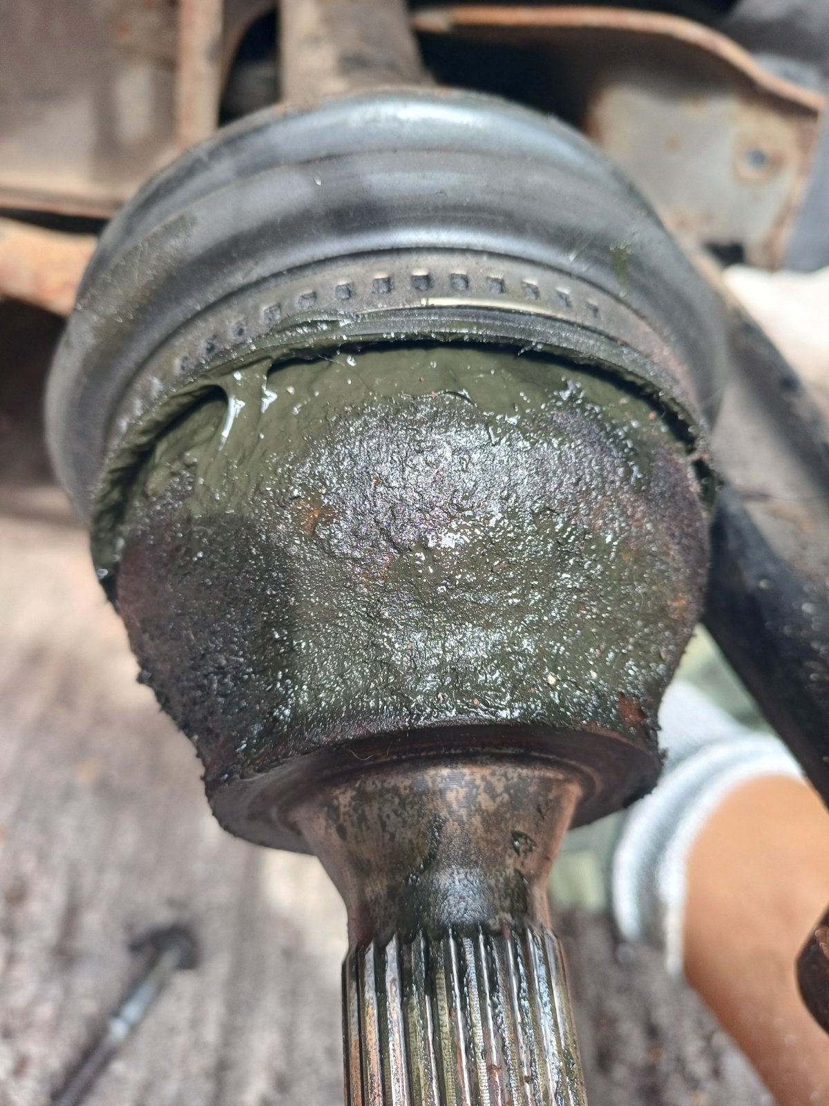

2 months ago there was a slight vibration at around 45 to 60 mph , so free time today at last and dry weather ive ruled out the upper tier rod inner and outer they are fine they are tight and hardly no play the drive shaft is the culprit should of know shouldn't i.... so one is on order ive renewed the lower ball joint , which I was dreading only due to hearing nightmares about there removal, I need not of worried it came out easy new febi brand now in place which has a 10 yr warranty, no bad is it !
Nice new lower ball joint , the real deal .
