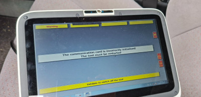

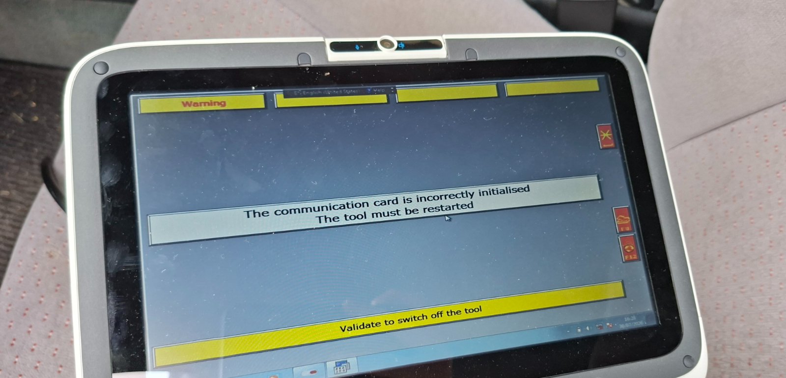

I'm trying to read out my xantia '94 with my clone VCI. I was able to read out my berlingo with it using diagbox 9.85, so I know the VCI works. Now I have a new laptop with windows 7 32bit and diagbox 7.58. I installed all the drivers needed to make the usb serial communication possible. When I plug in my VCI and launch diagbox, I select citroen, xantia and then when it asks which tool I would like to start (lexia/scantool) I remove the vci usb, wait 5 seconds and plug it back in. I then select lexia and get this screen. I also tried it without removing the usb, but we get the same result.
I also measured the voltage coming into the VCI adapter and measured 12.3V.
Does anyone have any experience with lexia and this screen?
Any help would be appreciated, thank you!

Re: Diagbox/lexia drivers not working/not installing
I have moved your post today to the thread you already have on this subject to avoid duplication, :)
