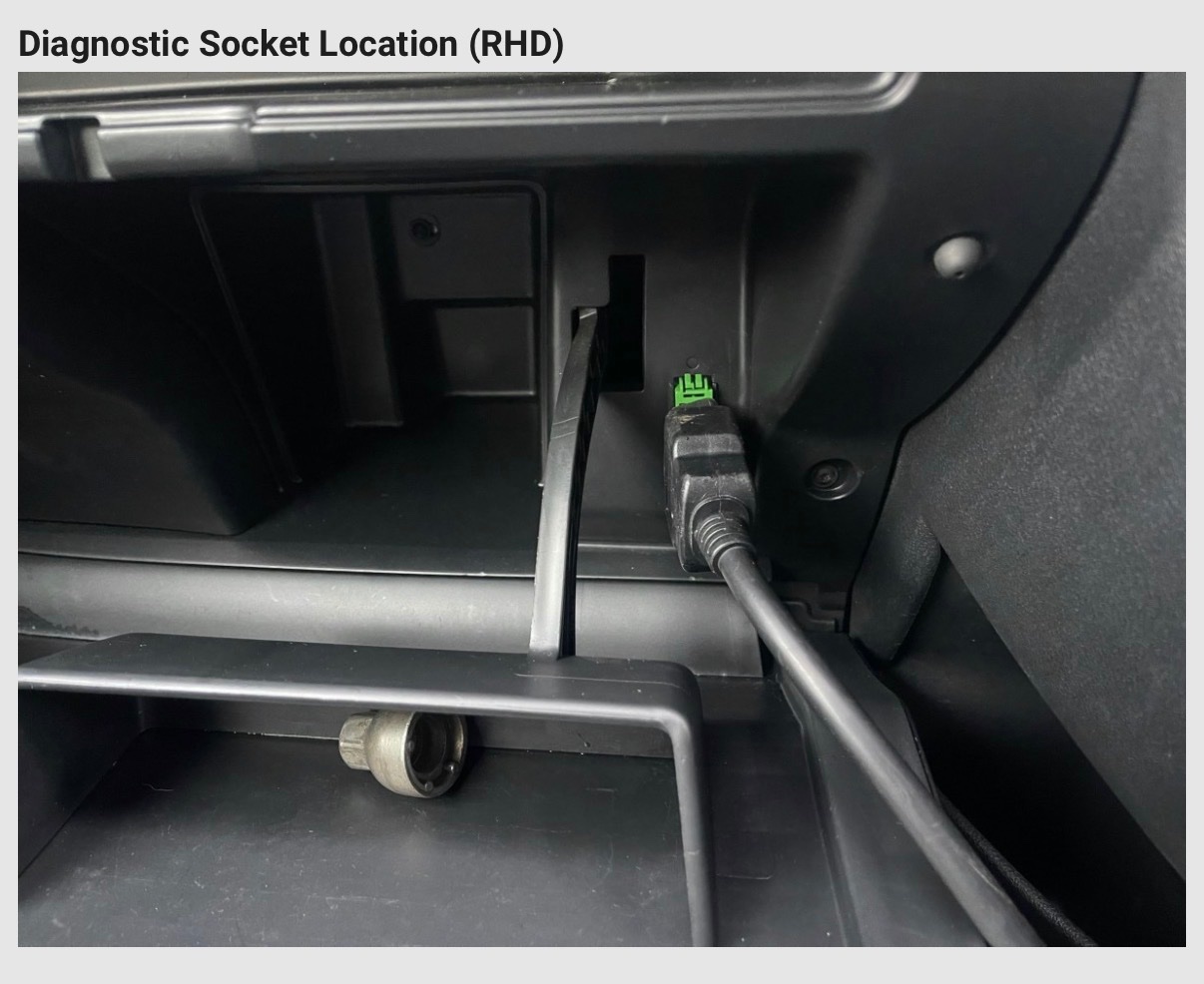

Re: Location of DLC/OBD port
On a mk3 (RHD) Berlingo it should be here.
If its not there it may have been removed form the original fitting for a few reasons.
Some people remove & hide or relocate it for security reasons to prevent theft by programming a key.
Did the van previously belong to a fleet company?
Some fleet companies use the OBD port for connecting trackers & telematics systems etc. sometimes they have to relocate the OBD port for this.
There is no chance it was manufactured without one. You say you have had the glove box completely out & had a good look? There isnt a lot of slack on the wiring so it wont be very far.
There’s no sign of any cut wires?
