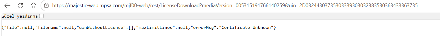

Hello, i've read my UIN with Arduino. But when i'm trying to download a license, i'm facing this error:
UIN: 3244303735303339303032383530363433363735

You have to convert that to hexadecimal, your UIN is 2D075039002850643675:
https://majestic-web.mpsa.com/mjf00-web ... 2850643675

I don't know what to say.. Thank you so much, really! You made my day!! Although i can't still use Android Auto with my phone, this is really relieved me.rui_saraiva wrote: 22 Jul 2026, 18:51 You have to convert that to hexadecimal, your UIN is 2D075039002850643675:
