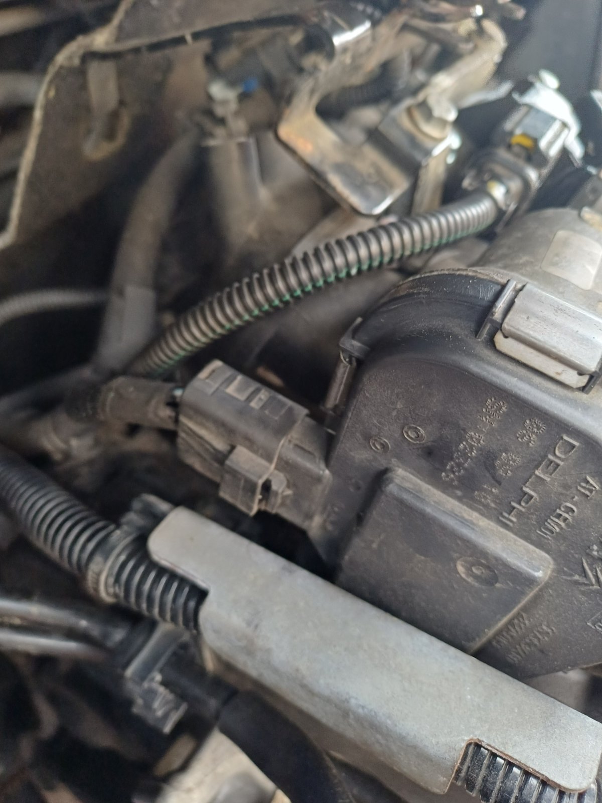

Pipes & Air Mixer: Got all the air pipes removed and cleaned out. The pipework had a fair bit of heavy sludge and carbon buildup inside, so gave them a proper scrub.

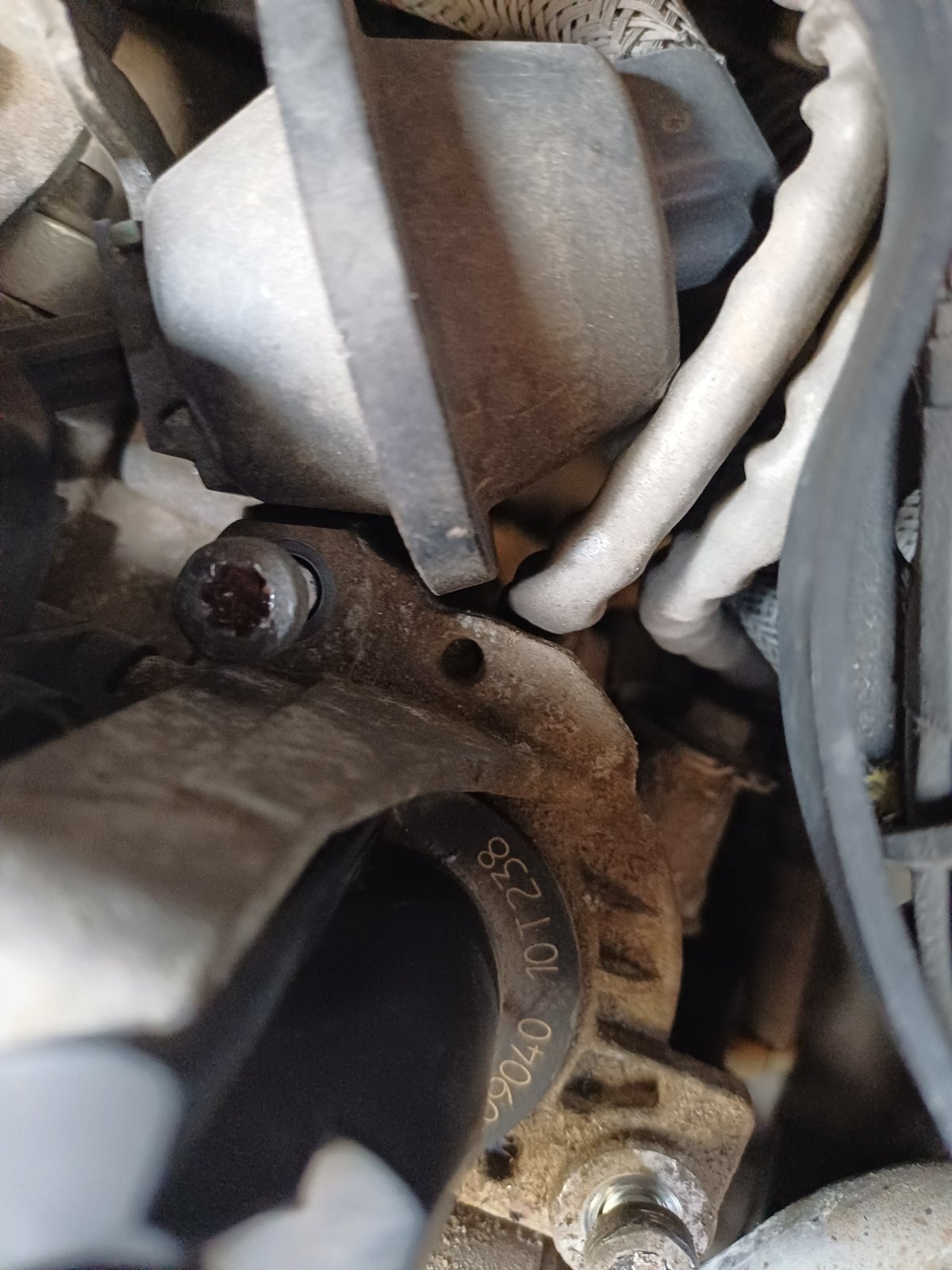

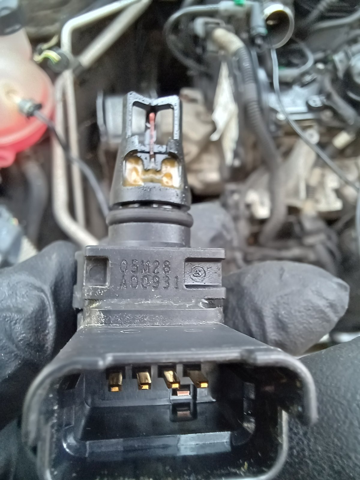

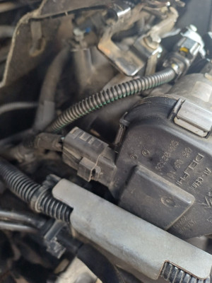

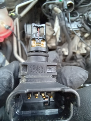

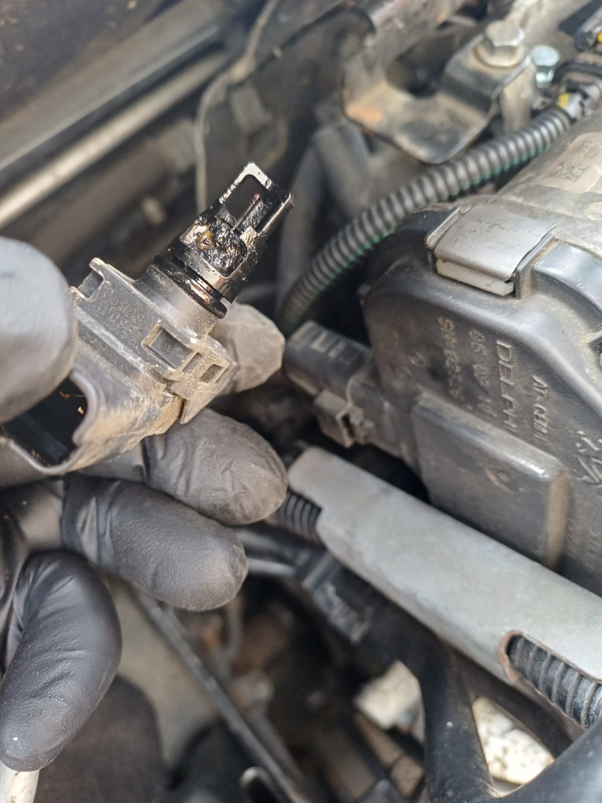

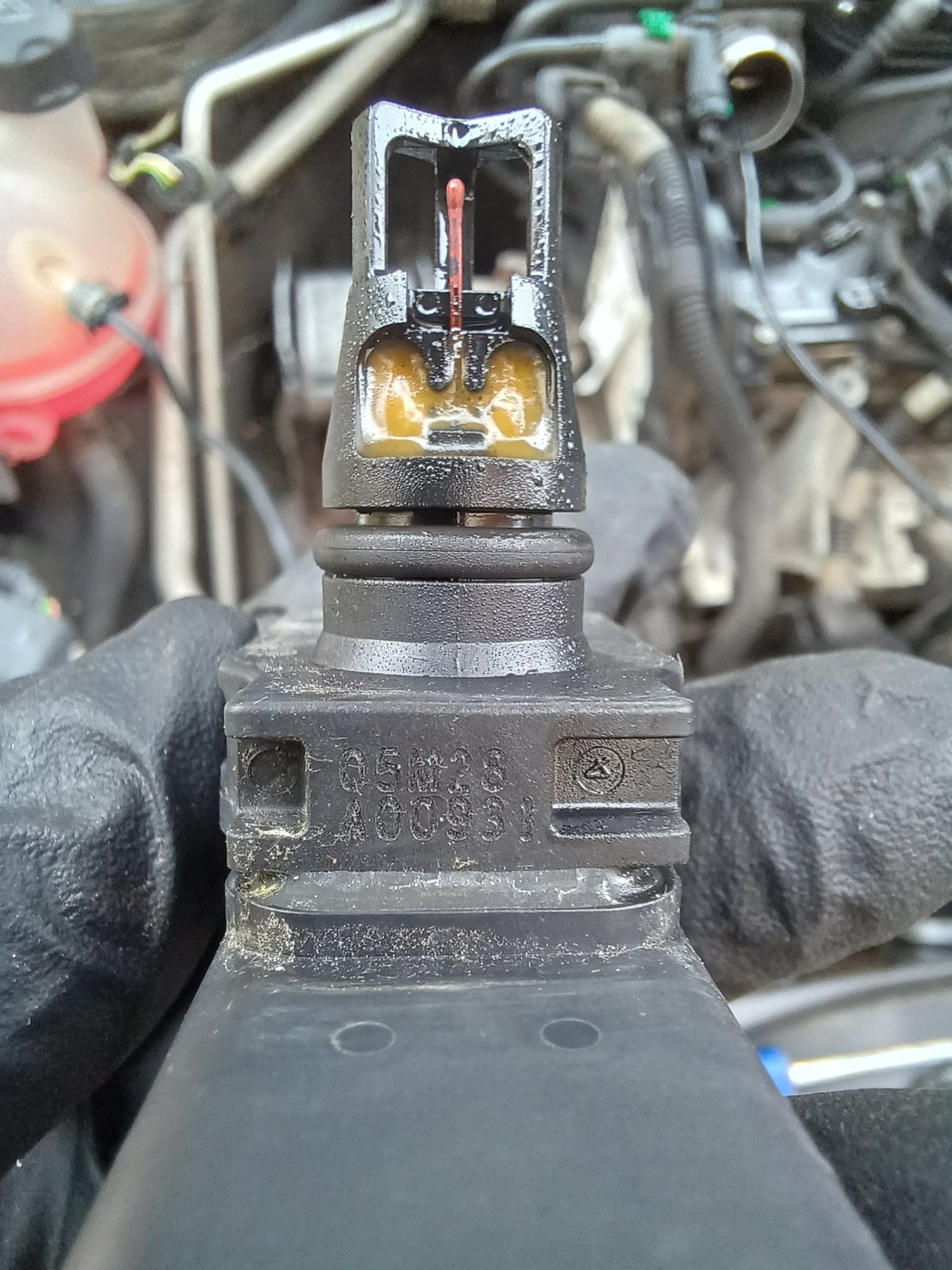

MAP Sensor Inspection: Pulled the MAP/IAT sensor out from the intake manifold behind the throttle body. The tip was completely caked in thick, black oily gunk and carbon soot, which will definitely have been insulating the sensing element and throwing off reading response times. Stamped part numbers on the Denso unit logged as: 9663480880 / 079800-9200.

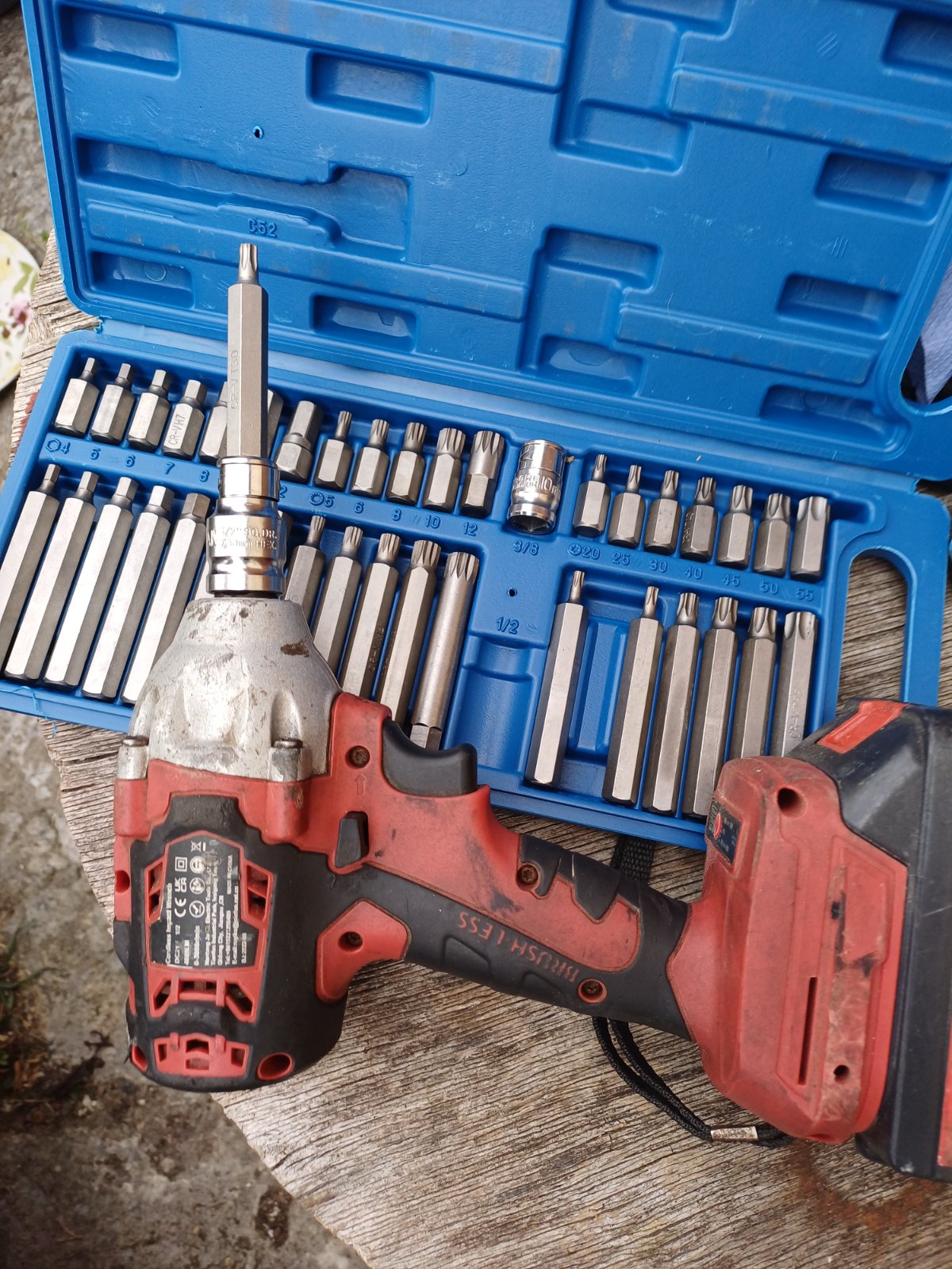

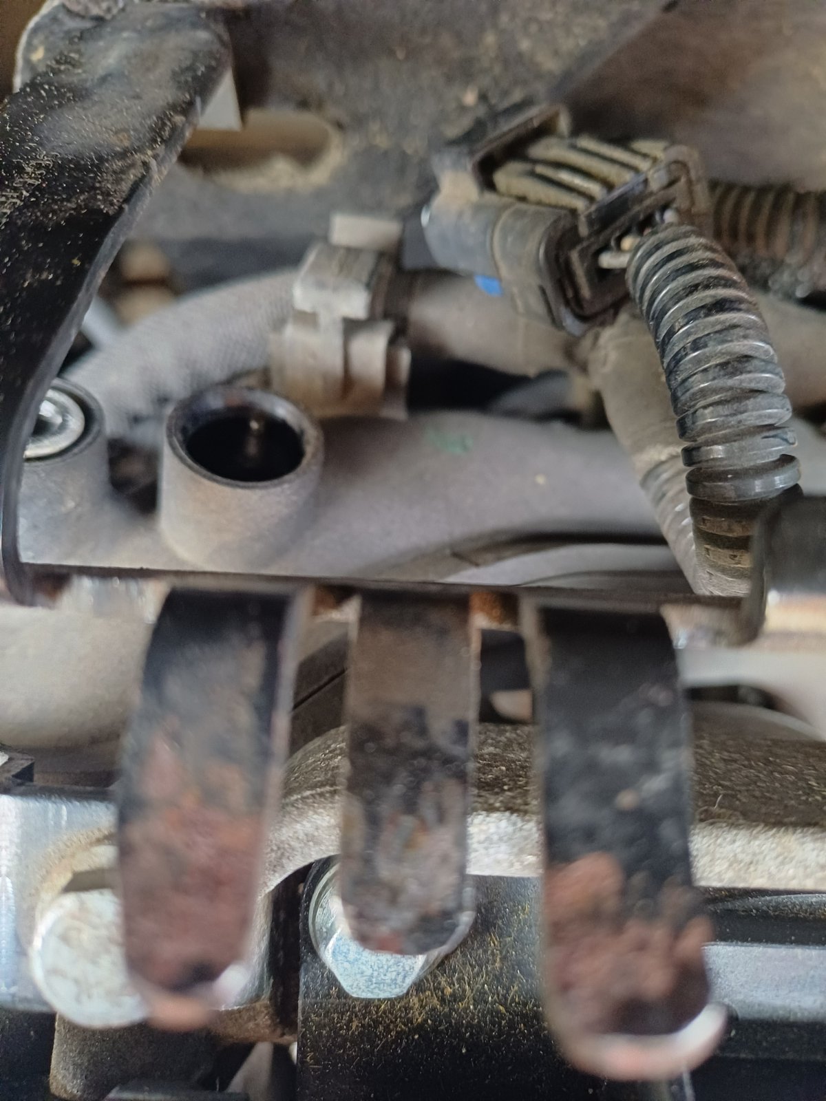

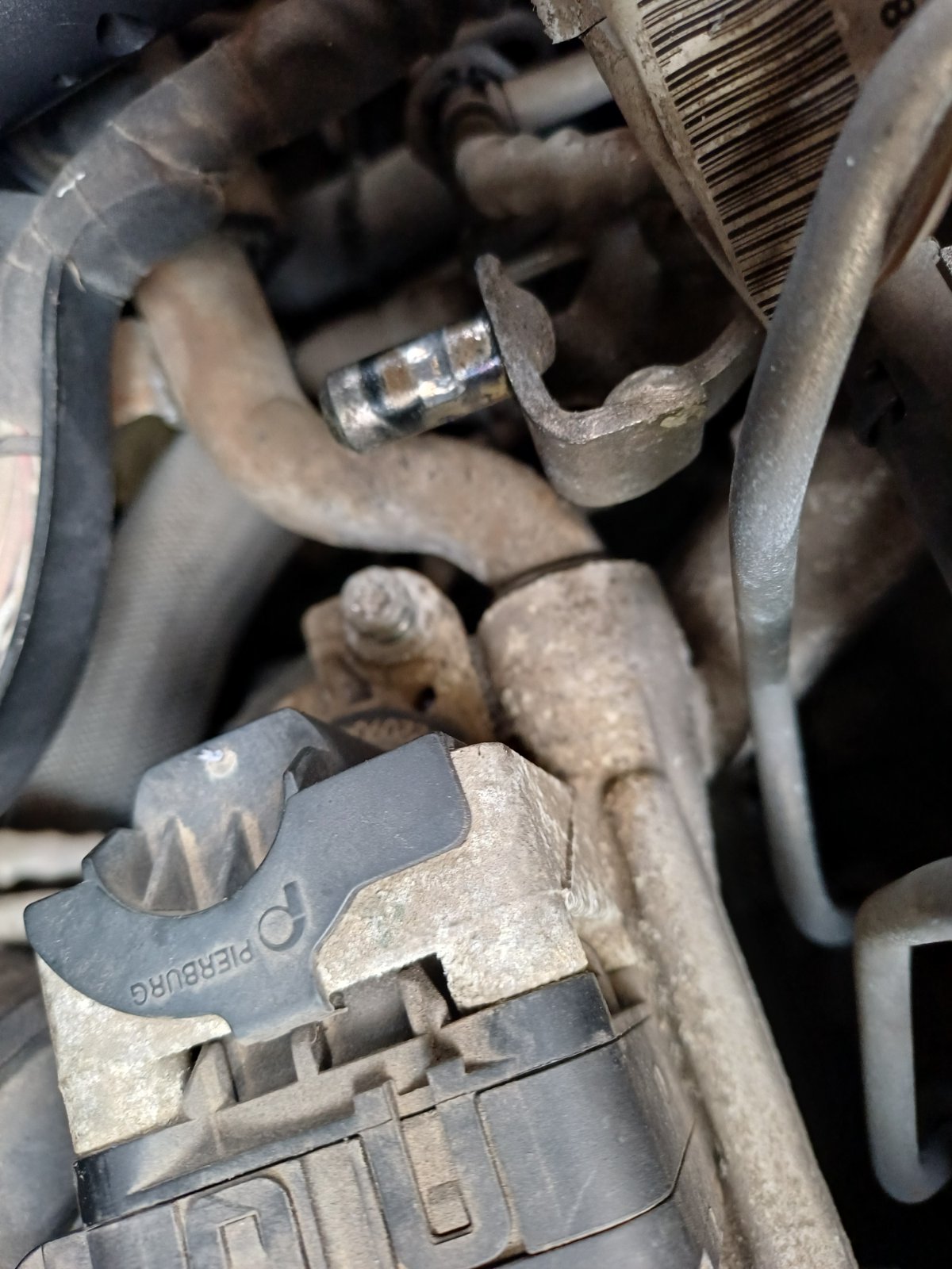

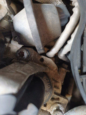

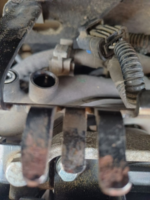

Manifold Removal: Tried to get the intake manifold completely off the engine to give it a full bench wash, but couldn't get it removed due to restricted access and hidden fixings at the back. Settled for cleaning out what can be reached through the ports.

Test the cleaned Denso MAP sensor using a multimeter (checking ohm resistance on the IAT thermistor pins and signal response) before refitting.

Map sensor before & after cleaning, the location as seen by the photos just past the bend on the inlet pipe under a bracket which bolts 10mm size on to the alloy fuel filter housing. It can be removed with out moving bracket you just have to workout the way you need to lift it out but it will come out with a turn and a lift and a pull away side ways away from the bracket

Mucky thing.
After a spray with.
https://ebay.io/m/dzAegk
It came up nice and clean my only issue was the can then decided to stop spraying and its still almost a full can, not best pleased so I have messaged the seller to inform them of this when you pay for a highly recommended product you don't expect this to happen.
After a spray with.

Some might say over kill but my theory about using one of my slower rattle guns actually worked we all know what this hex bolts on the egr are like and more than often can snap or chew the heads if you use a rachet and do it by hand i opted to try my theory which was a rattle gun can shock the bolt that quick its got no choice but to come undone and bingo it worked.

Absolutely! One of the joys of a variable speed/effort rattle gun Husky! They really are invaluable
