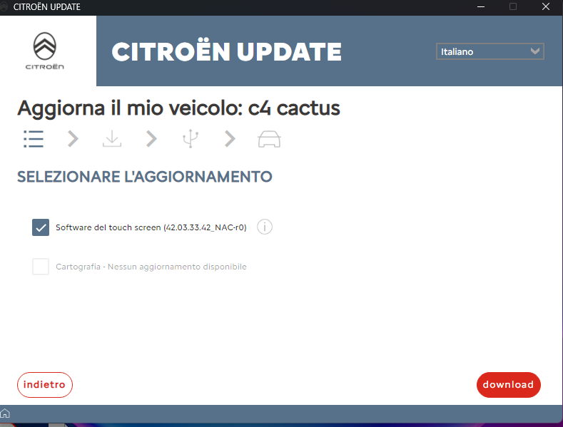

Good morning,
Excuse my English. For a few days now, the My Citroen app has been notifying me that a new update (44-07-33-42) has been released for the NAC on my Citroen C4 Cactus (2018), after a long delay.
Once downloaded to the USB drive, the car's USB doesn't recognize it. No message is displayed.
I hope you can give me some suggestions. Thanks.

@Roger971: From the screenshot it's the firmware version 42.03.33.42_NAC-r0, the one that converts NAC_EUR_WAVE3 to NAC_EUR_WAVE4 - so you have/had a NAC_EUR_WAVE3 from the factory. What is your current firmware version?

this one, thanks for the replyrui_saraiva wrote: 21 Jul 2026, 15:44 @Roger971: From the screenshot it's the firmware version 42.03.33.42_NAC-r0, the one that converts NAC_EUR_WAVE3 to NAC_EUR_WAVE4 - so you have/had a NAC_EUR_WAVE3 from the factory. What is your current firmware version?

@Roger971: You already have the latest firmware version, ignore Citroën Update.

I thought so, thanksrui_saraiva wrote: 21 Jul 2026, 16:16 @Roger971: You already have the latest firmware version, ignore Citroën Update.

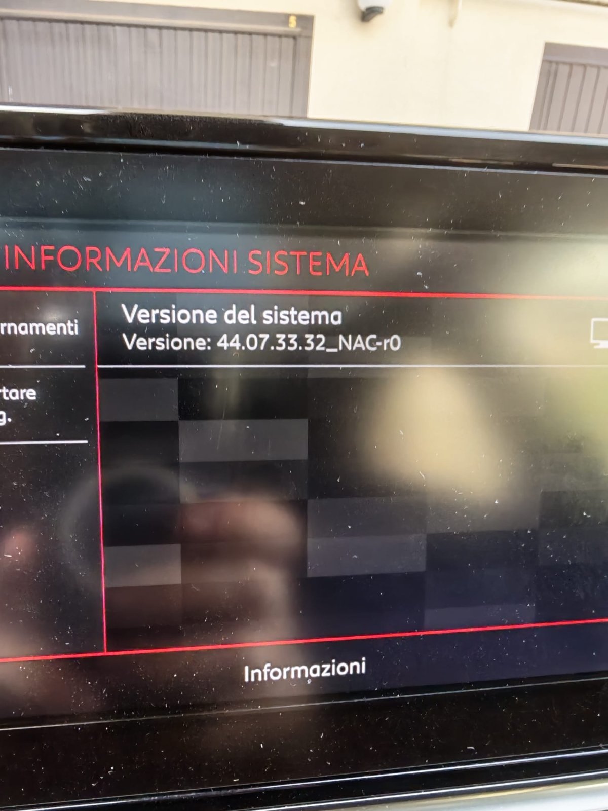

Re: PSA NAC RCC Updates
Hello Rui and everyone,
First of all, thank you for all the work you have done for the PSA/Stellantis community. Your guides have already helped me successfully update my NAC firmware.
I have a Peugeot e-208 GT (2021) with a NAC Wave 4 unit.
Vehicle details:
Peugeot e-208 GT
Model year: 2021
VIN: VR3**************[VIN obfuscated, can be read by forum staff]
NAC EUR Wave 4
Current firmware:
44.07.33.32_NAC-r0
The firmware update completed successfully and the unit works perfectly.
Unfortunately, I cannot install any map version.
What I have already tried:
Original Peugeot Update package
Manual installation
USB drives formatted as FAT32 and exFAT
Different USB flash drives
Latest firmware already installed
Packages containing versions 14, 16 and 20
Your manually prepared package with UpdateInfo.xml
The behaviour is always the same:
The system detects the USB stick.
The update starts normally.
After a short time the installation fails.
The maps remain unchanged.
Additional information:
The vehicle originally came from the Netherlands.
Connected Services now work correctly (e-Remote, remote charging and remote climate control).
Firmware installation is successful, only map installation always fails.
Do you know what could cause this?

rui_saraiva
- Posts: 121
- Joined: 15 Feb 2023, 10:31
- x 63
@Martin03: Are you using a macOS system to prepare the USB flash drive?
Martin03
- Posts: 3
- Joined: 22 Jul 2026, 07:58
- x 1
Yes, I am using macOS.
I formatted the USB drive as both exFAT and FAT32 and tried several different USB flash drives.
I also removed the macOS hidden files (._*) before trying the installation, so the USB only contains the required files and folders.
If you think there is anything else I should check regarding macOS, please let me know.

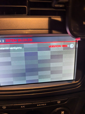

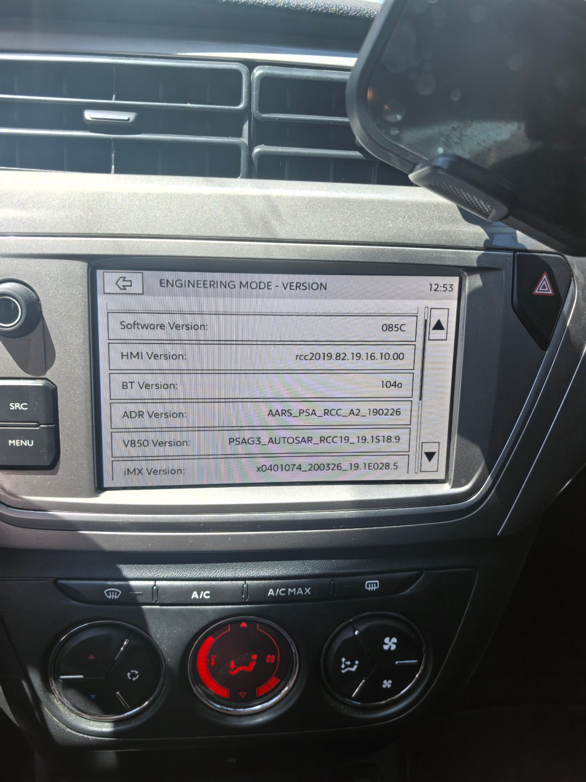

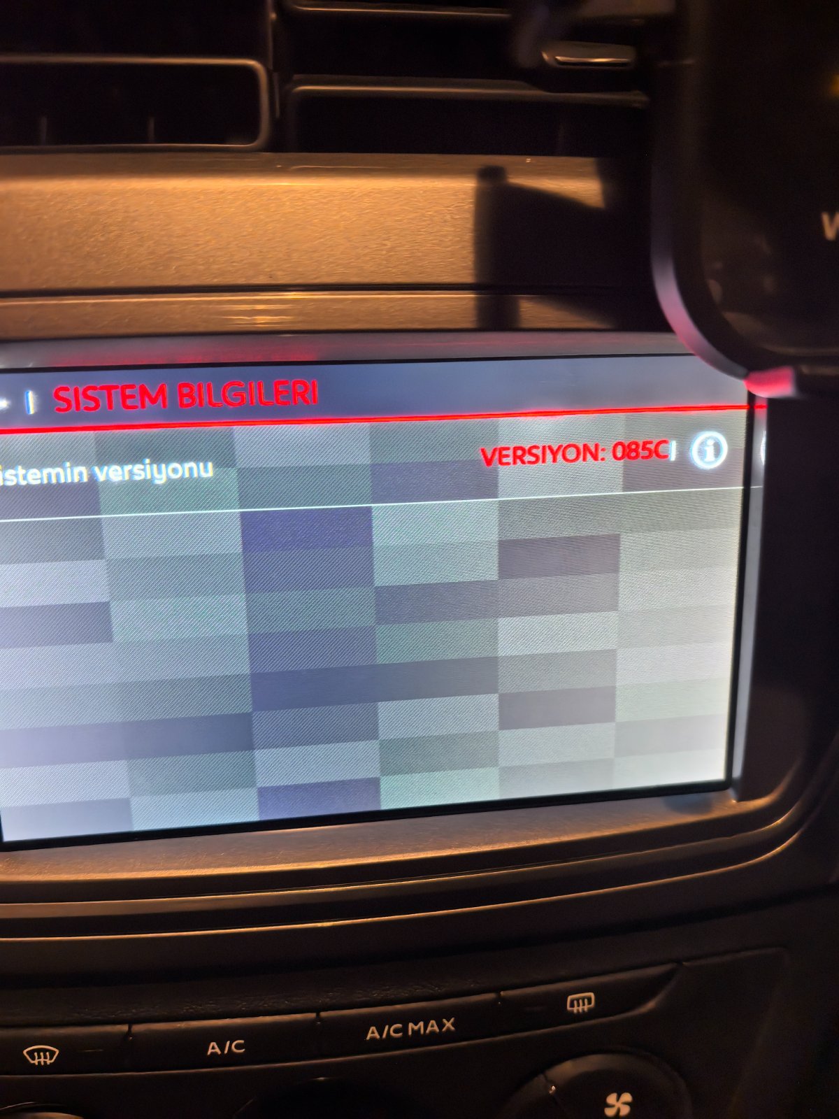

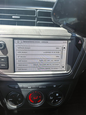

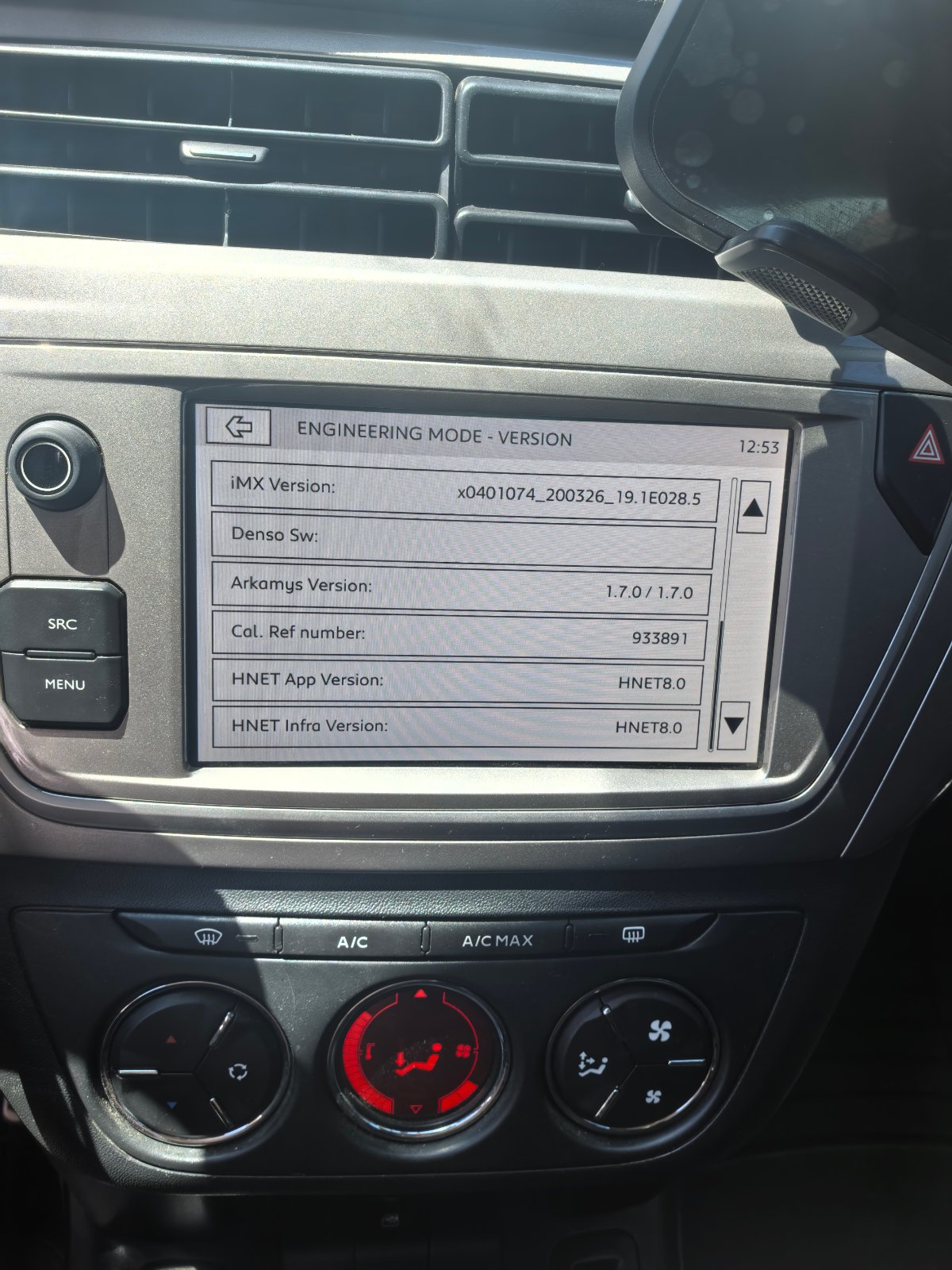

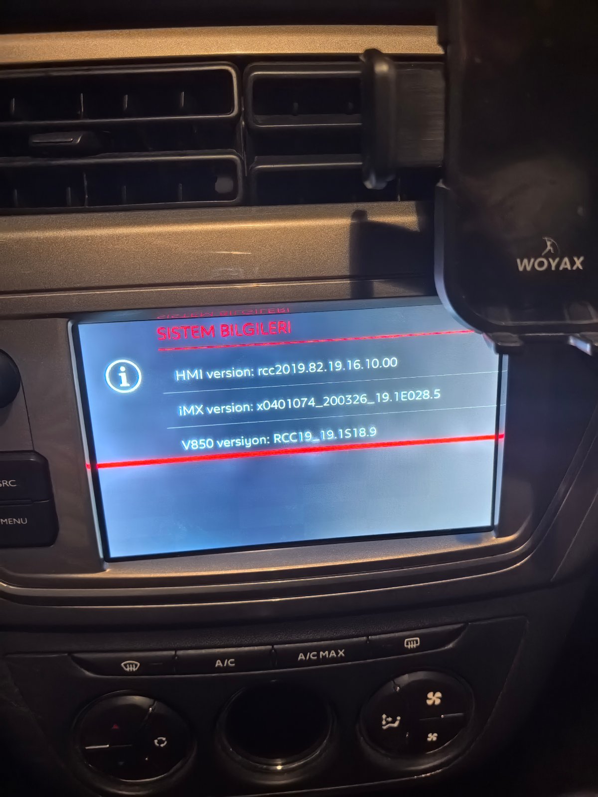

Hello, i can't update my RCC Wave 3 unit. It says usb key isn't compatible with this vehicle. I've tried Citroen Update, PSA update and manually downloading from servers but not worked. Any solution? Thanks.
@Martin03: The flash drive MUST be FAT32-formatted, but Peugeot Update should correctly prepare that for you.
If you're referring to the "dot_clean" utility, that's not enough. It just deletes the "._*" files, but not files such as ".DS_Store". Try running: (you can remove the last argument "-delete" to only see if there are any files without removing them).
After deleting extraneous files from the critical "/SWL/002*/Data/data-pkg/NAV/MAP/" folder, you need to unmount the USB drive right away.
@tunahan12: Is that the first time you try to update that system? That is a generic error, but it is usually related to an invalid license file. It's not common, but I've already seen incorrect UIN (the unique identification number of your head unit) associated with a VIN... If that's the case, you need to connect your car to a WiFi network, but not all RCC systems support that. The other option is to physically remove the head unit and look for the label/stickers, especially the one with "Bosch" and "PSA".
Hello, yes this my first time. I think previous owner haven't tried it too because version is equal to my model year (2020). My unit doesn't have WiFi module but i have PSA Arduino module. Will it be helpful without removing unit?rui_saraiva wrote: 22 Jul 2026, 16:50 @Martin03: The flash drive MUST be FAT32-formatted, but Peugeot Update should correctly prepare that for you.
If you're referring to the "dot_clean" utility, that's not enough. It just deletes the "._*" files, but not files such as ".DS_Store". Try running:(you can remove the last argument "-delete" to only see if there are any files without removing them).Code: Select all
find /Volumes/*/SWL/002*/Data/data-pkg/NAV/MAP/ -type f ! -name "*.ttpkg" -delete
@tunahan12: You need to find the UIN/serial number of the RCC head unit, it's a 20-digit hex number. You could try to read the 0xF18C zone with the Arduino.
With the UIN, you can download the license for the latest RCC_EU_W3_ECO firmware version, 6_0432_23.2I44.1 (UpdateID 005315191766140259), and for your infotainment system from:
I'm assuming that the file "/license/license_xxxxxxxxxxxxxxxxxxxx.key" that Citroën Update downloads is not the valid one for your system (incorrect UIN).
Code: Select all
https://majestic-web.mpsa.com/mjf00-web/rest/LicenseDownload?mediaVersion=005315191766140259&uin=2D0xxxxxxxxxxxxxxxxx
