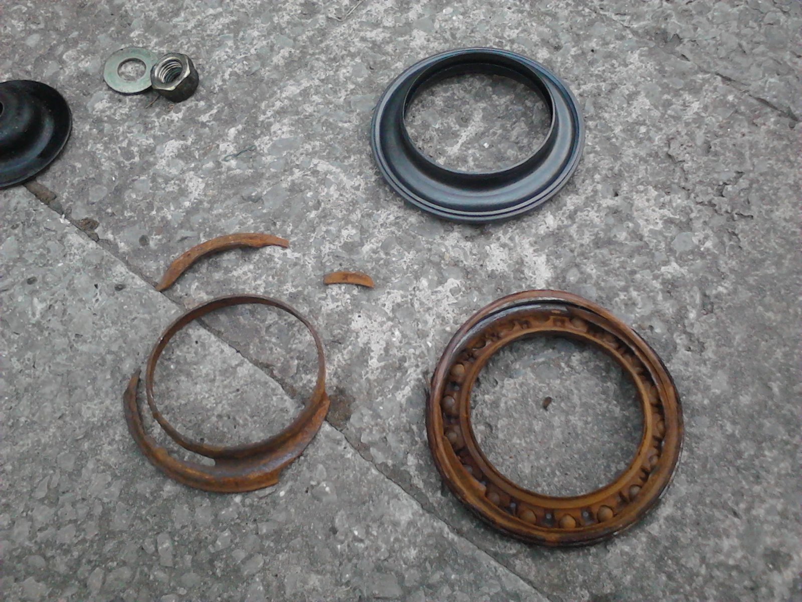

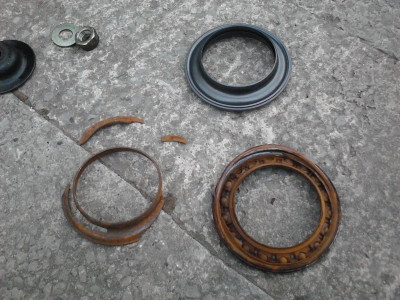

I'll dig out the pictures of my 306's top mount bearings at some point. The only complaint was a slight graunching noise turning lock to lock,
I couldn't believe the state they were in when removed!
EDIT easier to find that I thought!
Spoiler: show
:shock:
EDIT 2 = MAY 2013. Thirteen years ago!?!
Huskyxantia
Posts: 3920
Joined: 30 Jul 2018, 22:11
x 920
Unread post by Huskyxantia »
Just like what my 206 looked like when I had it slight noise which got worse and they were just like your ones.

Unread post by RichardW »
It was the bit above that which was broken on my 3008 - the central metal sleeve had become unbonded from the rubber surround. The OS one wàs knocking a bit, the near side one had developed a horrendous squeaking noise by the time I got to replacing it! Not really sure how you would diagnose without dismantling the strut...

MattBLancs wrote: 28 Jun 2026, 20:01 I'll dig out the pictures of my 306's top mount bearings at some point. The only complaint was a slight graunching noise turning lock to lock,
I've extracted a few grotty ones from AXs in the past - so easy to dismiss and forget about these as they are well hidden...
