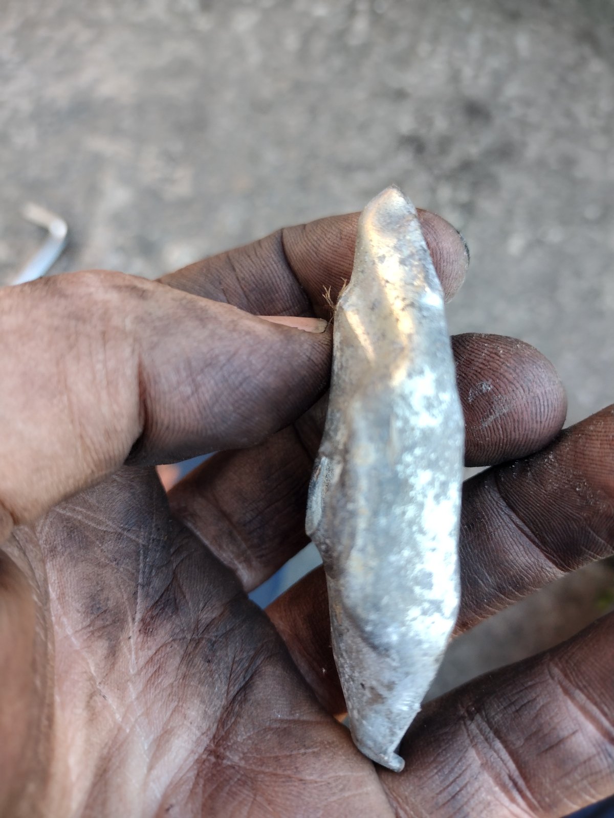

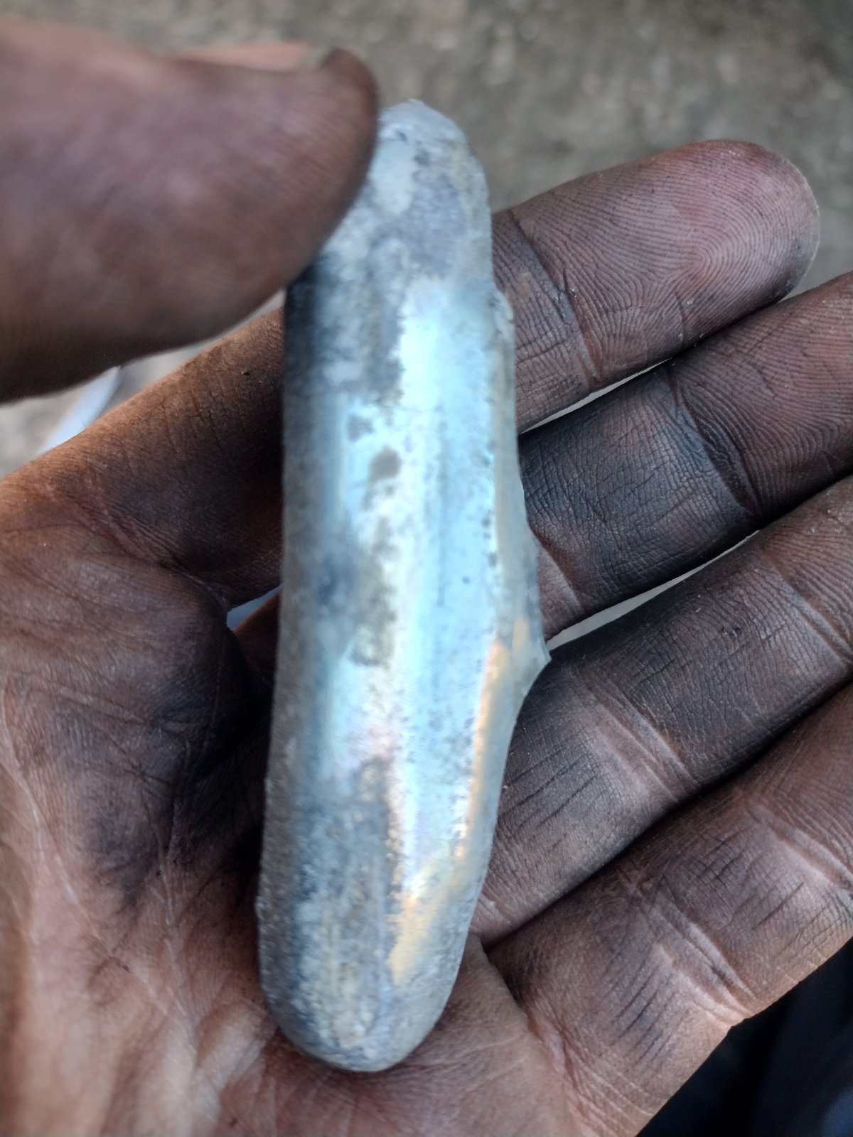

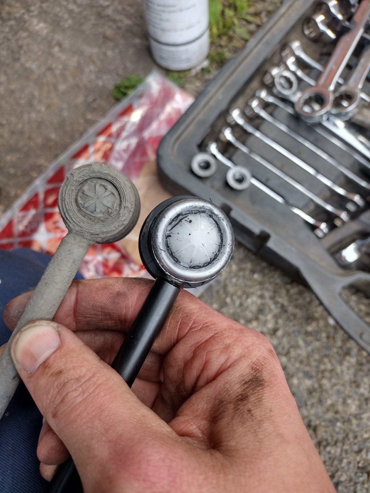

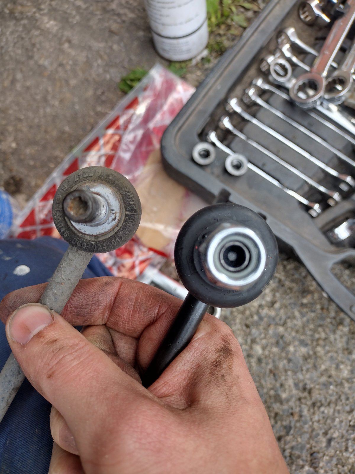

308 SW, front end clunk.

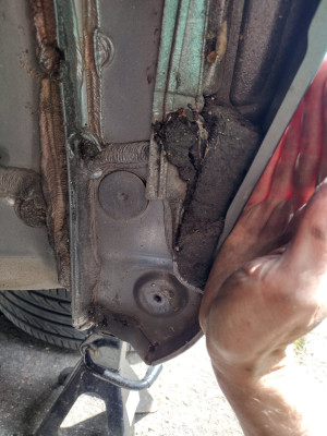

I had it up on axle stands today and a "good wiggle" to try and find source of the clunk. Recently replaced track rod ends unsurprisingly, and indeed thankfully! Fine.
Bottom ball joints seeming fine.
Suspected anti-roll bar drop links and have a set of febi items in stock ready to go on. So set to fitting those.
Job went remarkably smoothly with everything "just unscrewing" - a rare occurrence for me with suspension components!

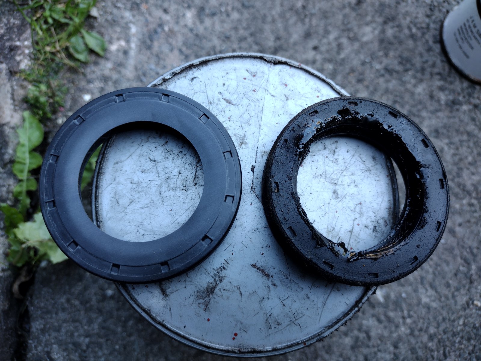

Interestingly the ball joints on the ends of one of the removed drop links noticeably smaller in diameter, rather odd! The other had threaded studs and noticeable few millimeters shorter than the others. On inspection both seemed okay, but change them anyway for the sake £15 or so.
Knock was suspected as coming from the drivers / right-hand side so did that first. Then move round to the passenger / left side and have changed that too. However the wishbone bushes on this side appear rather tired. Again I've got a new set in stock, very cheap on Halfords trade got them a few months back. Car is back on this wheels and the wishbone bush replacement job well have to be post tomorrow morning's trailer tip trip at 10 o'clock.

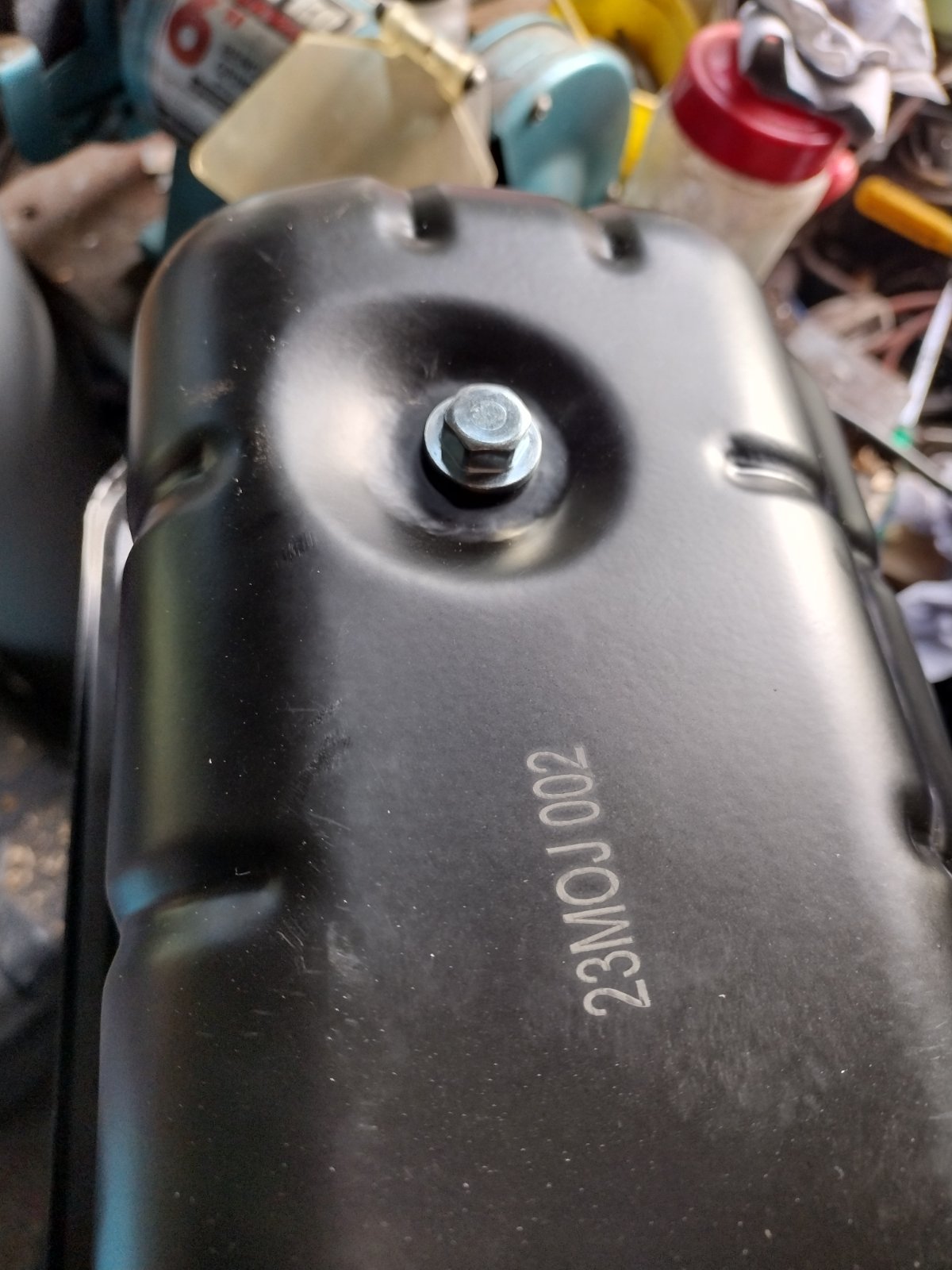

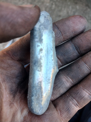

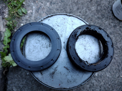

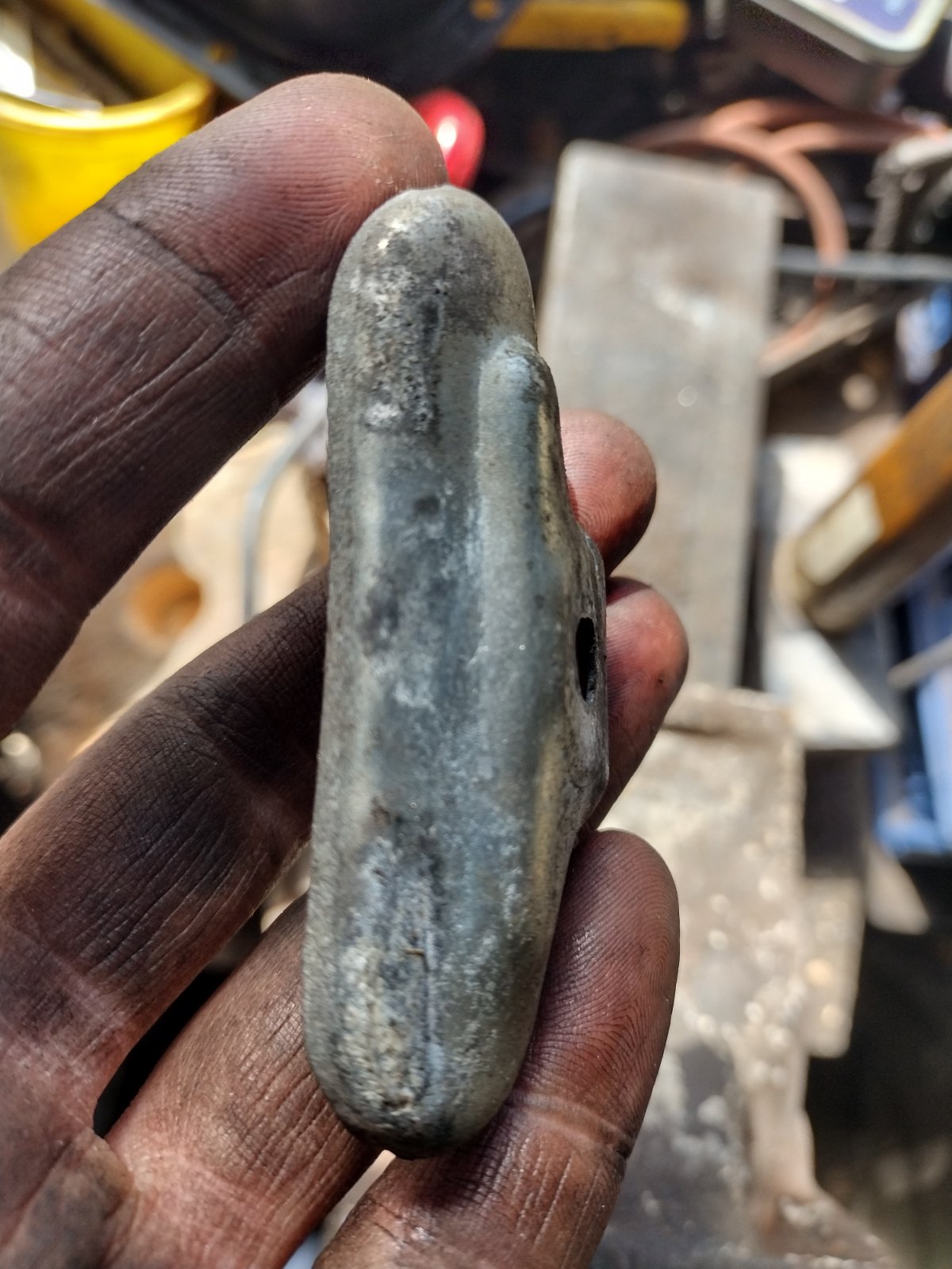

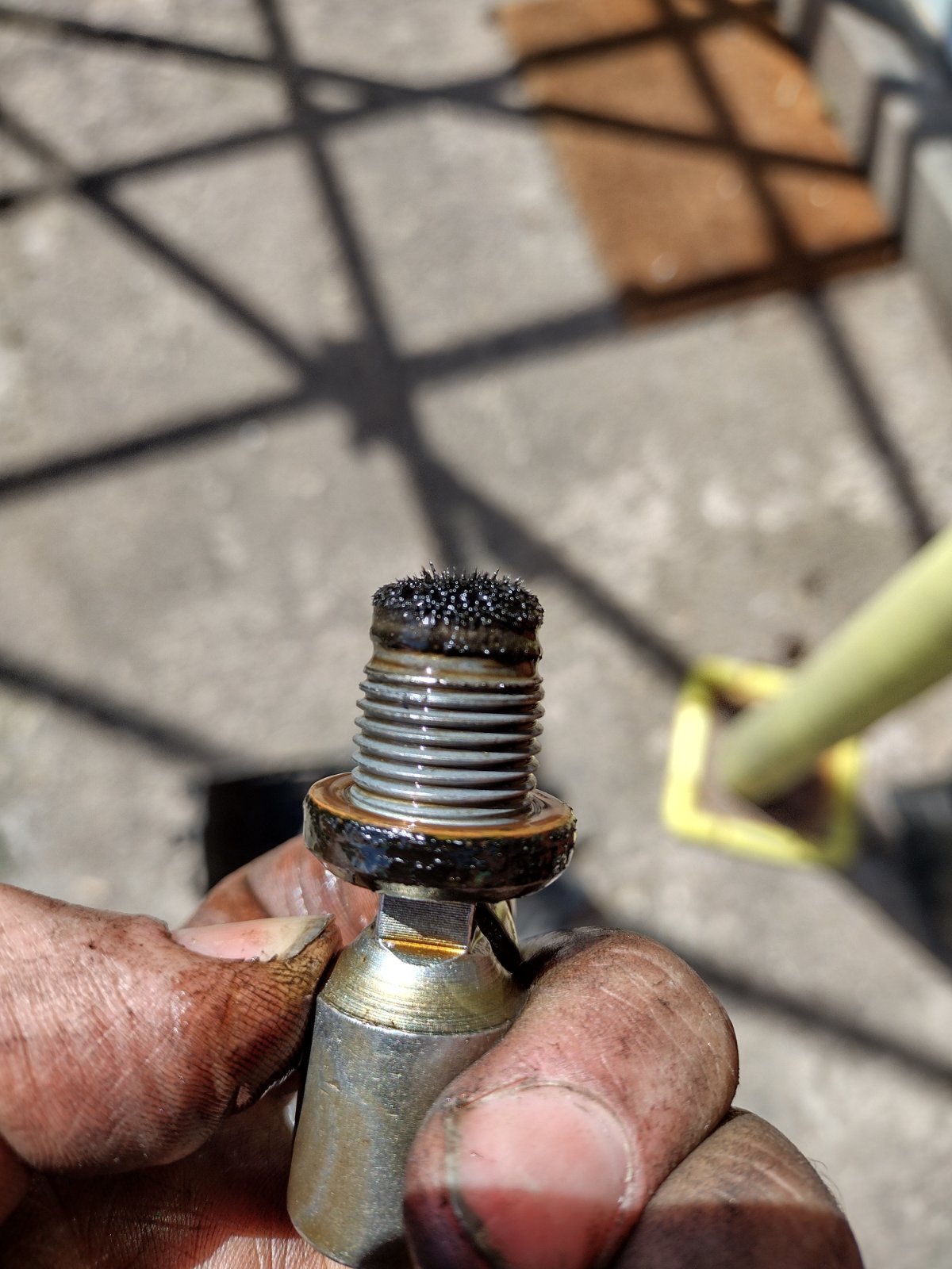

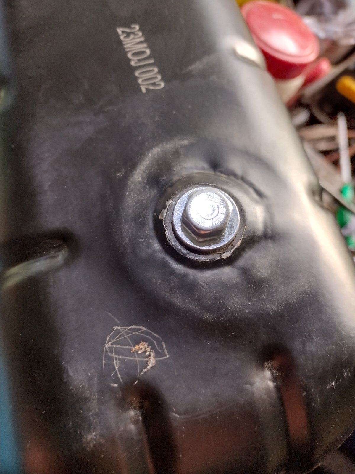

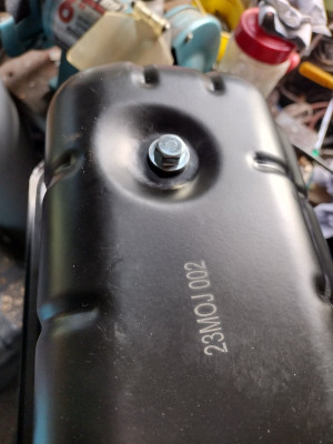

A few pictures of the things seen on suspension: Next on the task list was unearthing a brand new dv6 oil sump that I may have forgotten I'd bought! And attacking it with a hammer (and a impact socket and short extension) to convert its drain plug from an "inny" to an "outy" (again using the handy belly button terminology)
A few pictures of that for your enjoyment: Weapon of choice: It's now been given relatively terrible splattering of orange paint from the end of the tin used previously. You may notice a rusty scratch mark near the drain plug, this caused by a relatively hidden nail within the wooden block which I had not spotted!

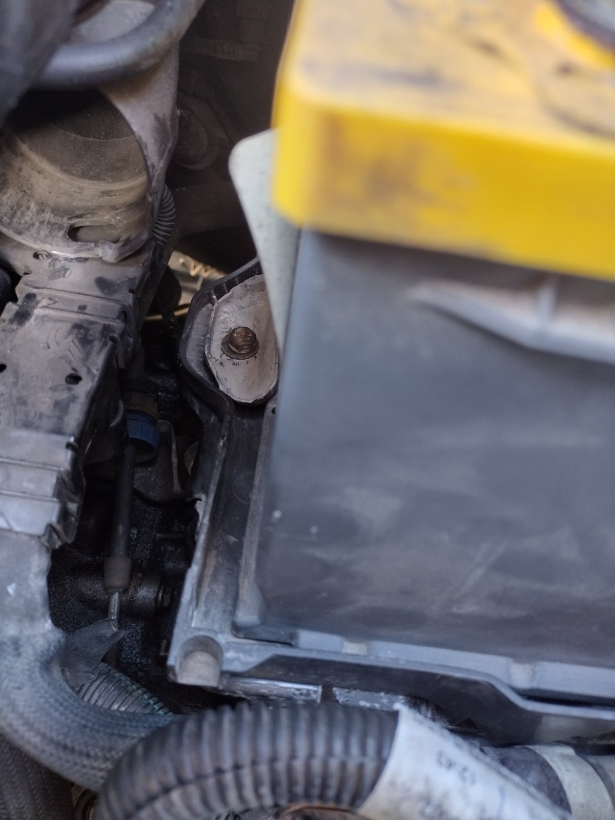

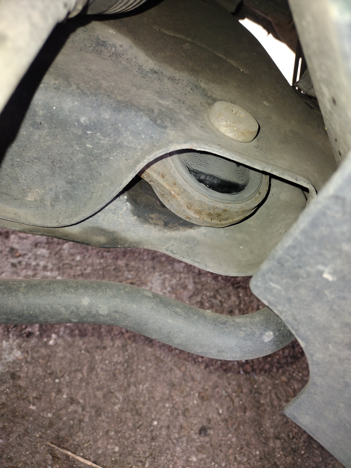

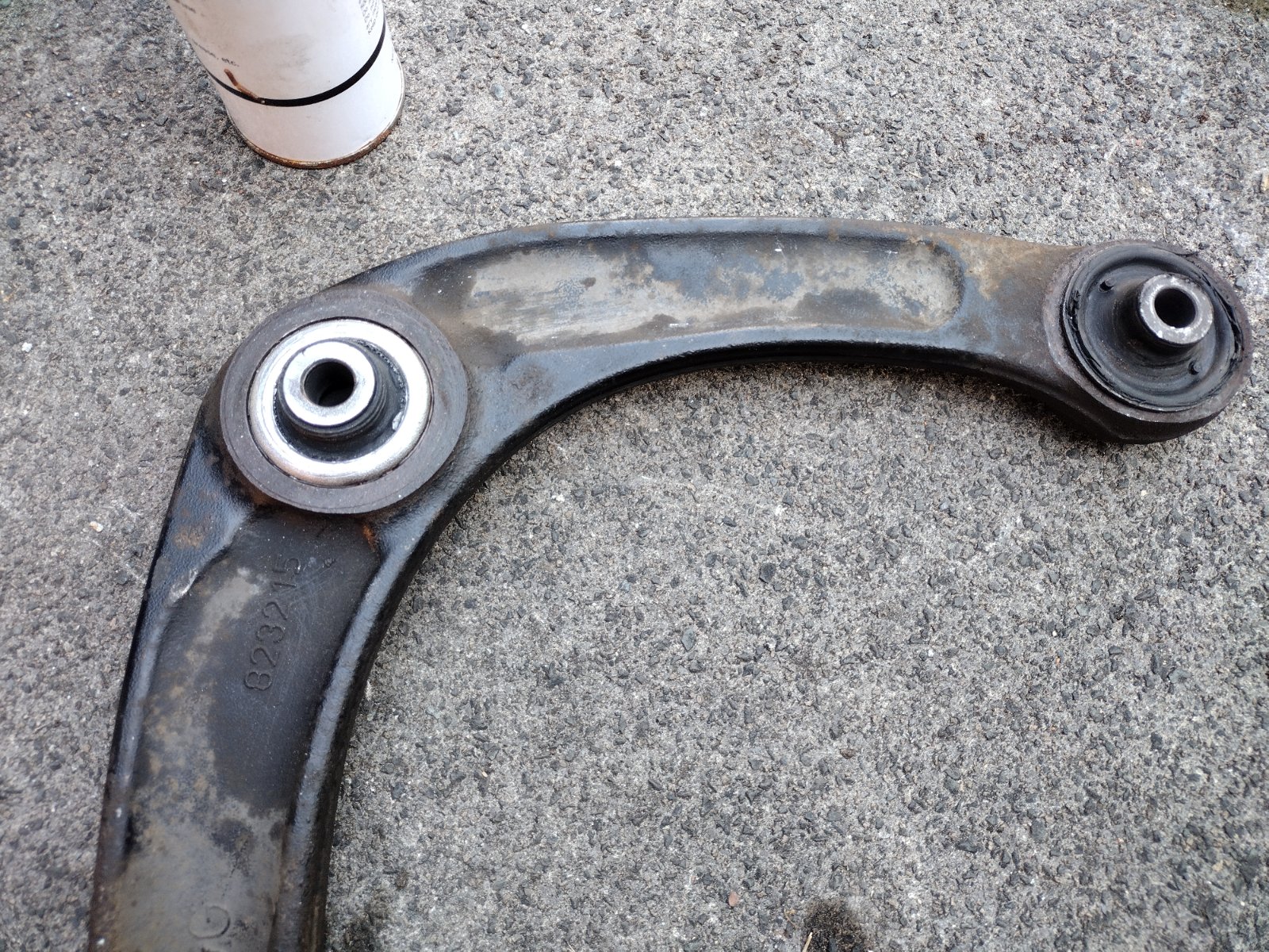

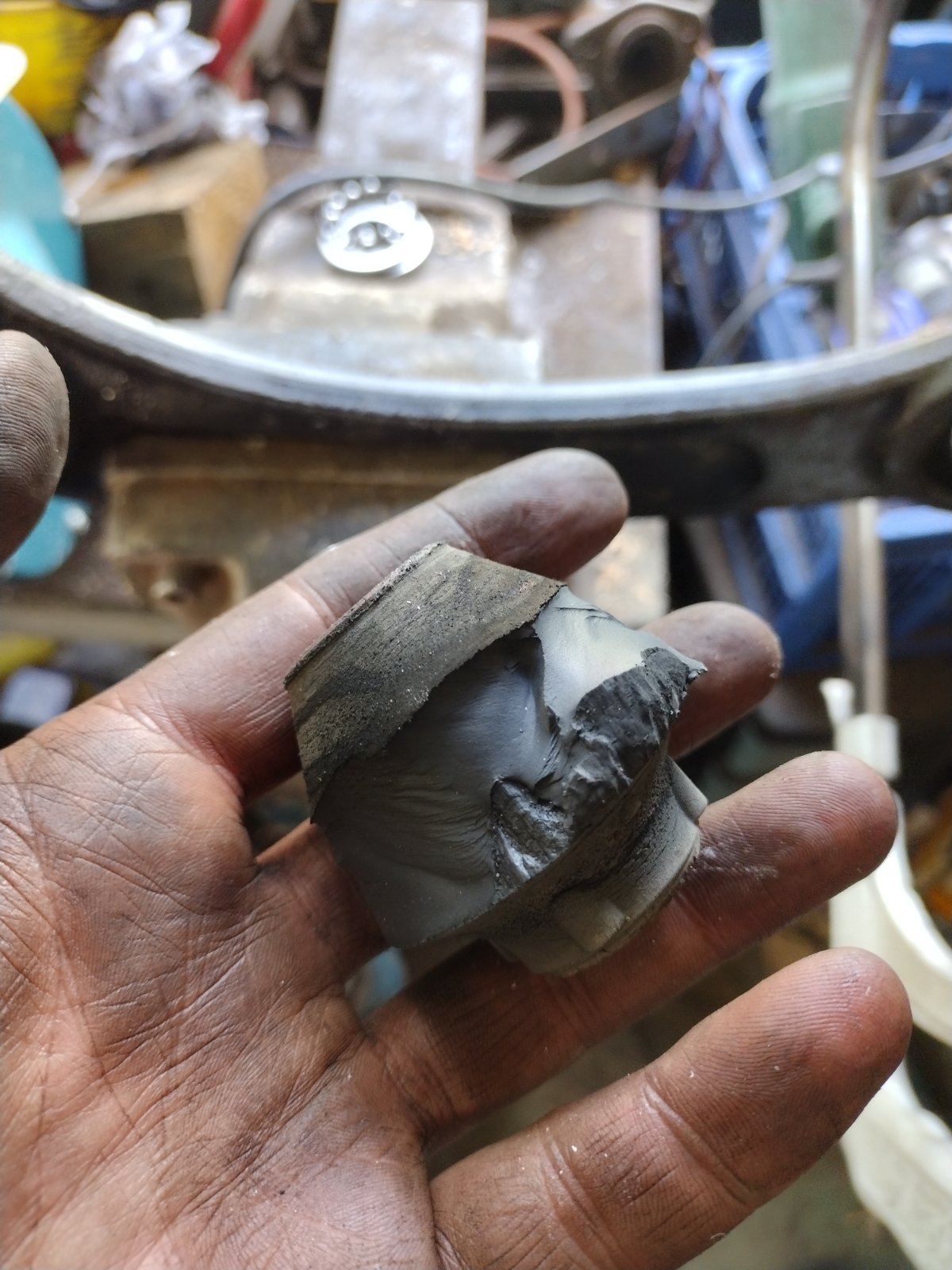

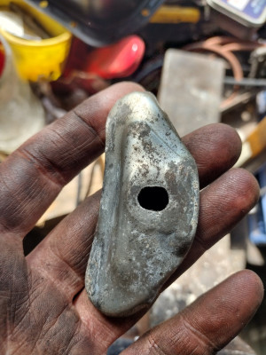

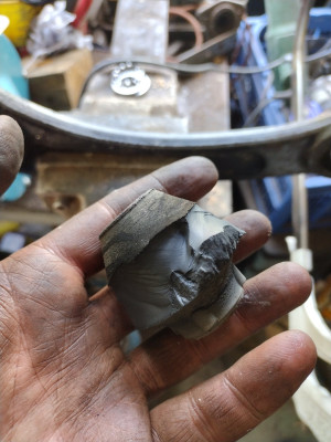

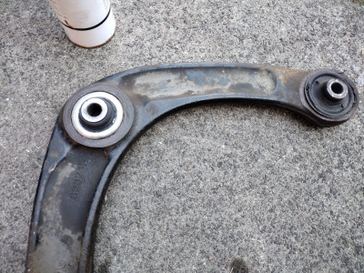

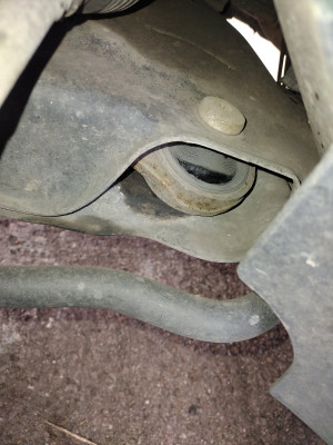

Wishbone bush job underway, a few pictures and description:

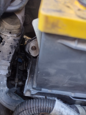

Battery tray removal.

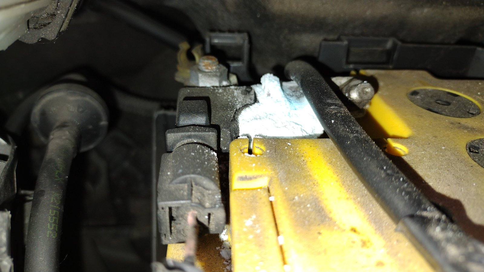

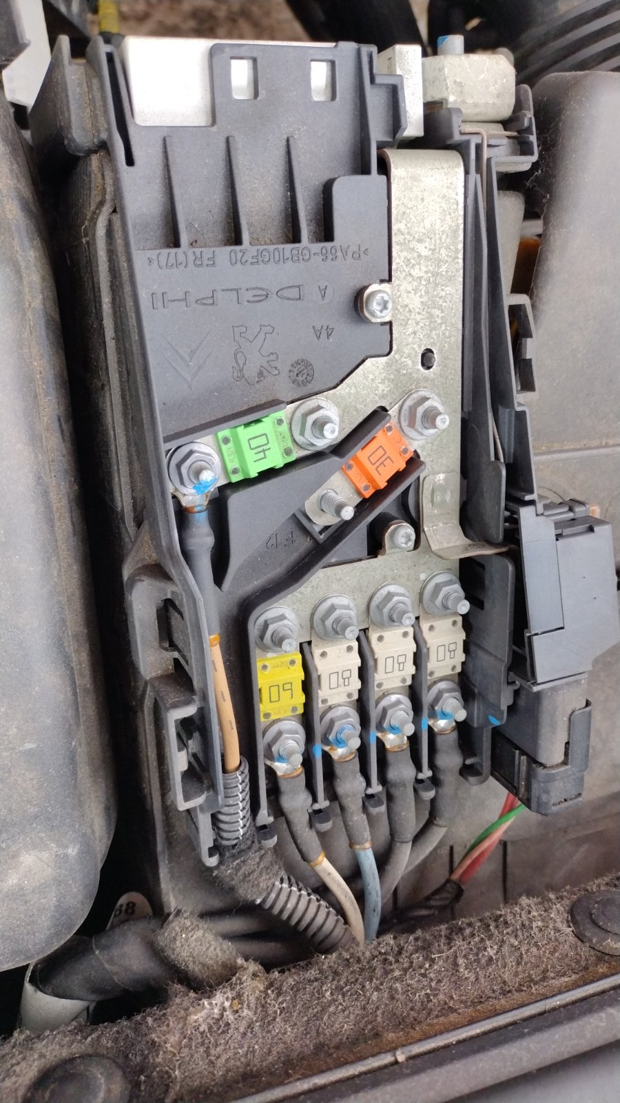

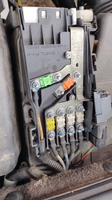

Furry terminal and can you spot something odd with these fuses? This is to clear access to the gearbox breather cap (route for refilling)
Annoyingly battery steel tray is held with 5 fixings: 4 accessed from engine bay, the last from the wheel arch, needing removal of the arch liner. Also found was a huge block of muck! And a fair bit of surface rust: sanded with powerfile and phosphoric acid applied. Paint to follow. Gearbox magnetic drain plug had small hedgehog, gearbox oil pretty dark but not horrendous. New Chemoil stuff (fully synthetic, 20 litres, eBay, bought a while back) to go in. Gearbox drain plug is 10mm square drive only (no outer hex)

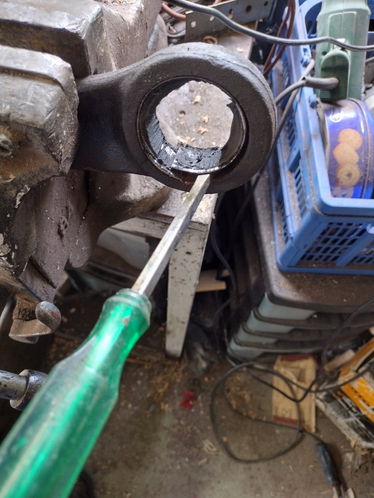

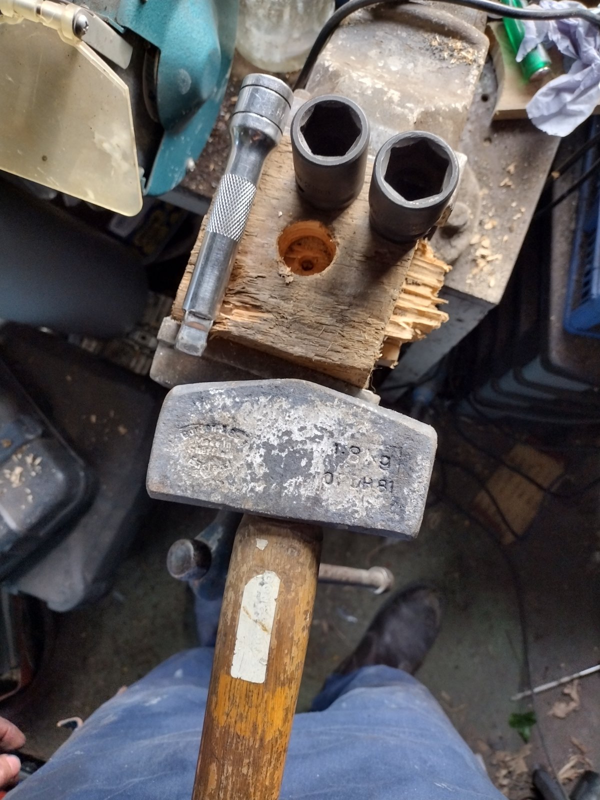

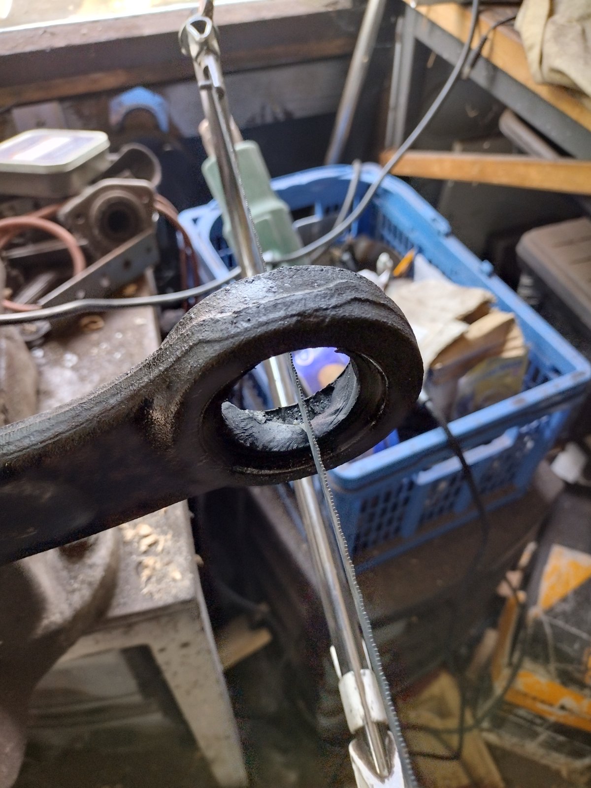

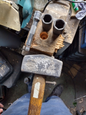

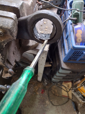

Wishbone bush removal via "puller set" which is supposed to work by threaded rod. Keep trying this technique on various car replacement tasks but just keep bending the rods!! This time I did manage to use it with threaded rod: to forcibly rip the old rubber bush out if it's steel outer shell. Shell then slitted with hacksaw and curled in in itself to remove.

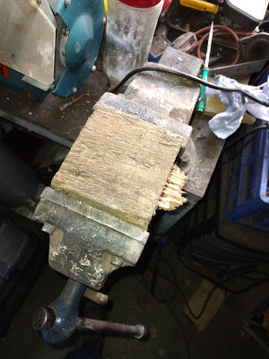

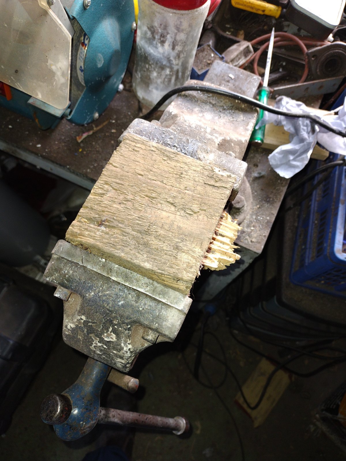

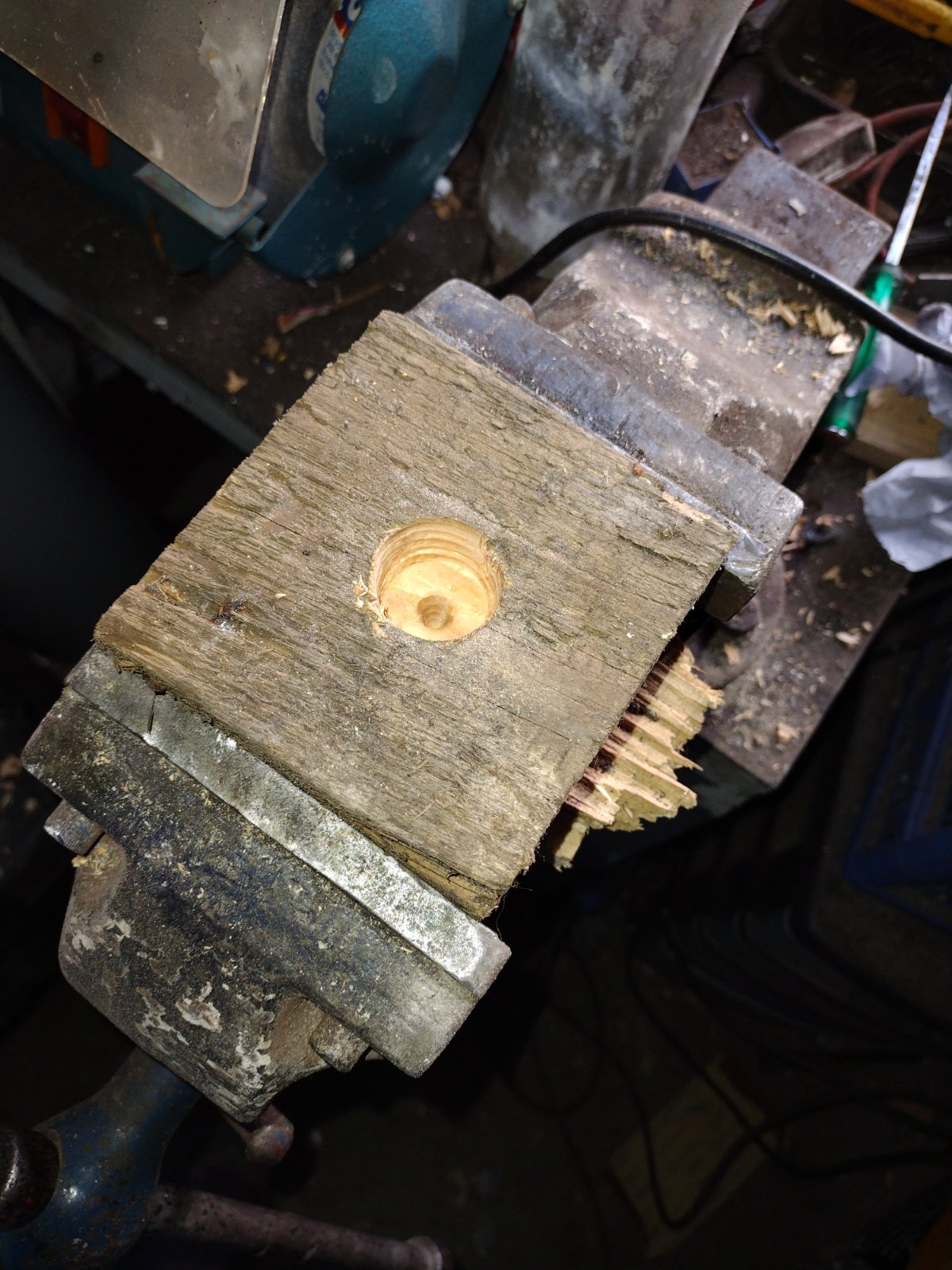

Bore of wishbone and outer diameter of new bush smoothed with Dremel type tool and flap wheel. Both liberally copper greased and new bush pounded into place with big hammer and 1 of the puller set pieces.
So big hammers saved the day again!

Nut missing on the 30A

Be interesting to know what that 30A feeds as presumably it may have had intermittent interruptions according to suspension movements?

Don't think it needs 30 amps but I've got a huge hope that it is the rear parking sensors (which are very intermittent!)mickthemaverick wrote: 16 Jun 2024, 15:16 Be interesting to know what that 30A feeds as presumably it may have had intermittent interruptions according to suspension movements?![]()
Surprisingly no sign of arcing on either the fuse terminal or threaded stud, so perhaps doesn't typically see anything near 30 amps (so fingers crossed again for rear parking sensors!!) F12 is it's number will dig into function later

Wishbone rebushed and reinstalled.

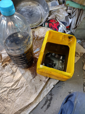

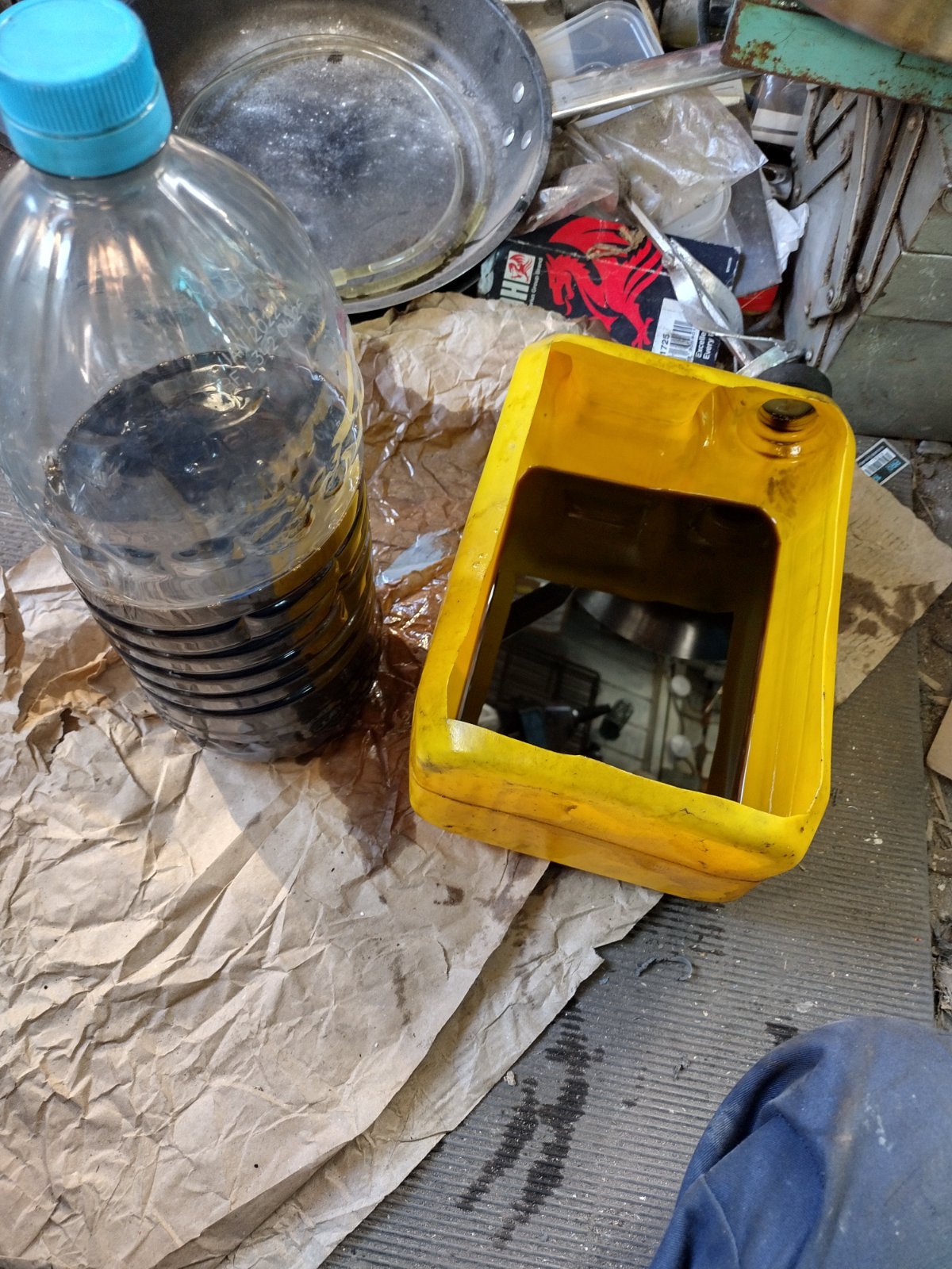

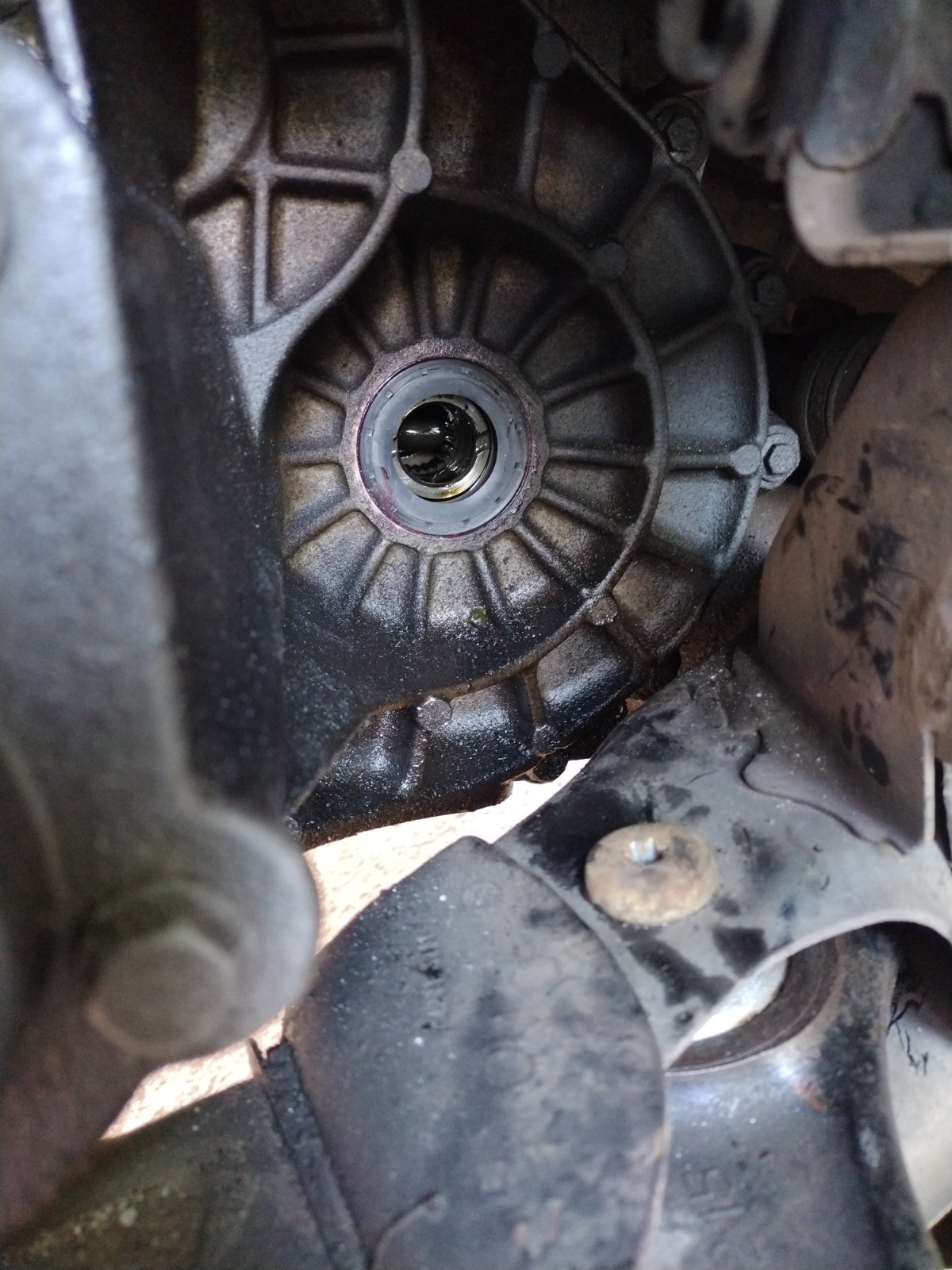

Gearbox oil reinstated - 2.1 litres says Haynes, so that is what has gone in. Interestingly I measured what came out: about 2.4 litres, a good 300 ml overfilled if Haynes is correct.

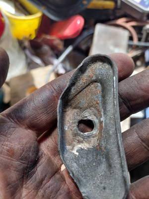

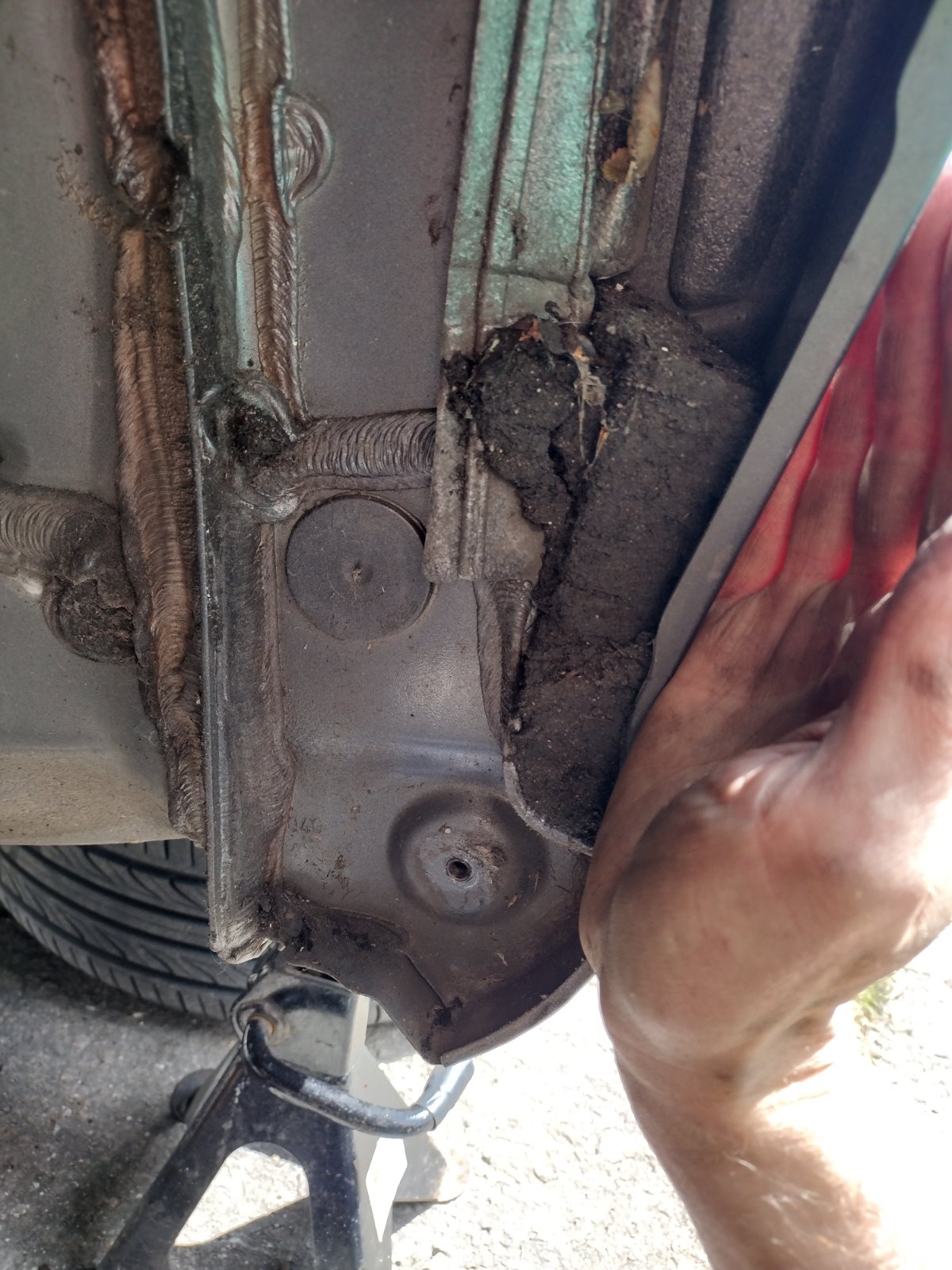

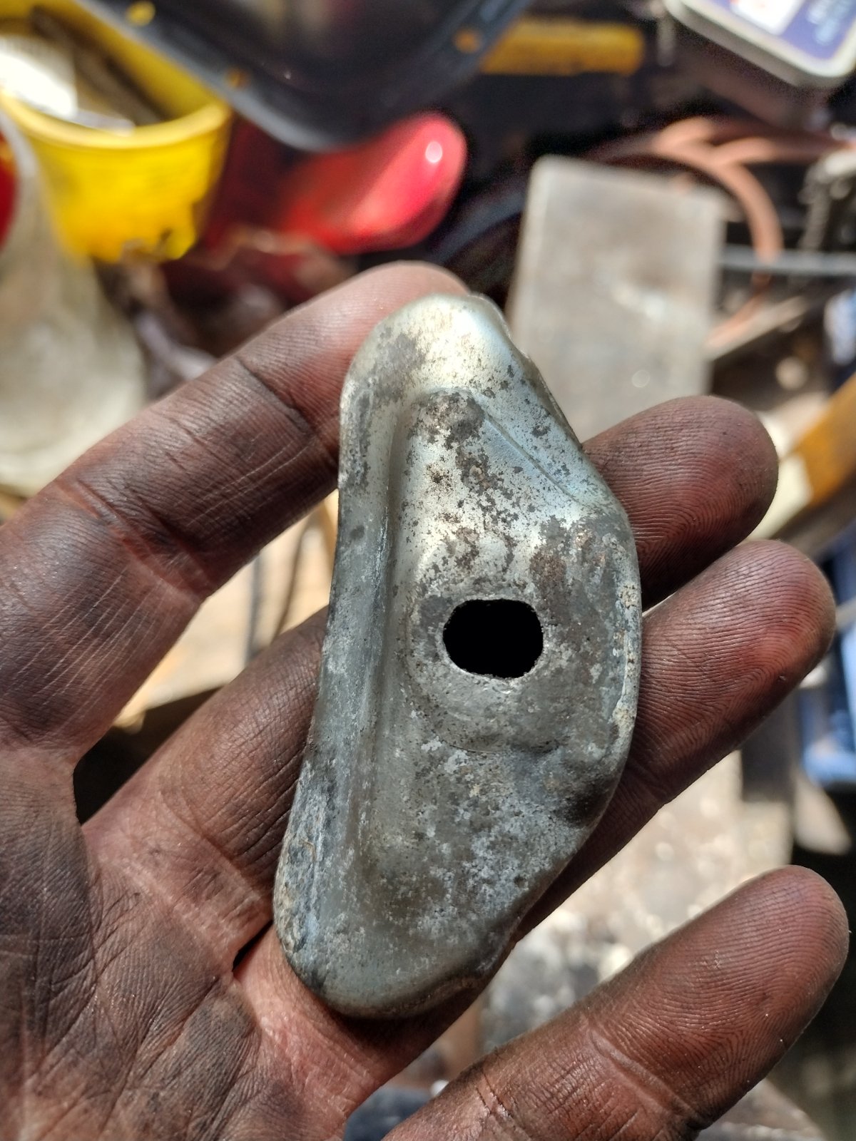

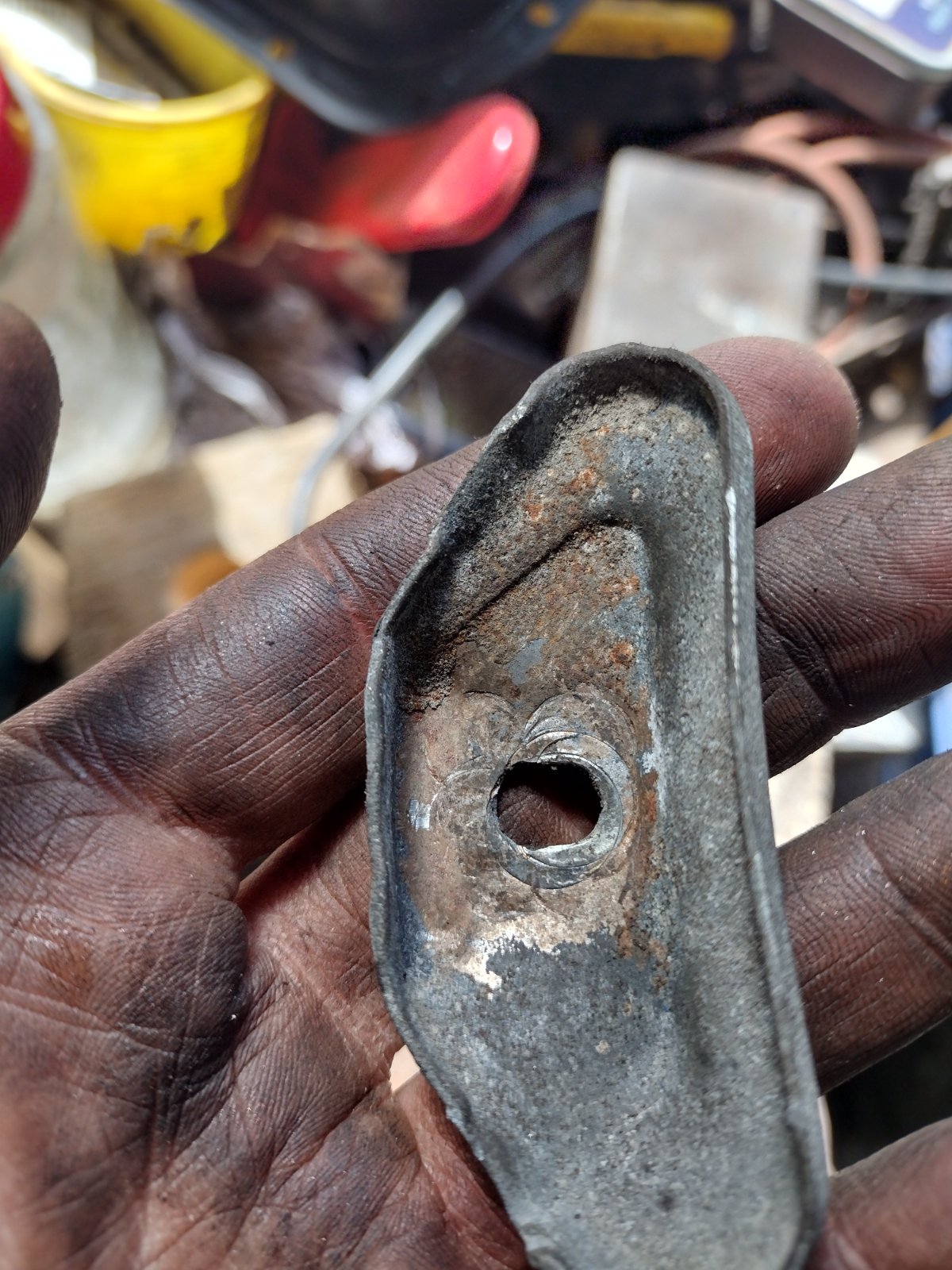

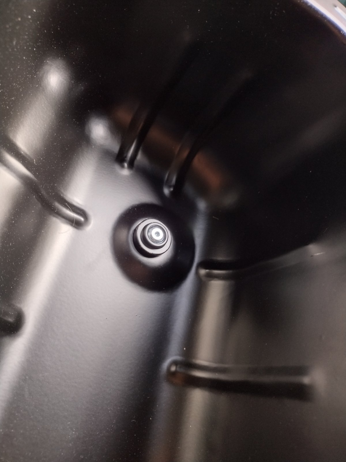

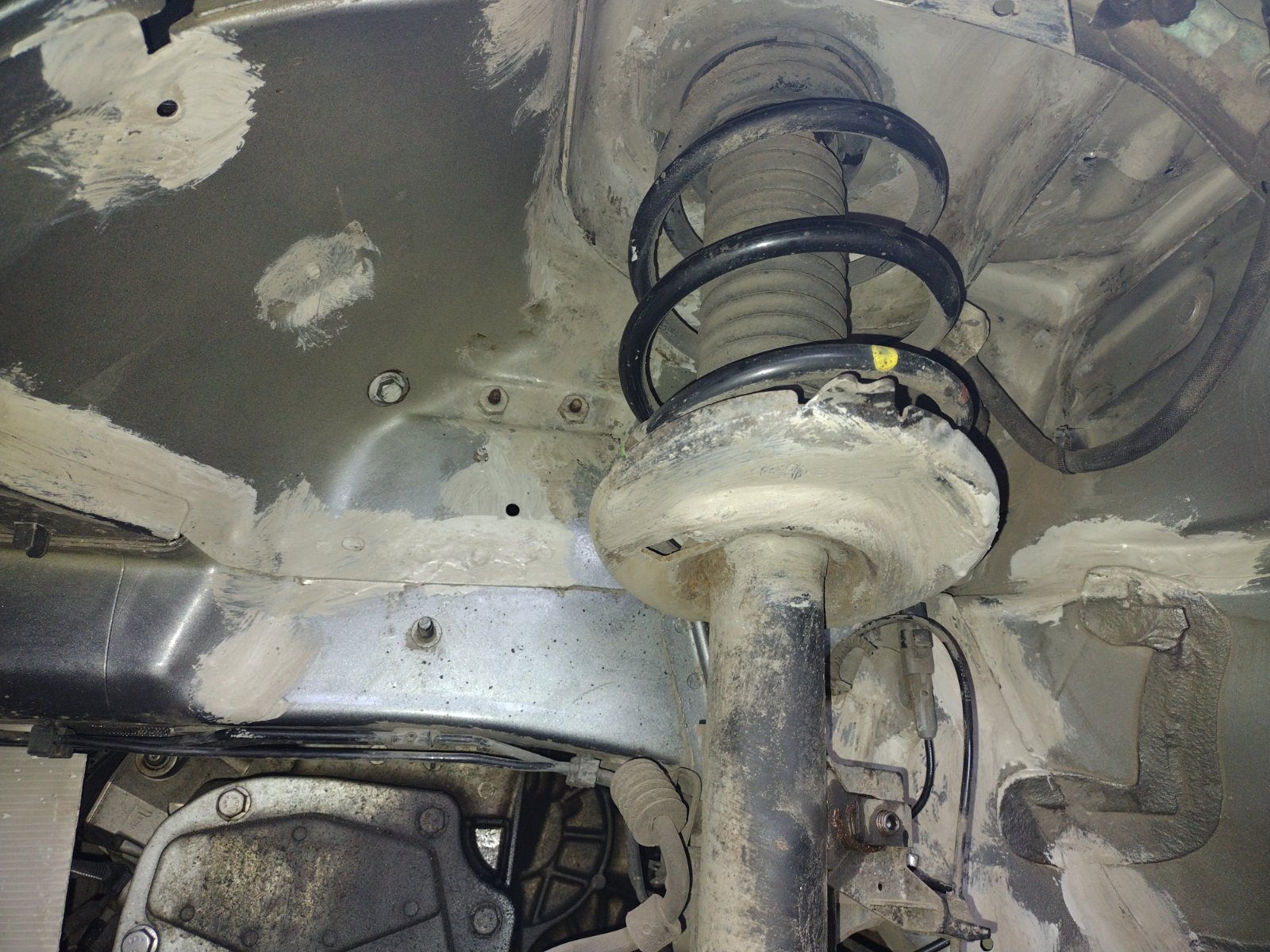

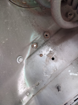

Quick reshaping with hammer and punch
Bit of primer on the treated wheel arch rust spots, off out to get some underseal on them before I pack in for the day

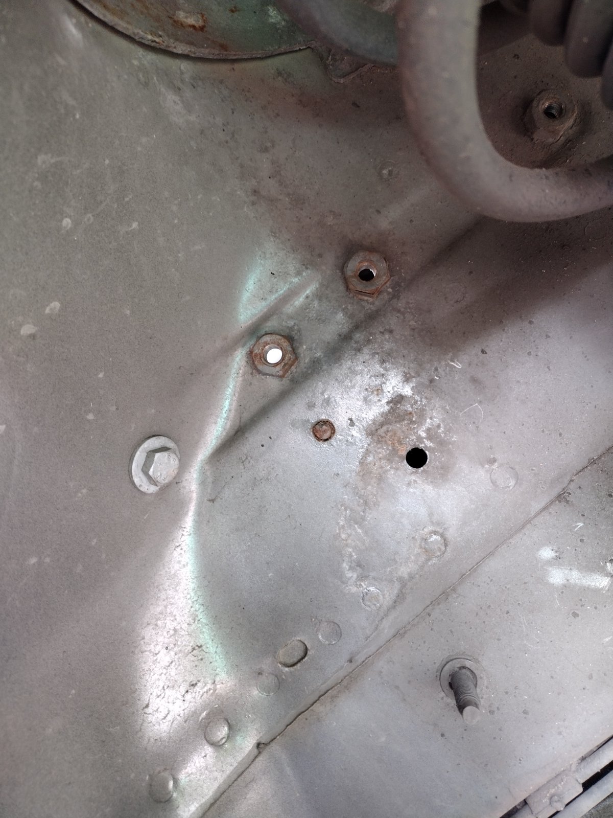

Final image from yesterday:
Daubs of metal primer brushed on the treated rust spots. The whole arch was painted with Tetroseal but no picture: black wheel arch pictured in failing light - wouldn't really show anything.

308 SW:
Wishbone bushes replacement (front left, passenger side only at present) has cured the suspension knock.
