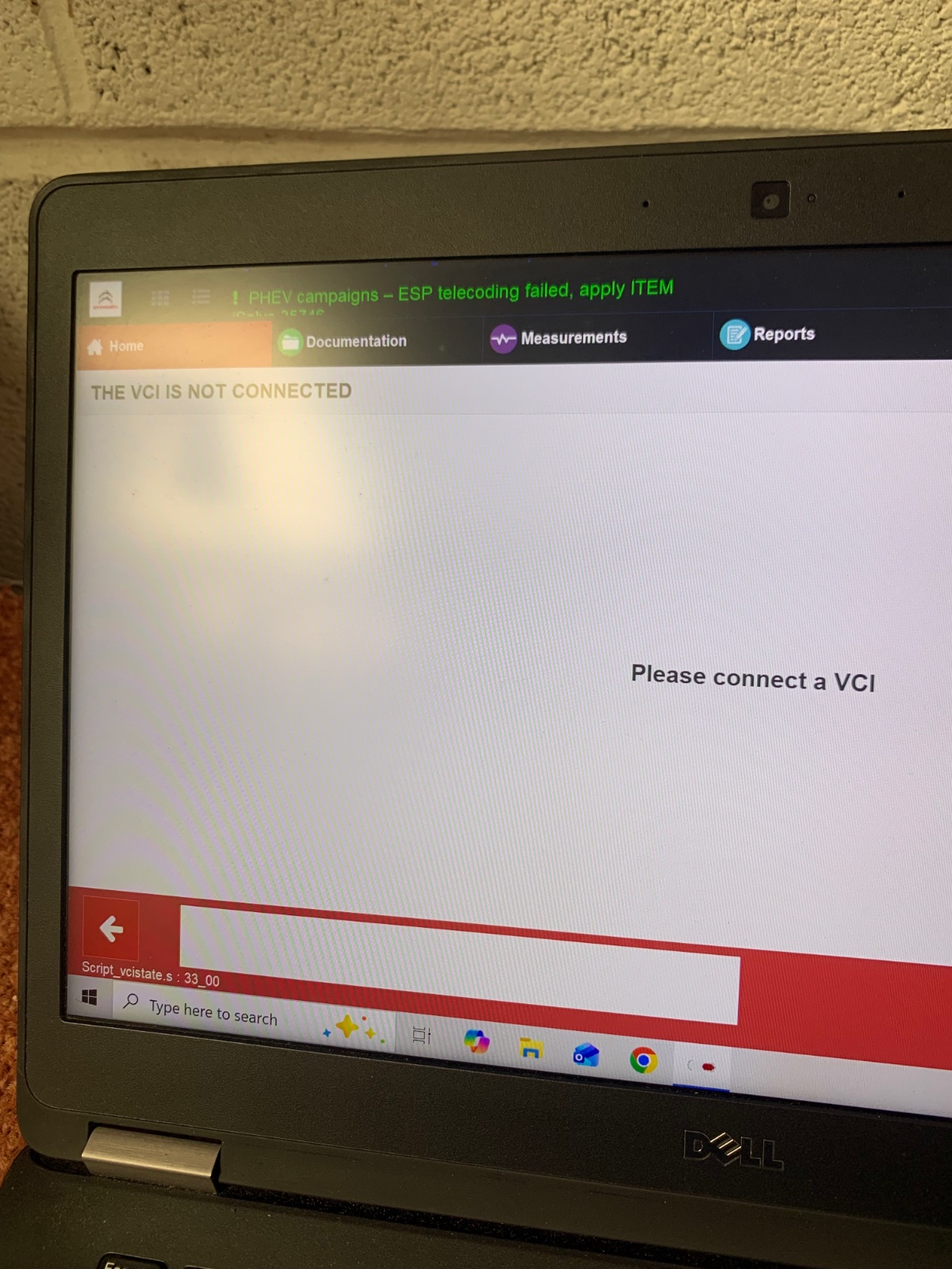

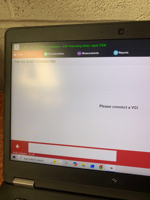

Ive tried two laptops, both on win 10 both cannot see the VCI adapter Actia

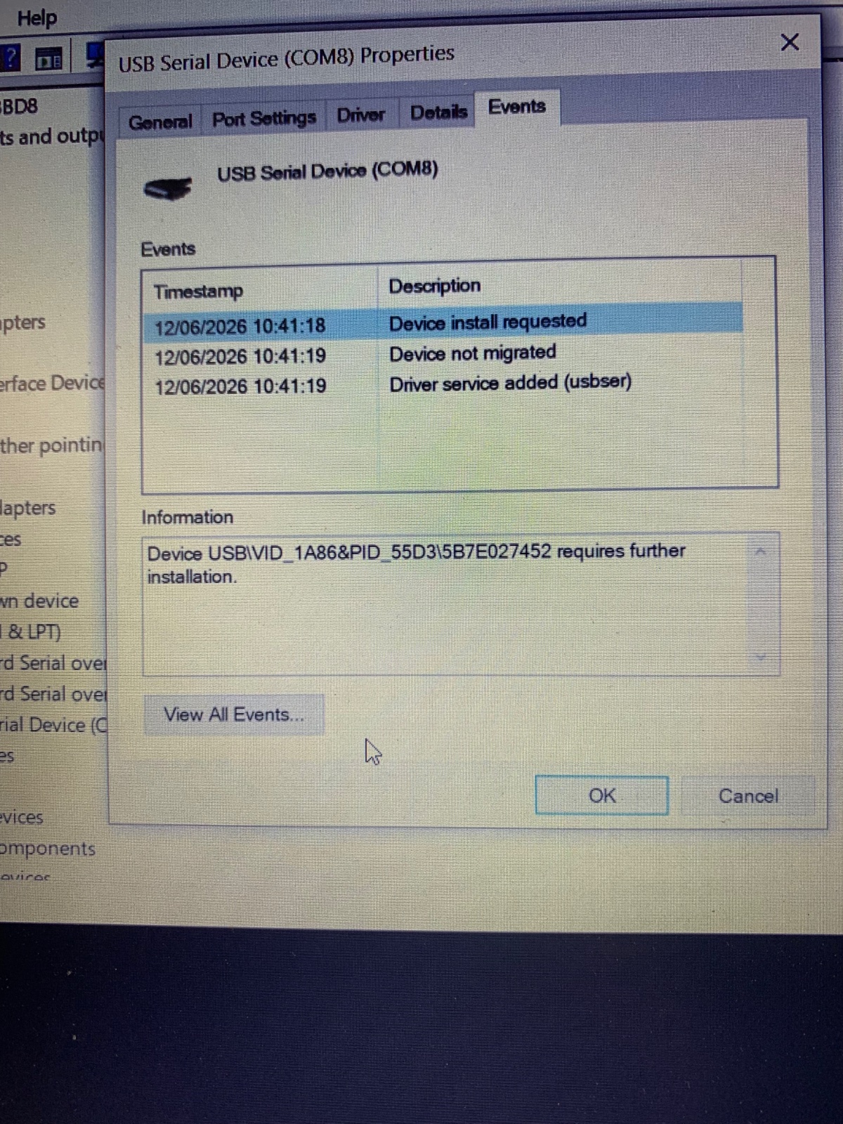

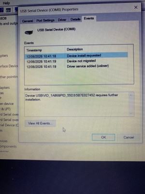

Unread post by gsc1ugs »
Software runs VCI wont connect even though device manager says ready to use but digging further says requires further installation see pic drivers came with it actia says installed ready to plug device still nothing

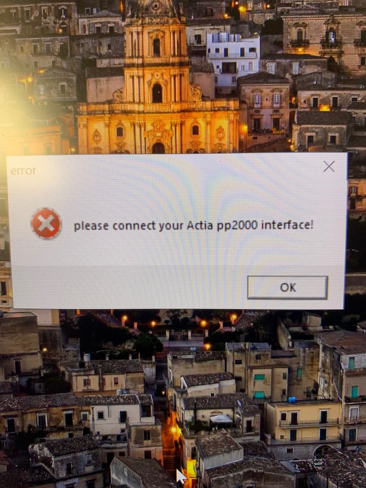

More errors

Unread post by Paul-R »
PP2000 operation requires installation of Diagbox in a 32 bit environment. Could this be a reason even inside a VM?

Trickiedickie wrote: 13 Jun 2026, 10:28 I use Diagbox 9.186 on Windows 10 Pro 64bit. It's a proper install not a VM. Works perfectly.
It will do on vehicles that require Diagbox. It's only if the vehicle is elderly (think Xantia, Mk1/Mk2 C5, Xsara) and needs PP2000, or in these Citroen examples Lexia, that a 64 bit environment is a problem.

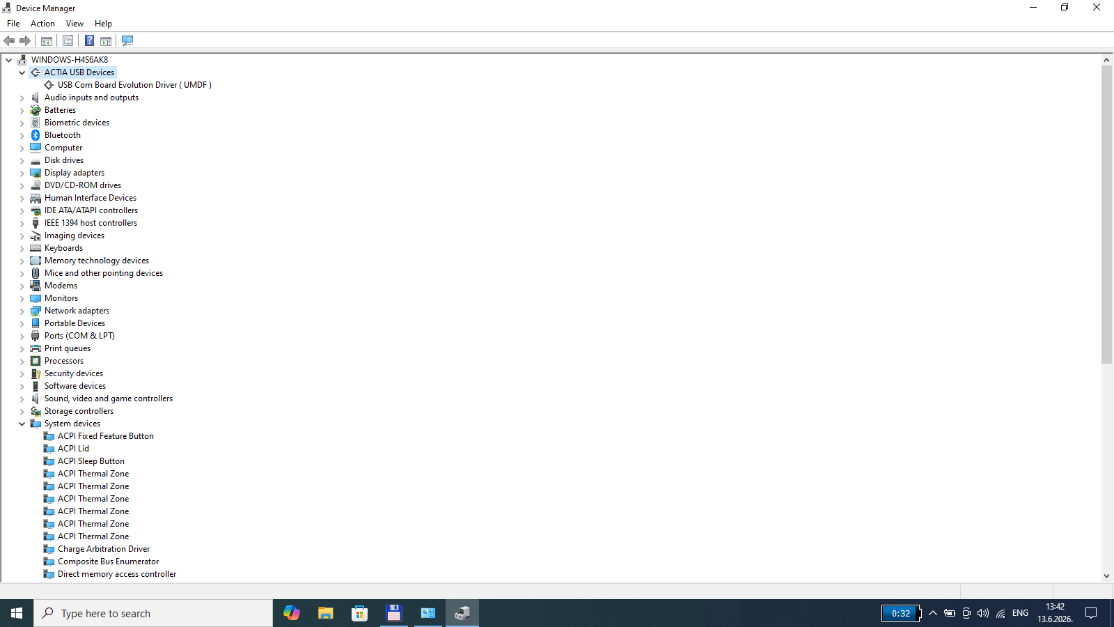

Re: Diagbox 9.85
Unread post by Mihael_M »
I asked you which device - cable you use. If you have Lexia 3 Full chip then you need to use ACTIA Drivers which are installed when installing diagbox 9.85. If you look in the drivers manager and connect the Hardware (Lexia 3 cable) you will see the ACTIA drivers included (you have a picture). If you don't have the drivers as in the picture, then either you don't have the Hardware Lexia 3 cable or your installation is not good. If you would show which device you have, I might be able to help further.
