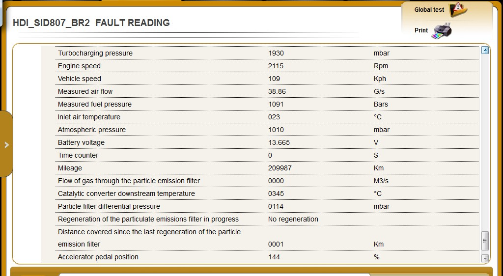

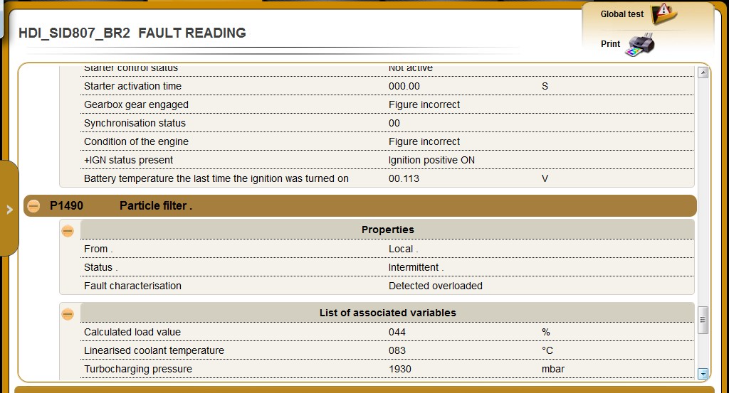

Quick summary of Diagbox session:
A few other interesting faults will describe when have time.
Key one:
P1490 Particle Filter:
Status intermittent
Fault characterisation: detected overloaded.
Associated variables:
Calculated load value 44% (not sure but think this is engine load at time of the fault)
Coolant temp 83C
Turbocharging pressure 1930 mbar
Engine speed 2115 rpm
Vehicle speed 109 km/HR (nearly 70 mph roughly)
Flow of gas through the particle emission filter 0000 m³/s (!?!?!?)
Cat converter downstream temp 345 C
Particle filter differential pressure 0114 mbar
Regeneration in progress No
Distance since last regen 1 km
Accelerator position 144%
I've had a quick word with her about stamping the throttle into the carpet that hard with both feet! :rofl2:

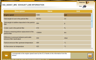

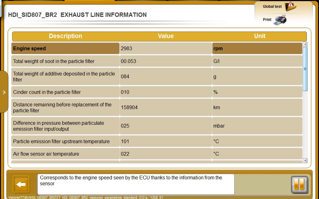

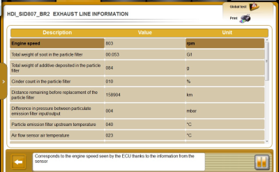

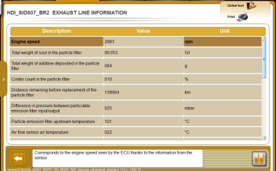

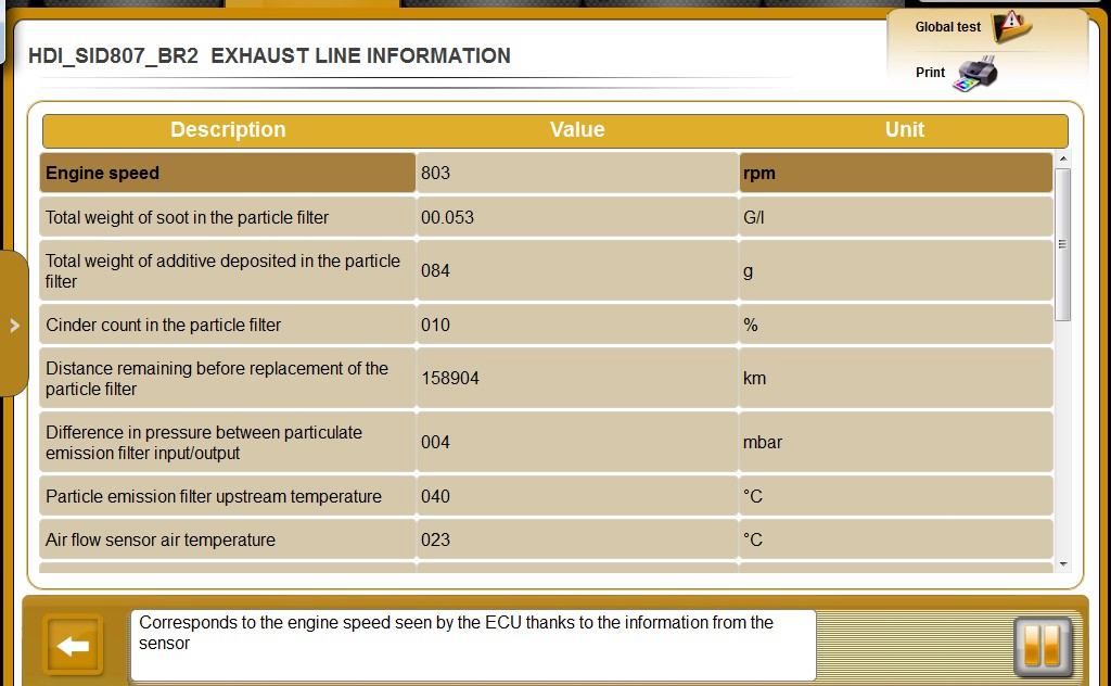

Live data readings of particulate filter differential pressure:
803 rpm, 4 mbar
1990 rpm, 9 mbar
2983 rpm, 25 mbar
Sounds blocked I guess? I'm sure I've seen acceptable mbar figures quoted, will have a dig in the morning

MattBLancs wrote: 27 May 2026, 21:38 Live data readings of particulate filter differential pressure:
803 rpm, 4 mbar
1990 rpm, 9 mbar
2983 rpm, 25 mbar
Interesting to compare these values against last set!
viewtopic.php?p=852468#p852468
When fault logged:
Particle filter differential pressure= 0202 mbar
2 km since last regeneration
Engine at 1844 rpm.
Quick test on driveway today:
At idle speed:
812 rpm
Differential pressure 015 mbar
(When car initially started differential pressure at idle was 008 mbar, higher reading was after the higher rev readings were taken)
At 1968 rpm
Differential pressure 028 mbar
At 2786 rpm:
Differential pressure 060 mbar
Last set was higher!

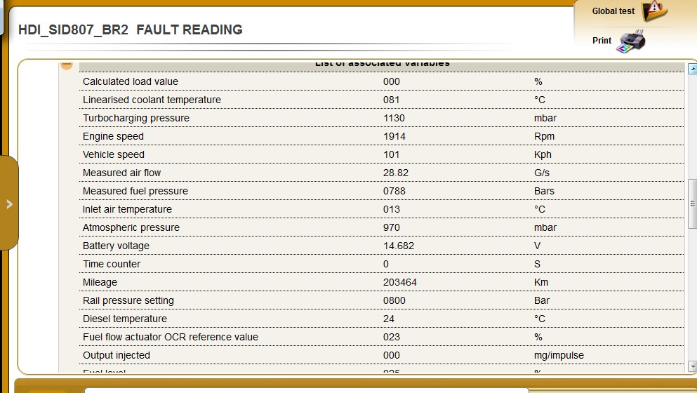

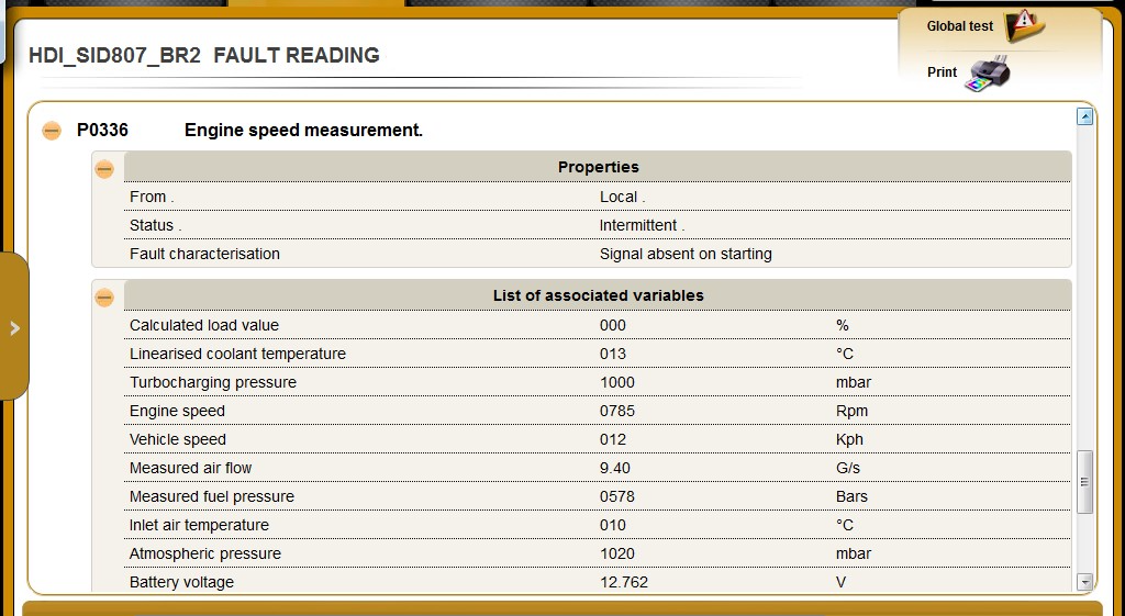

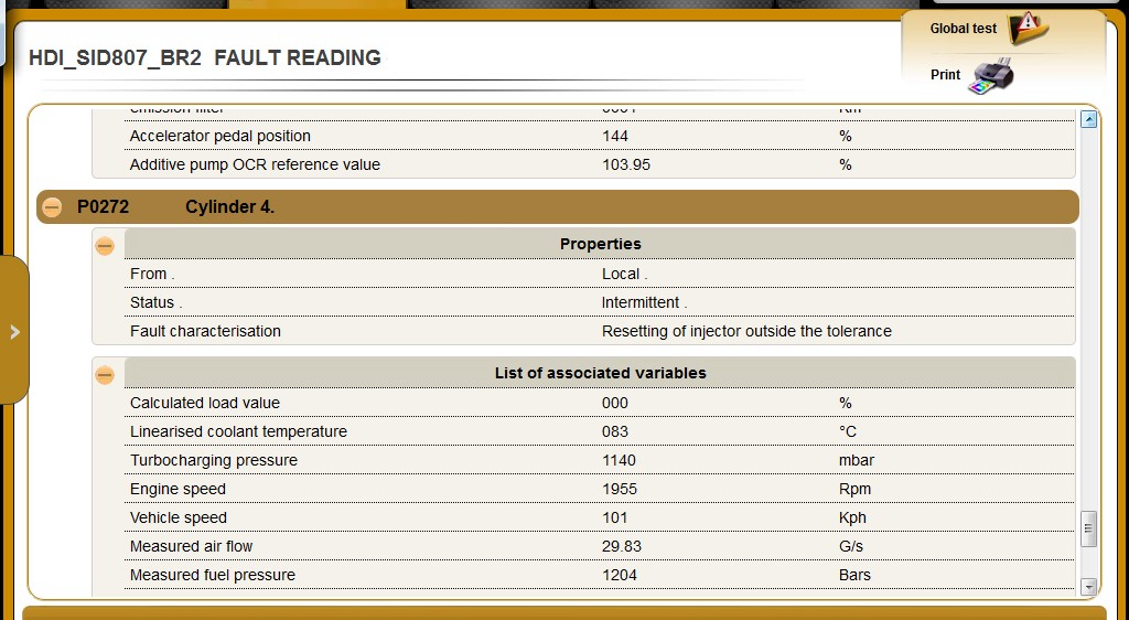

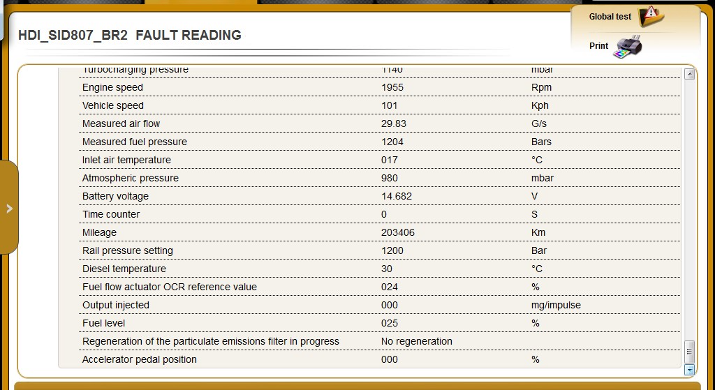

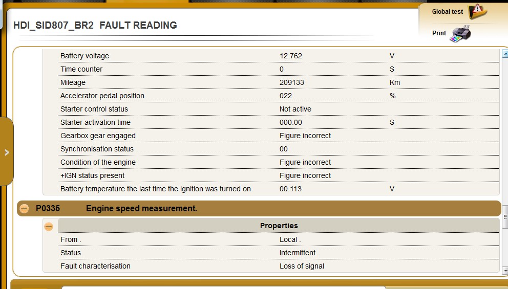

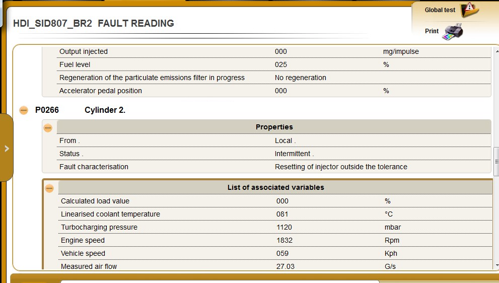

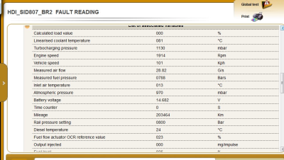

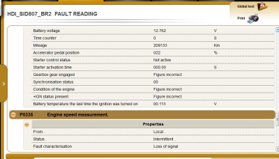

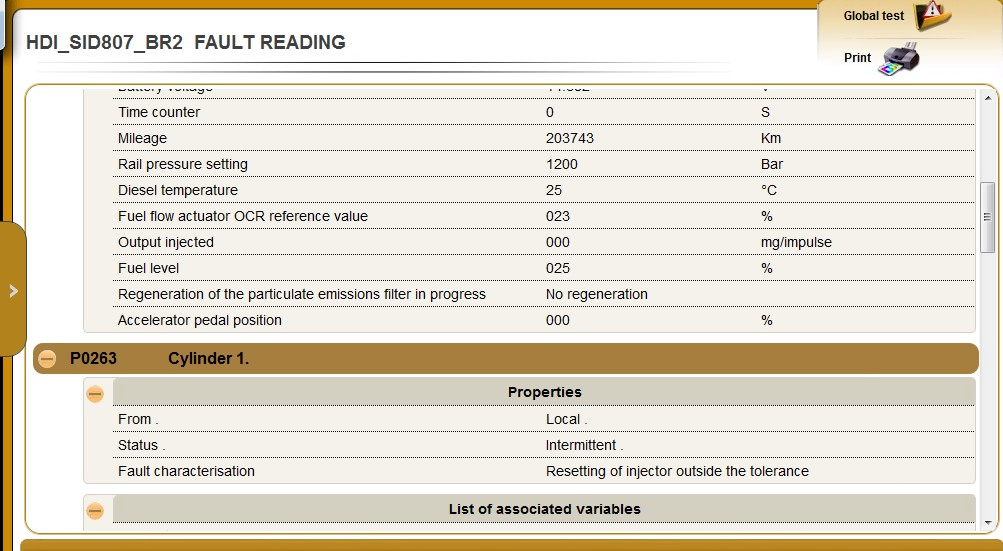

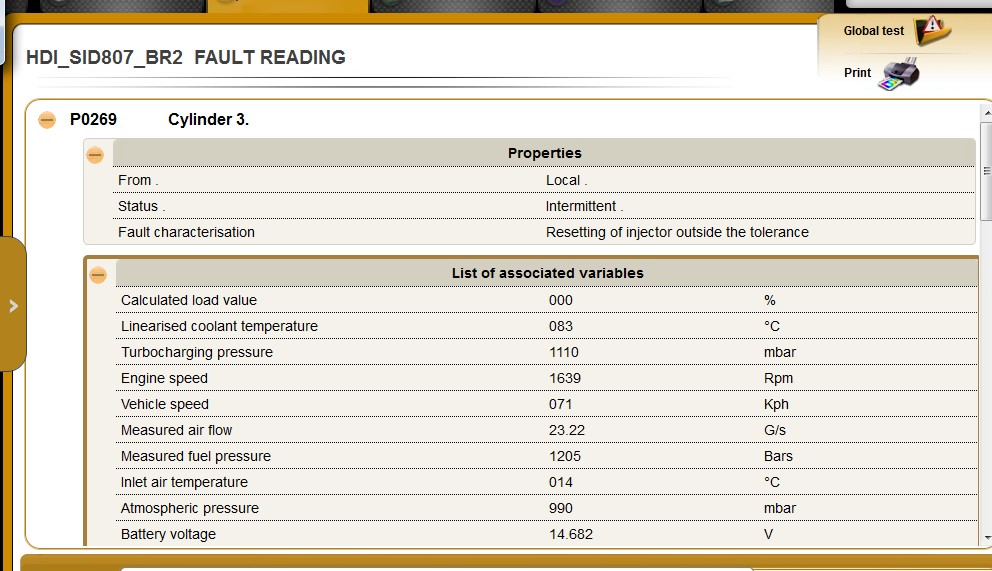

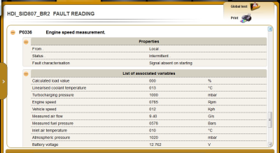

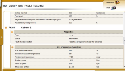

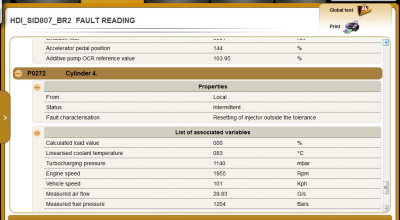

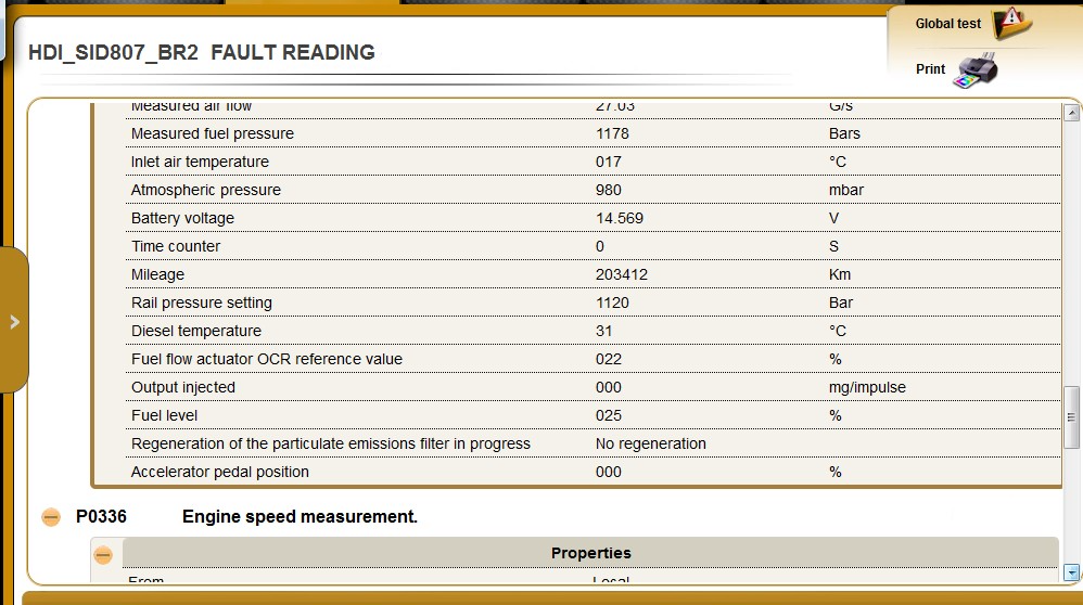

Quick upload of the faults recorded. Batch 1:

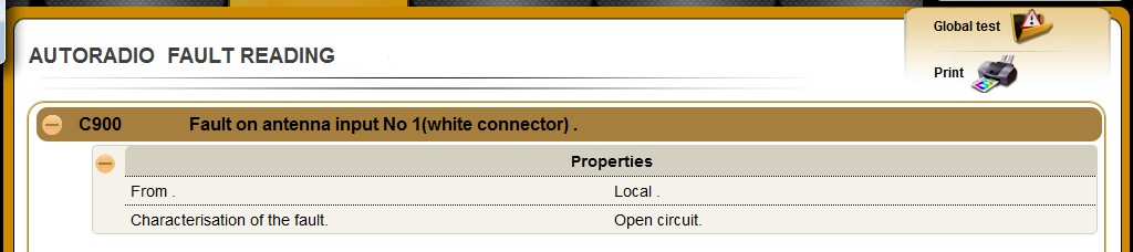

Batch 2:

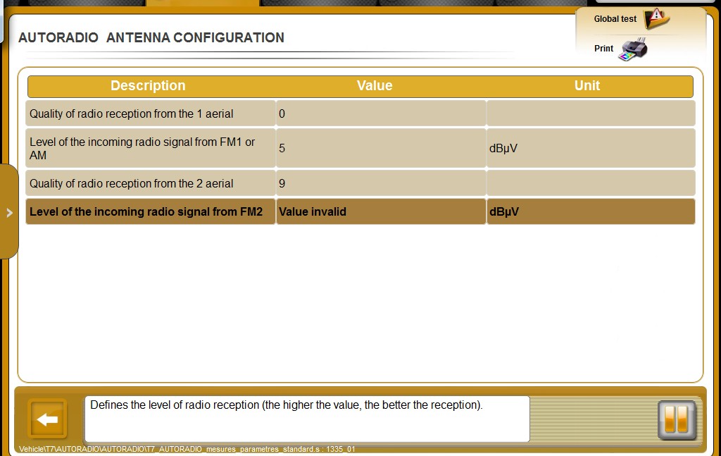

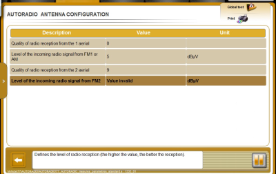

Radio aerial apparently none functional

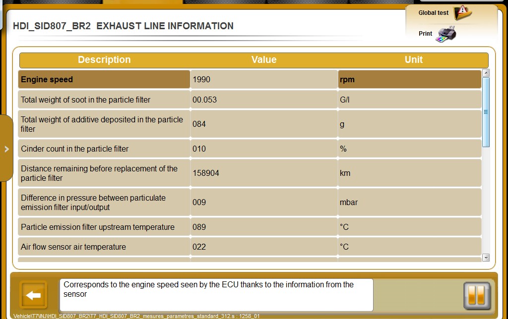

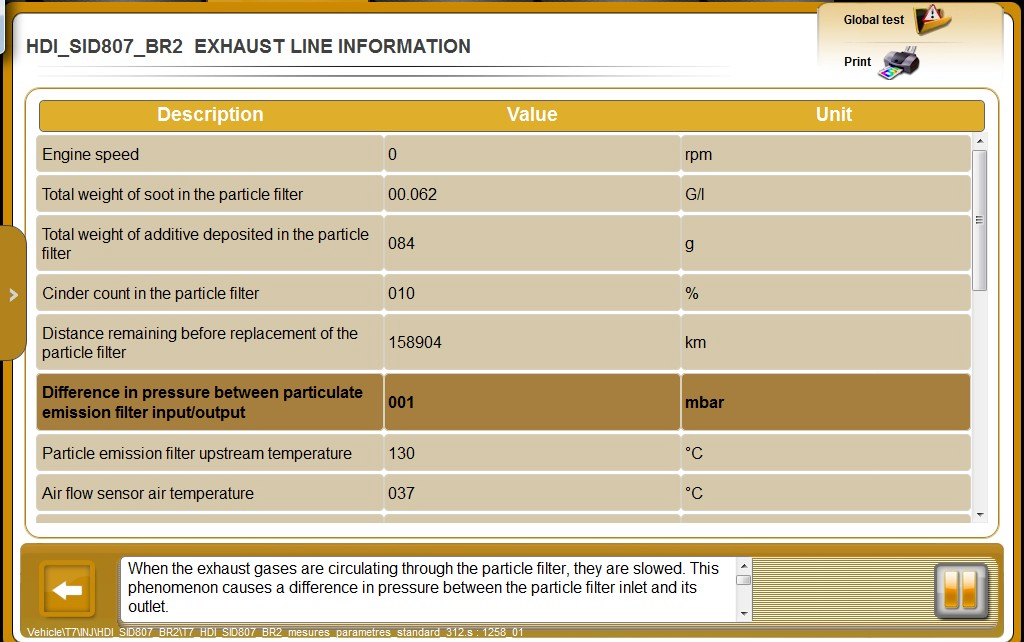

Batch 3:
DPF differential pressure readings at idle, 2000 rpm and 3000 rpm and engine off too.

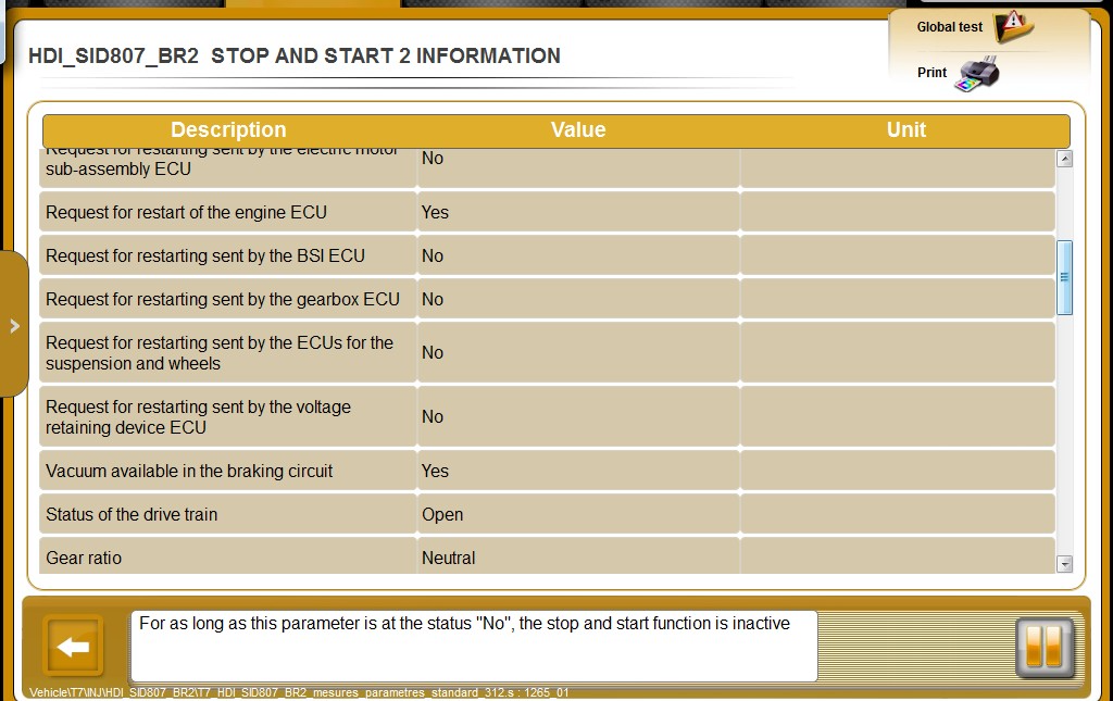

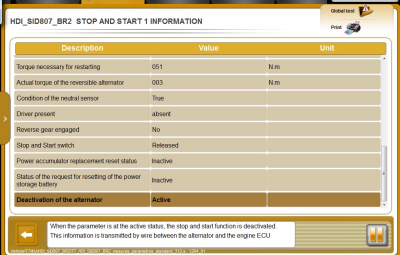

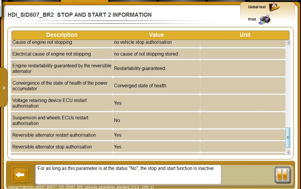

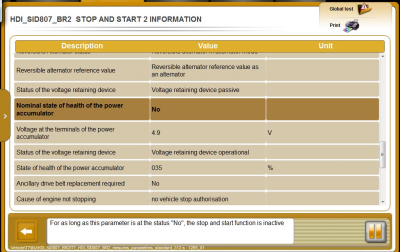

Batch 4:

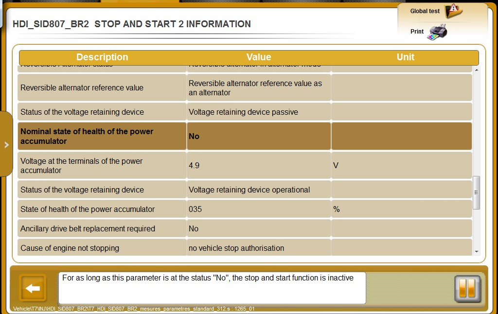

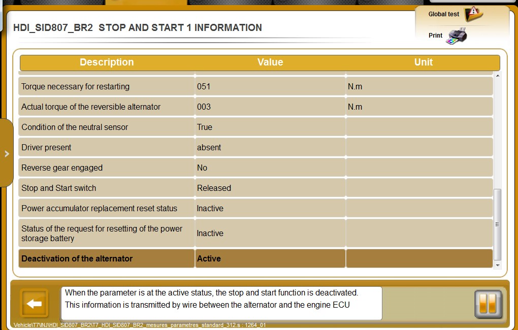

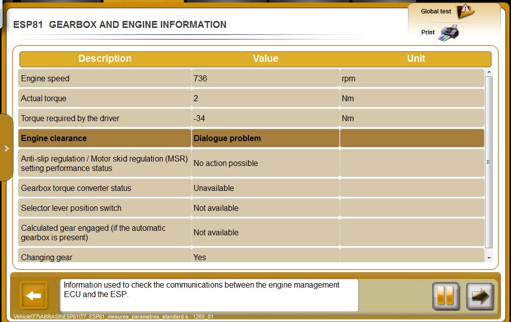

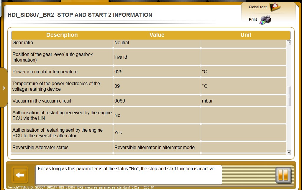

Looking at the start stop system (as it doesn't ever stop, though did, rarely, maybe a year ago)
B
B
C
C
D
D
E
E
F
F

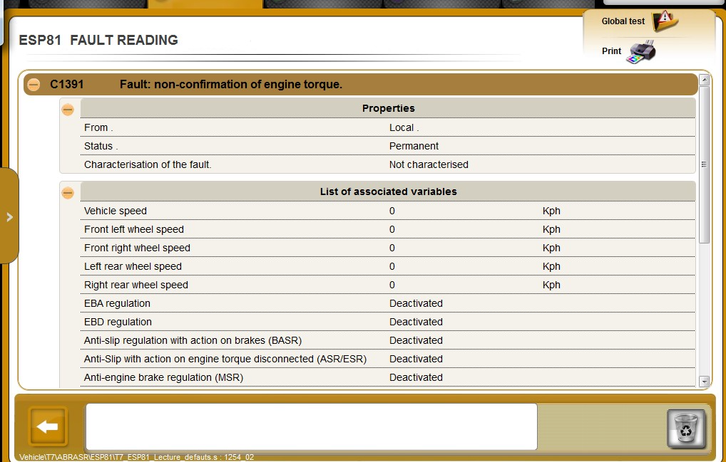

ABS fault came up, mid way through scanning (but hasn't done so in use) so had a look in there too.

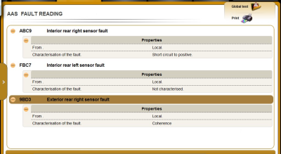

Batch 6:

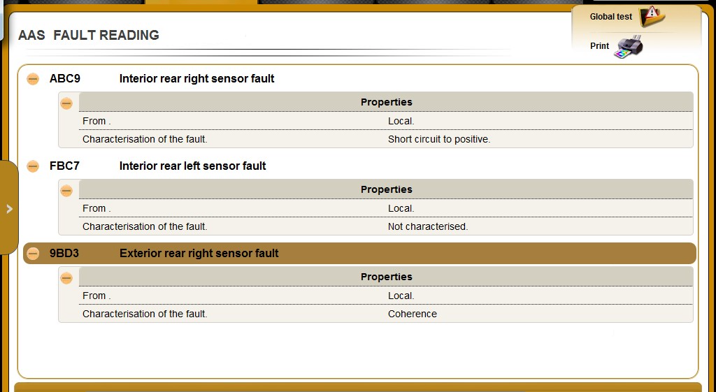

Parking sensors. Last time I scanned it one sensor was reporting a fault, I bought a replacement (Autodoc) but not fitted as couldn't recall which sensor Diagbox had flagged up. Now three different sensors with subtly different faults reported! :roll:
Will swap the "short to positive" one first: "interior right"
