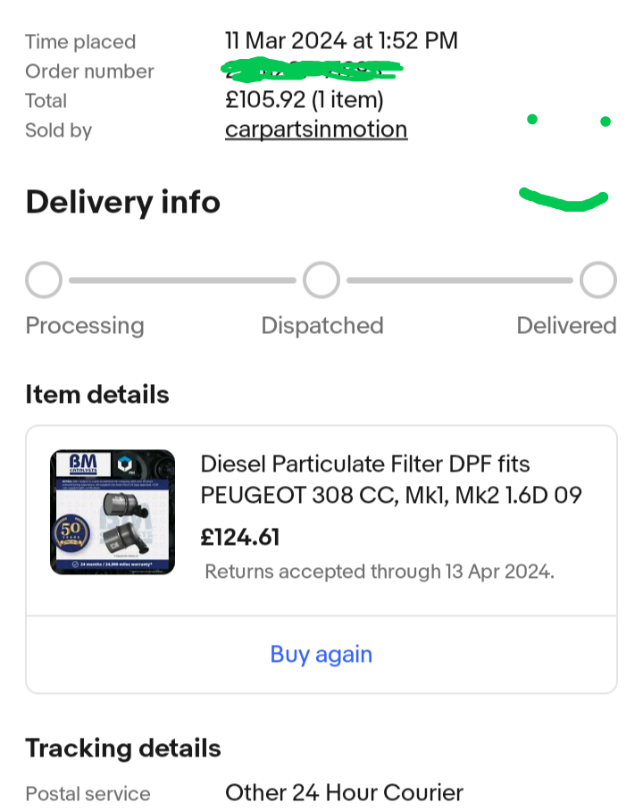

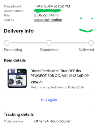

15% off voucher on top of a decent price, this now on its way here:
£106
