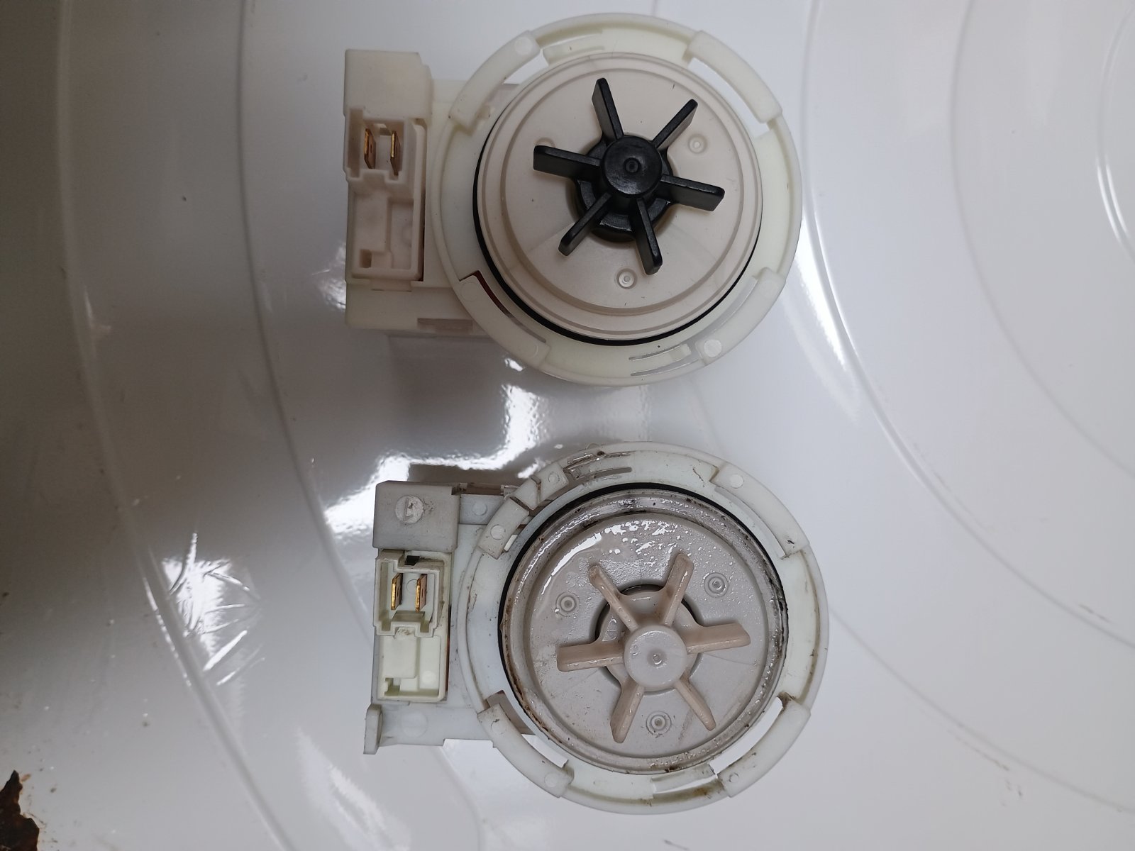

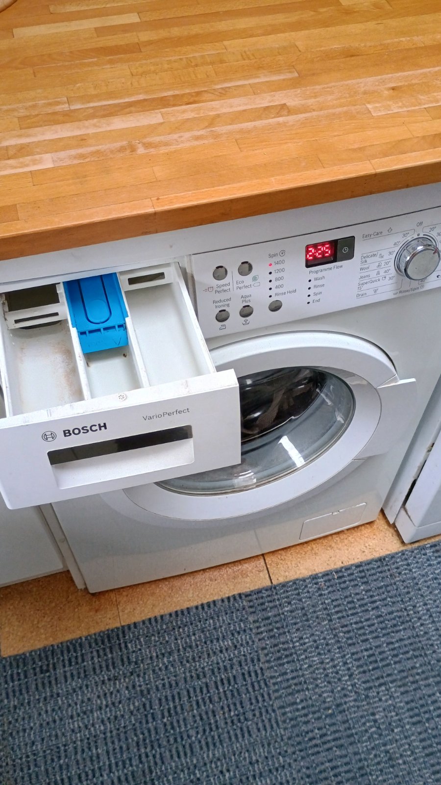

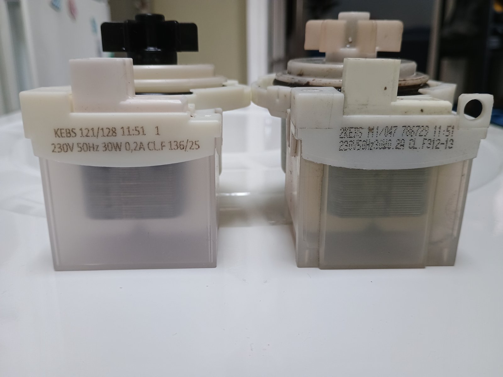

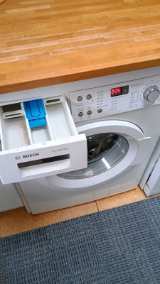

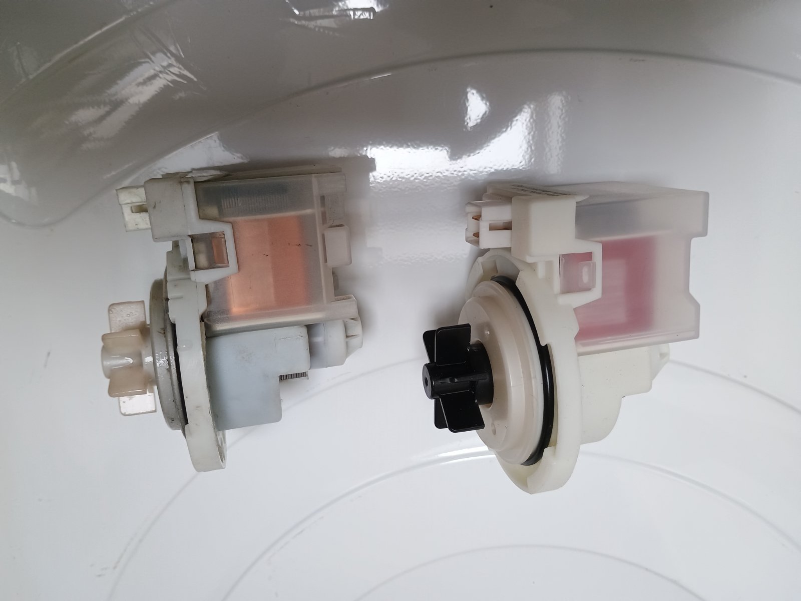

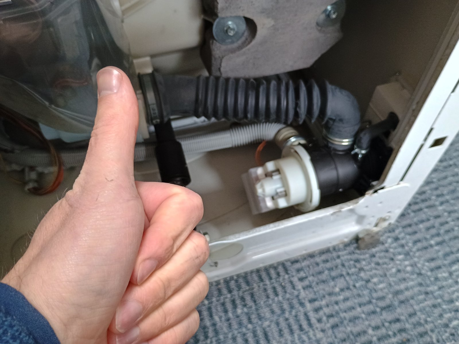

I'll let the pictures do the talking here:
Side by side comparison of old and replacement pumps:
New pump in place:

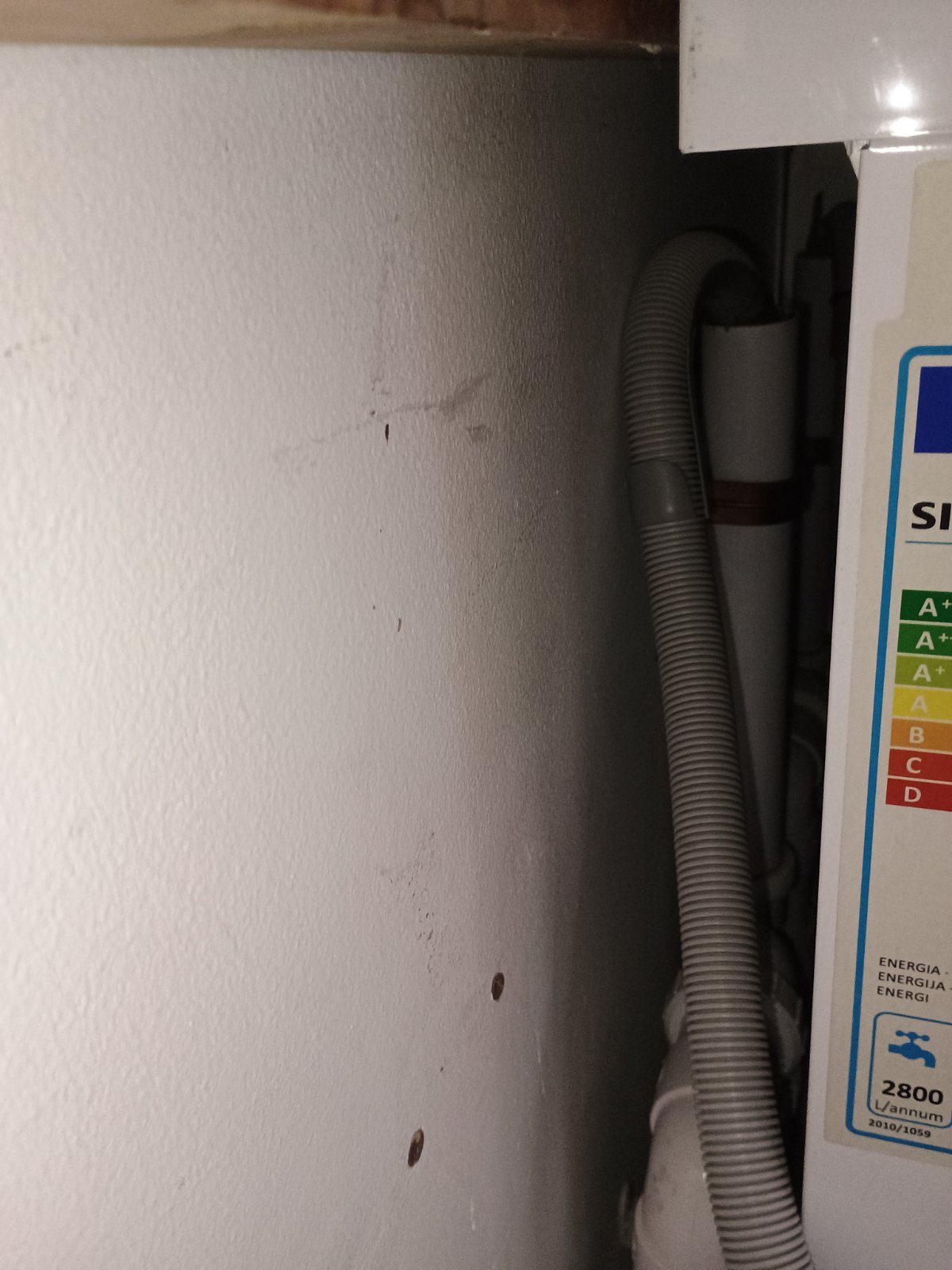

Very awkward getting behind the washer to get in it's "hole" then reaching behind the (adjacent) dishwasher to reach the drainage stand pipe.
Back into place and a test wash completed = success!
Hurray! :)

Similar machine to mine but a completely different pump. Did mine a few years back.
Posts: 55083
x 8389
Well done Matt :D Good work!

myglaren wrote: 09 Oct 2025, 20:14 Similar machine to mine but a completely different pump. Did mine a few years back.
Yes, Bosch in their wisdom seems to have two similar pumps "three tangs" and "four tangs" (mine is a four) but more widely there's a plethora of different types. Standardisation: nope!
Also points for "more awkward than it needed to be"
Pump electrical connector points forwards and the plug that feeds it clashes with the pump housing outlet pipe. So you have to unplug the electrical connection first, reconnect it last. Which would be no issue but for it facing away from you - perfect for access from the side (which is not removable) rather than the bottom (where pictures taken from) can you clock it round towards you? Nope. Loads of room around it but a faffing about blind job for no obvious reason :-D

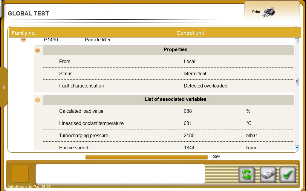

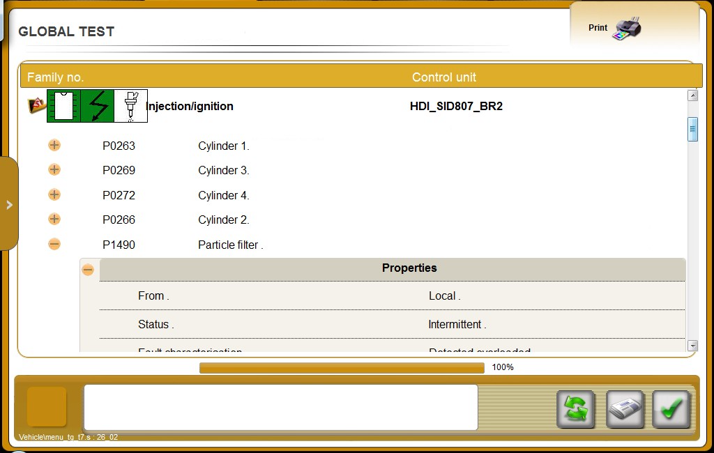

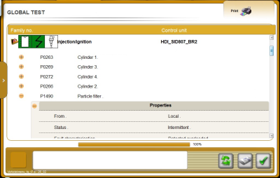

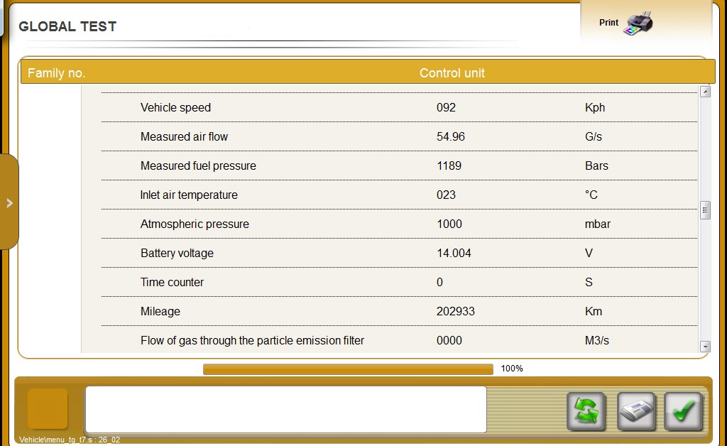

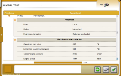

A few faults logged,
cylinder number one
cylinder number two,
cylinder number three
cylinder number 4 and
particle filter,
Particle filter fault logged at 202933 kilometers. Current mileage is 126244 which equates to 203170 km. So I guess that is what triggered the on-screen message about diesel filter on its recent commute.
Just logging all the associated values and I will post a few screenshots up shortly.
Posts: 5311
Joined: 25 Apr 2022, 09:03
x 2341
Unread post by MattBLancs »

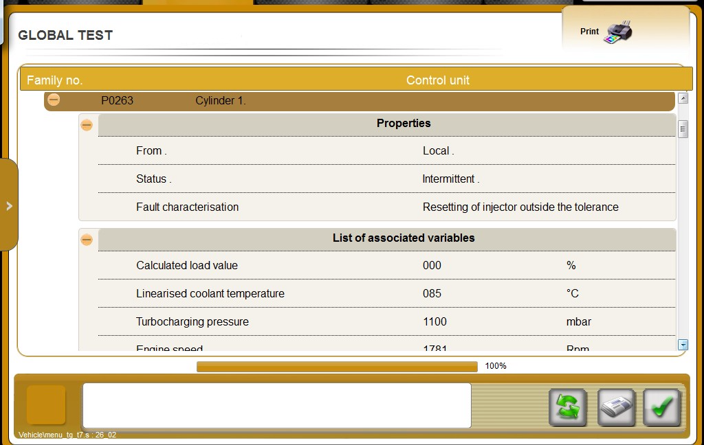

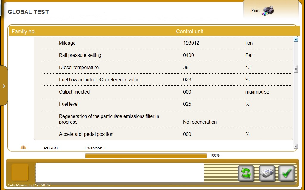

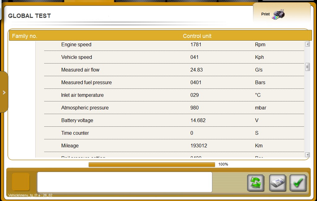

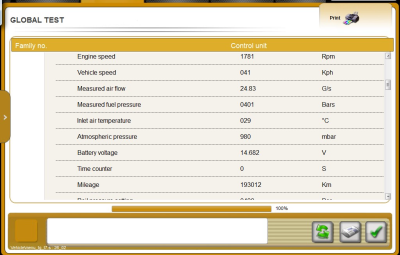

Resetting of injector outside the tolerance
P0263 Cylinder number 1 fault was logged at 193,012 km
P0269 Cylinder number 3 fault was logged at 194,013 km
P0272 Cylinder number 4 fault was logged at 192,832 km
P0266 Cylinder number 2 fault was logged at 192,667 km
Nothing particular about any of the logged values seems unusual, so I think I will just delete those and see whether they ever return.

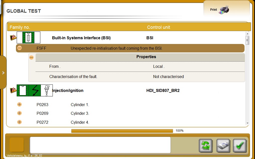

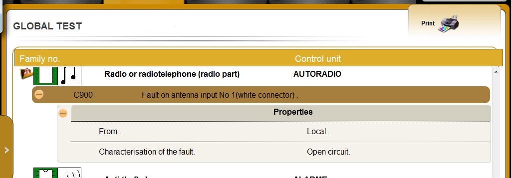

Quick dump of the Diagbox images
grey 308 12.10.2025 parameters inj exhuast info (particle filter) IDLE_030536~2.png
grey 308 12.10.2025 parameters inj exhuast info (particle filter) 2_030527~2.png
grey 308 12.10.2025 parameters inj exhuast info (particle filter) 2800 rpm_030530~2.png
grey 308 12.10.2025 parameters inj exhuast info (particle filter) 2000 rpm_030533~2.png
grey 308 12.10.2025 parameters inj exhuast info (particle filter)_030538~2.png

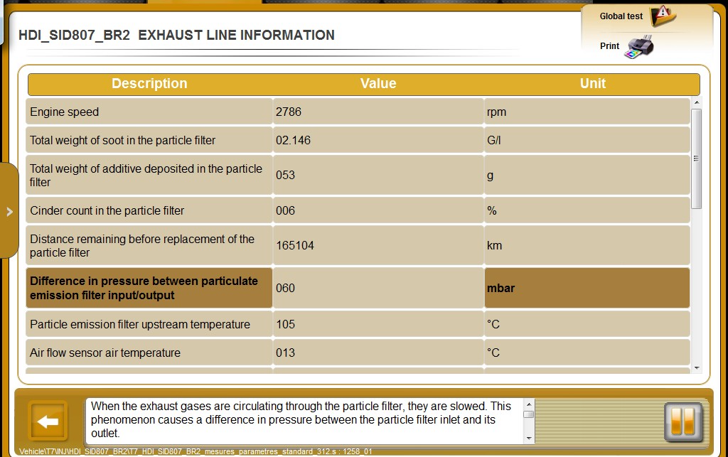

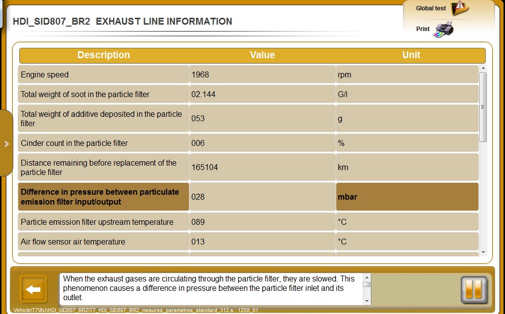

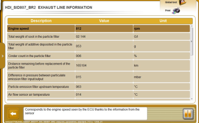

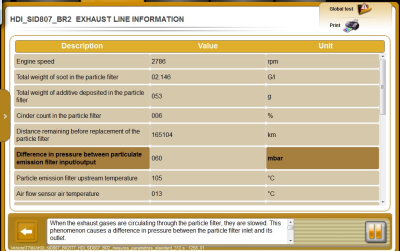

Summary of DPF readings:
When fault logged:
Particle filter differential pressure= 0202 mbar
Flow of gas through the particle emission filter 0000 m³/s
2 km since last regeneration
Engine at 1844 rpm.

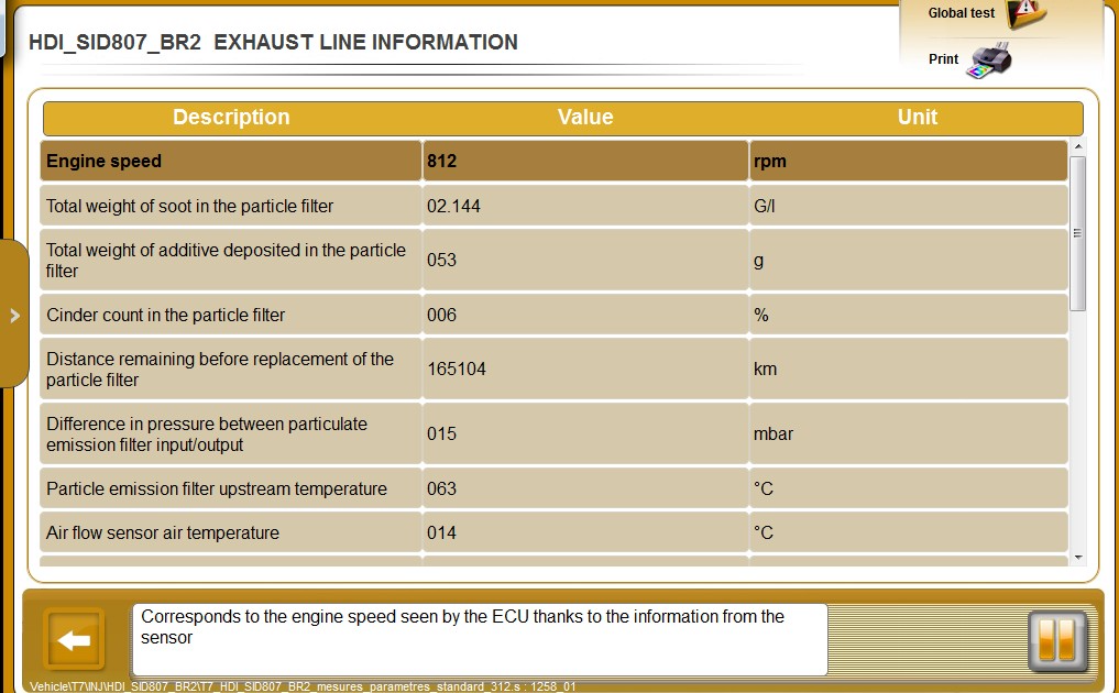

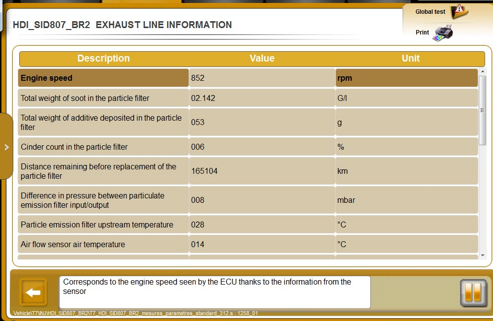

Quick test on driveway today:
At idle speed:
812 rpm
Differential pressure 015 mbar
(When car initially started differential pressure at idle was 008 mbar, higher reading was after the higher rev readings were taken)
At 1968 rpm
Differential pressure 028 mbar
At 2786 rpm:
Differential pressure 060 mbar
Both a long way from 202 mbar logged above!

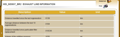

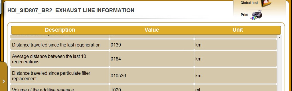

Currently 139 km since last regeneration, average of 184 km per regen for the last ten.
184 km is 114 miles = sounds a bit short, what's typical interval (I thought much less frequently than that??)
