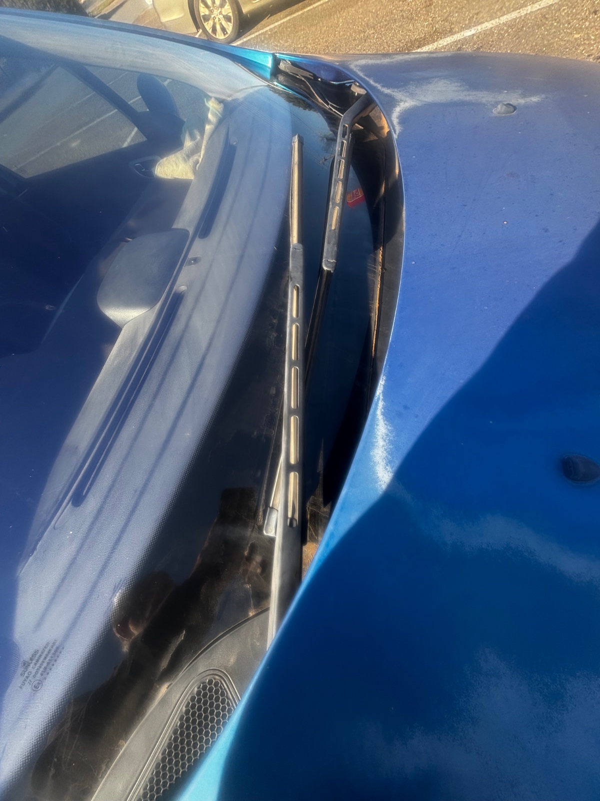

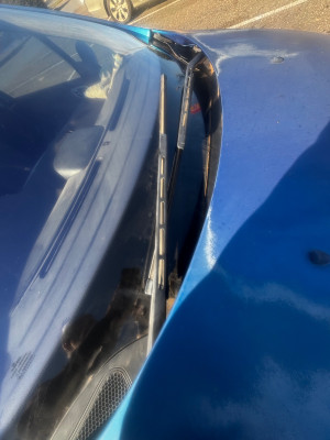

ozfrog wrote: 08 May 2026, 23:15 I think the wipers were put on in the wrong order because they are now jammed into each other. I tried to ‘unjam’ them last night, but it was too cold to stay out long enough and too dark to see properly.
If it's like the first generation 308's wipers then, for us right hand drive folks, the wipers are illogical: longer blade on the passenger side, driver (right) makes do with shorter blade.
A lazy conversion from left hand drive!

I'm not sure if I worded my comment poorly or you misunderstood what I wrote. Possibly a combination of the two. What I think is that the wipers have to go onto the car in a certain order, that is, the left-hand one has to sit either above or below the right-hand one when they are parked.
The longer wiper is certainly on the passenger side of the car. But it nearly wasn't the longer one. I thought it would break as I tried untangling the two. It was quite a mess!

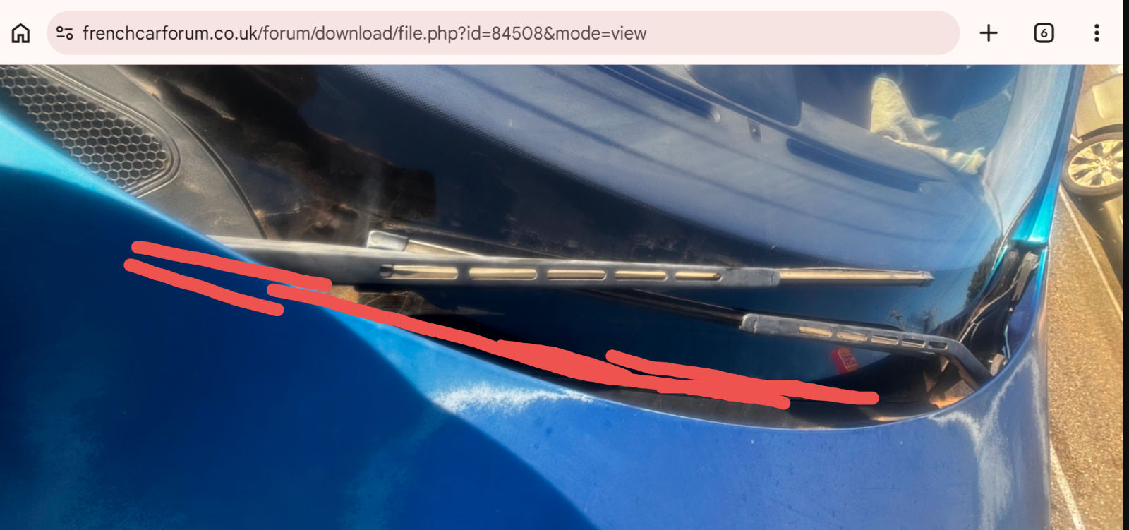

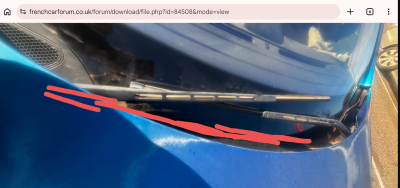

Ah, sorry - so have wiper arms as well as blades been disturbed?
Yes passenger left arm should be sat above the driver's right blade when parked at bottom of the screen.
ozfrog
(Donor 2026)
Posts: 229
Joined: 11 Jan 2025, 00:59
x 78
Re: Some puzzles for me and my 307
Unread post by ozfrog »
MattBLancs wrote: 10 May 2026, 20:38 Ah, sorry - so have wiper arms as well as blades been disturbed?[Yes.
Just like the owner. But that happened years ago.]
Then I’m correct.
The driver side one is a lot higher than the passenger side one.
Cheers,
Andrew
Posts: 5338
Joined: 25 Apr 2022, 09:03
x 2356
Unread post by MattBLancs »
Yep, that's wrong!
Loosen the nut (might be behind a cover, normally just pull off) and with a bit of a wiggle arm should come free. Worse case leverage is required (painful learning by others has confirmed leveraging against the screen not advisable) but given yours have been recently messed with it shouldn't be too seized together I'd hope.
Should be more like here:
