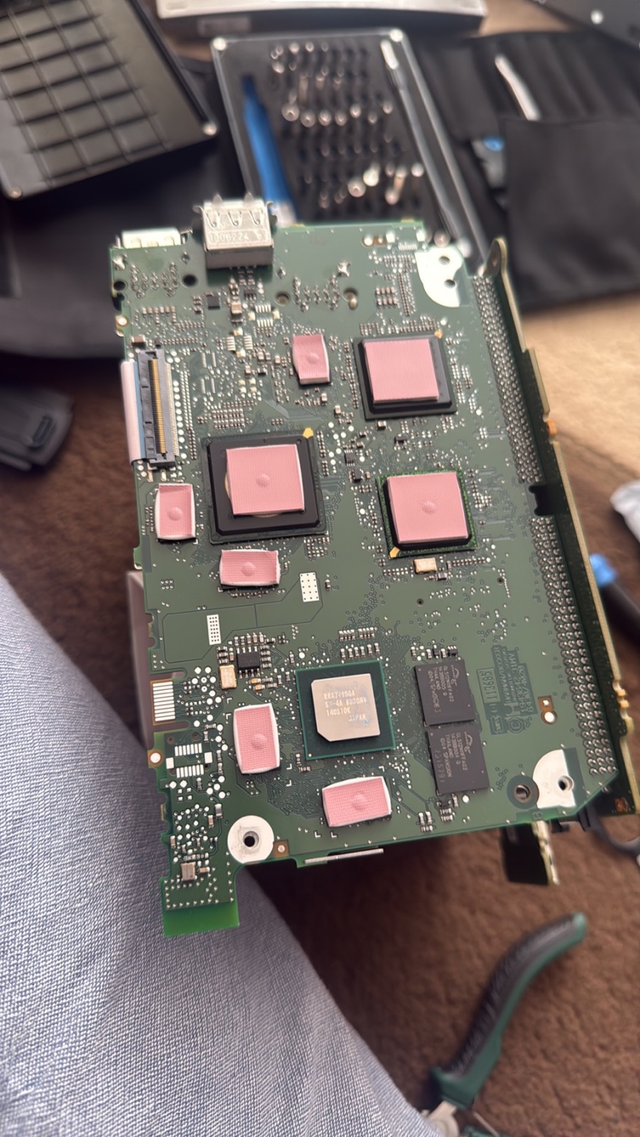

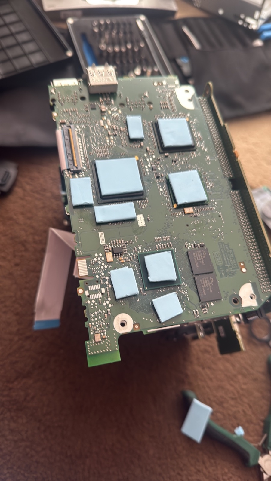

Hi to all. Recently bought an C5X7 with NG4 and Hiaudio. Problem is at random - rebooting. I tried at cold weather (14 celsius outside temp) and very hot summer (around 34 degrees). Reboot is not affected by outside temp or audio level. I tried to replace hdd with CF card, but found only 8gb on reasonable price and to clone the hdd we need at least 40gb for all the partitions. I fully disassembled the unit and found old thermal pads that i replaced. I will try to resolve the problem like this and if it work's - will confirm in a later post.
Red ones are before and blue after replacement.
