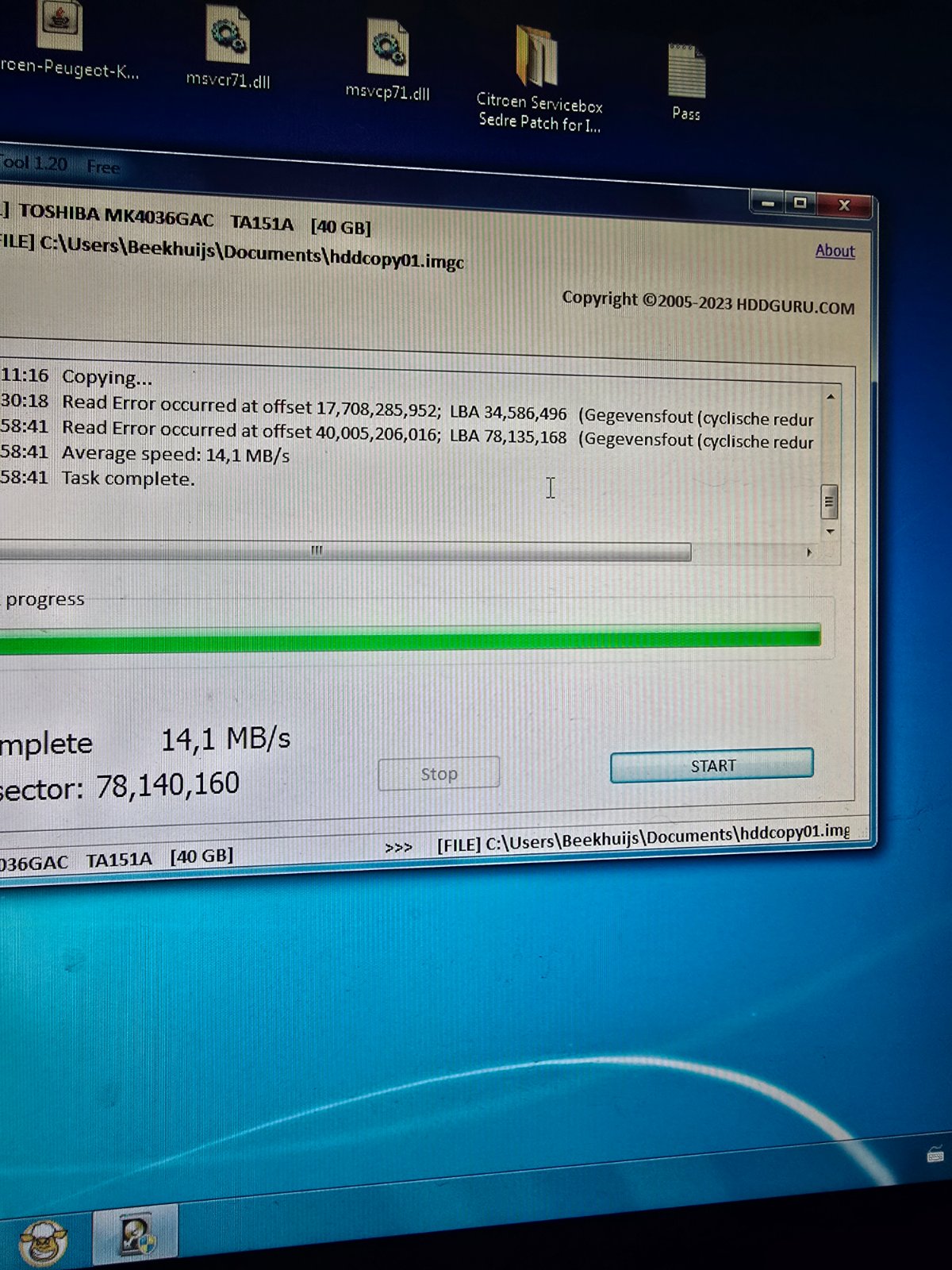

Re: Guide to Replacing the NG4 Navidrive 3D Hard Drive with a CF Card
Today I try to copy the HDD to a CF CARD.
By copy to a image file i get 2 errors.
I wonder if the system still works when I copy this image to the CF CARD.

Kees
- Posts: 588
- Joined: 16 Nov 2021, 16:16
- x 147
I did last time make a image file on the PC.
Then i bought a hdd from a laptop 40 Gb Toshiba MK 4032GAX.
This drive has the same connector and mounting holes as the original one.
So i put back the image file and the unit startsup, correct, but you have also must upload the navigation cards again.
