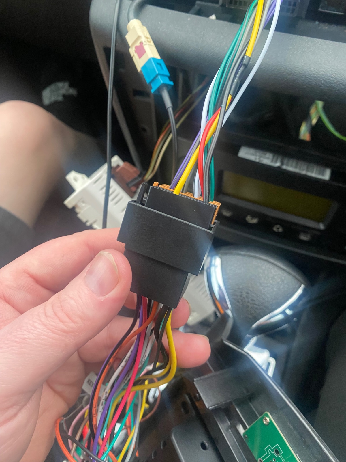

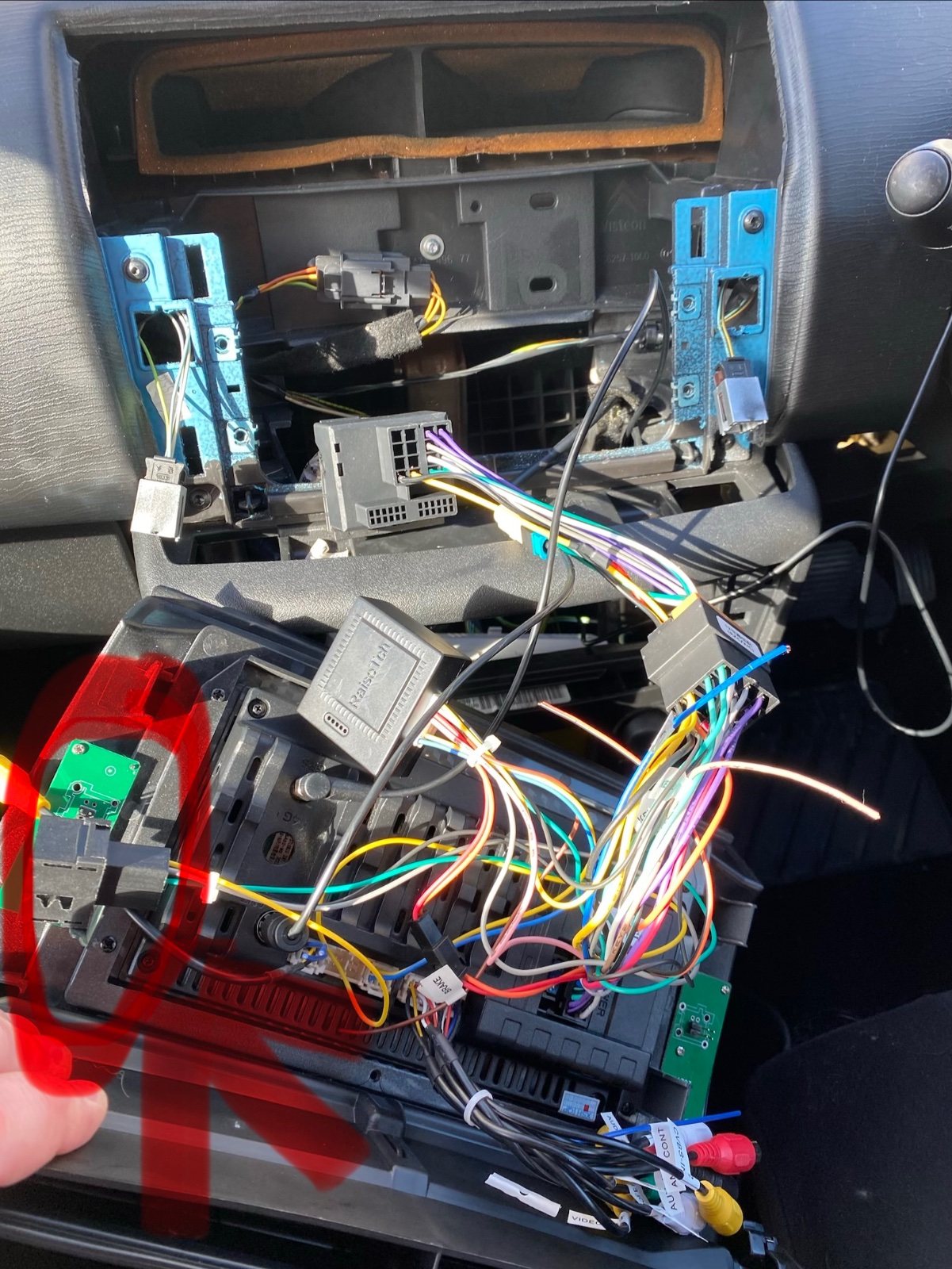

I can’t get it to turn off when ignition is off drained battery
Also I can’t get cambus to do steering wheel controls
Any help please
Thank you

Which model, body style, engine, gearbox and RPO number from the door pillar tyre pressure sticker is the car? With that info I may be able to find the diagram for the audio unit wiring :)

C4 exclusive auto 2L petrol I will get the rest of info tomorrow thank you for reply

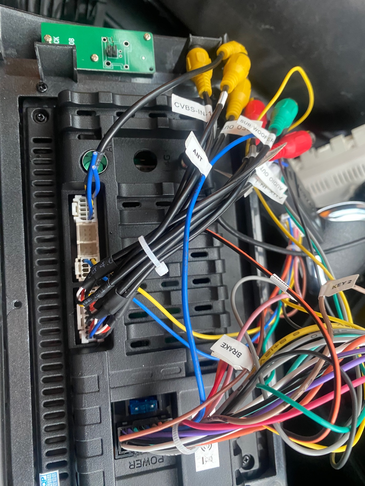

Are you able to upload the installation instructions here?
Sounds like its not been wired up as per the instructions. Just because it has a connector that may match the original doesn't necessarily mean its plug & play.

With the info you have given I've guessed the RPO to be around 11190 and produced this diagram:
C4 Audio.pdf
Copied from servicebox backup
(3.48 MiB) Downloaded 43 times
In order to interpret the diagram you may find the guide at this link useful:
viewtopic.php?p=782862#p782862

I am an amateur fitted it myself following you tube video.
All works except cambus steering wheel controls and only goes into sleep mode with power button. Switch off completely.
Thanks
