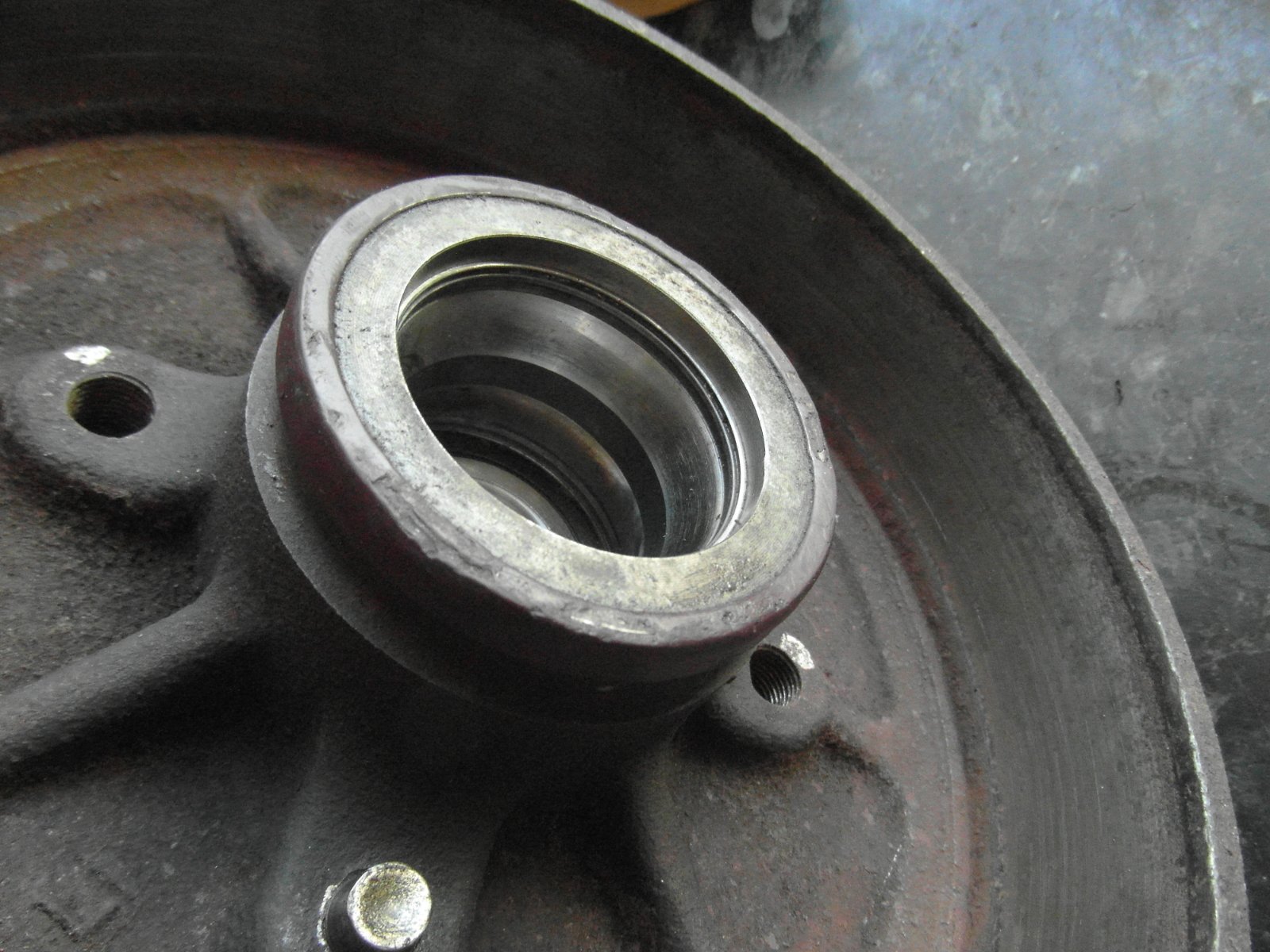

Re: 206 REAR DRUM BEARING REMOVAL
Somewhat belatedly, a photo of the ABS RING still in - situ.
I was unable to upload this at the time of my original post, there was no indicator icon/logo that I could see, to allow me to do this .
I have now found the link which is only visible in the EDIT / review page silly me !
that looks like the seal holding the bearing in
- Posts: 9438
- x 1943
Agreed. That's an oil/grease seal. I can't see any evidence of an ABS reluctor ring.
Steve Walsh
- Posts: 778
- Joined: 25 Oct 2019, 07:20
- x 518
Most (modern) cars have Reluctor ring in the bearing

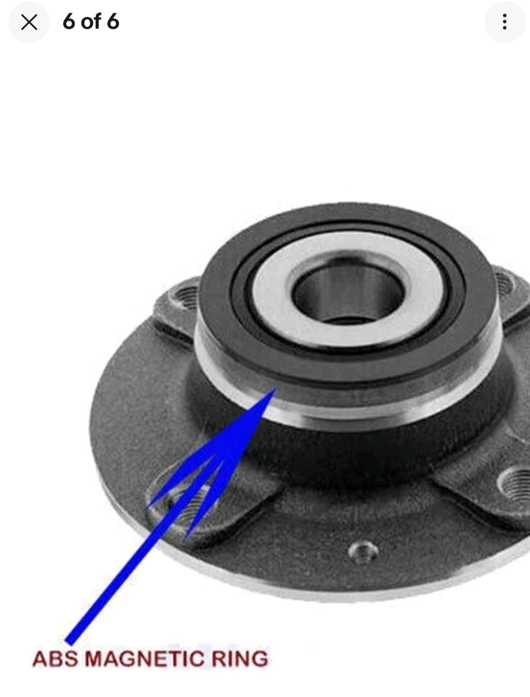

Here's a picture of apparently the bit in question (from the eBay link I found above)
