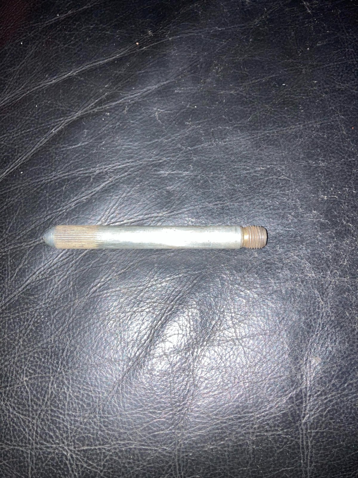

Re: Wheel bolt thread for 2014 C4
M12 x 1.25. This one is from my C5 Aircross, and is same as all other Peugeot & Citroens I have had, Usully in sparewheel tool kit
Maybee just for the French market but a great aid, As well as in my car I have one in workshop as I work on various cars and it fits a lot of them I also have a long unthreaded one with a taper on the end that fits all the others

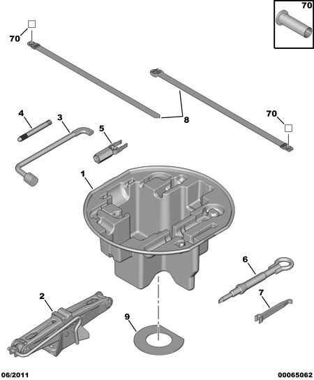

Taken from a C4 5 door parts list Part number 671709 number 5 in picture
Item number 5 is the tool to remove the plastic caps on the wheel bolt heads. Item number 4 is the wheel locating pin.
You are right, Too much wine last night....Paul-R wrote: 08 Feb 2026, 13:14 Item number 5 is the tool to remove the plastic caps on the wheel bolt heads. Item number 4 is the wheel locating pin.
