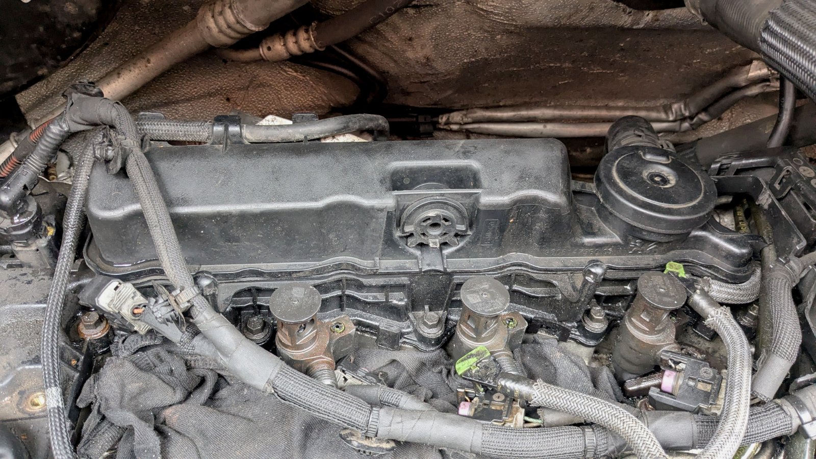

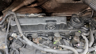

Hi, I know this is an old thread, but did anyone get to the bottom of this? I have a late 2017 Boxer 2.0 BlueHdi 130 with a similar problem which I'm currently fixing. It has the top-end rattle that you mention (very similar), but it also has other problems: It blows out a lot of smoke and sometimes goes into limp mode. Also, the brakes have no vacuum assist. Diagnostics says 'injectors programming', which I've done (and was accepted), but has made no difference and the error just comes back. I'm currently removing and cleaning the injectors and have removed the brake vacuum pump, which turned out to have quite a bit of oil in it, so I'm thinking that these two problems may just be partly linked by a PCV/CCV problem, but cannot see how to get this off. The only option I can think of is to remove the valve cover, is this right? Obviously, not a big job, but I've read elsewhere that there's a valve that fits between the head and the block, which needs an engine strip, which I just don't have the time or facilities to do right now. Does anyone have any more info on this? Photos would be very helpful too! Thanks in advance.
[attachment=0]RockerCover.jpg[/attachment]

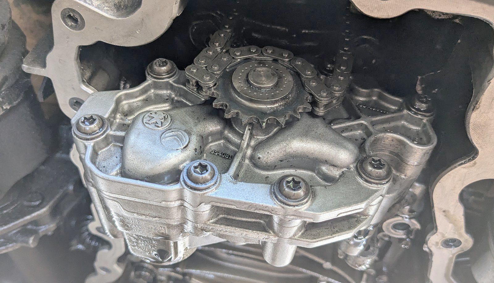

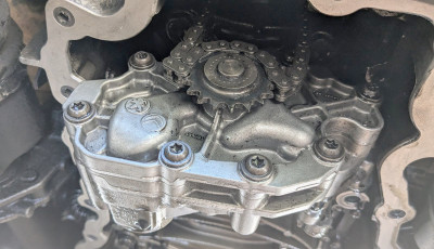

Well, lots has been going on recently, mostly related to getting the injectors out (massive pain, but now done, though still need injector 'learning'). It's now running pretty good, but still has the rattle at low revs and still goes into limp mode around 3k revs.
However, I now have 'low oil pressure' and 'oil pressure control' errors. This is again around 3k revs and will be the original cause of it going into limp mode! Oil pressure is Ok below this, but does not rise with revs, as it should. I've ordered a new oil pressure sensor and control solenoid, which should arrive in a few days and will hopefully fix this, but I also decided to check the oil pump inlet for a blockage. There was some muck in there, but not a lot, not enough to cause a problem, especially as pressure is OK below 3k (around 2.4 Bar).
However, the pump chain is very slack!
I can't replace the chain, as it's a full engine out and strip (crank out) job, so that's not happening, and there is no tensioner on these, but I thought maybe a new pump and sprocket might take up a tiny bit of the slack. With 200k on the clock, a new pump would probably not go amiss anway. The trouble is, I can't get the pump off!
I've taken out the two fixing bolts and the pick-up tube, but although it will move up and down at the back and I can easily take the chain off (see photo), it is very stuck on the front edge! I've tried prising and tapping fairly hard with a mallet (away from the oil union), but it just won't shift! It seems like it's stuck at the oil outlet to the crank, but online photos show this to be a flat connection (pump side anyway). Is this just naturally very tight, is there a joint/seal that has to be prised off, as I suspect, or do I need to take care or do/remove something else?
How does this pump come off? Is it usually easy, or do I just need to apply more pressure? I know bobson6 has taken his off, but he doesn't seem to be on here any more. Can anyone else help, is there something I've missed, or am I just not using enough force - I don't want to risk damaging something!
This is a 2017 2.0 BlueHdi, very different to the 2.2, for which there is a ton of information online. I just can't find anything on this for my engine (DW10FUD). Thanks guys.....
