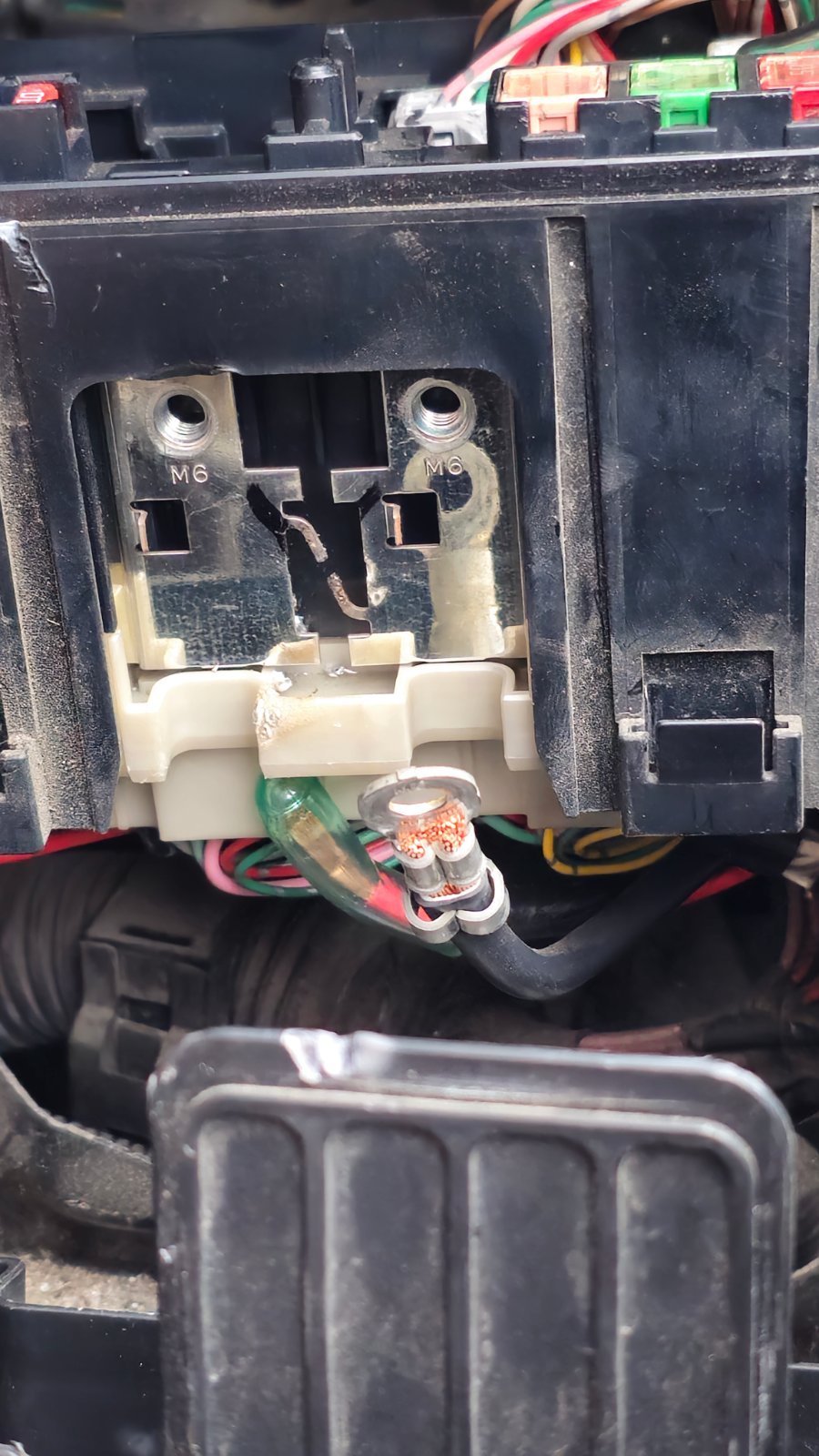

Hiya
Battery not charging. Alternator seems okay. Took off top cover of fuse box in engine bay and a large metal strip between two chunky wires had broken. I assume this is a secret fuse. Doesn't seem anyway of replacing it? Soldered on a wire with fuse to join. Put in 20a fuse to test. Connected everything back up and issue resolved.
Does anyone know what the fuse strip would have been rated for?

Re: C1 2011 electrical issue
The fusible link is rated at 120 Amps.
Does anyone know if this fusible link part can be purchased? Thinking my solder and fuse temp fix might not do it for long!
Thanks
The parts picture is not very clear but there is a 120A fuse listed but its £40.41
We still dont know why its blown, could be expensive if it just pops again tomorrow.
Personally i would just buy a 120A strip fuse & make it fit.
Something like this > https://www.ebay.co.uk/itm/196060128825
Was thinking the same thing. Will try and source one tomorrow and keep my fingers crossed.
Found bolt on fuse strip on Amazon. 4 for a fiver
Job done. Many thanks

Hello,
Sorry for restarting the conversation but I was wondering if you could pleasd explain how you installed the fuse to someone who doesn't know much about such repairs?
I'm not sure on the rules for linking other forums but if you end up here with the same issue that I had, search for the "Fuses Missing?" post by 97Silverfrost on May 18, 2023 in Aygo & Aygo X Club on the Toyota owner club. You will found pictures and details on how to do the repair.
Hi,
For your question:
The fuse I used was from Bosch with EAN number:
3165143524428: https://www.autodoc.se/bosch/1191123
I have not have issues so far but I’m not a pro so not sure about if there will be repercussions on the car later on.
For other people ending up here:
Some pictures on the Toyota owner forum: https://www.toyotaownersclub.com/forums ... s-missing/
YouTube short showing the box:
I had not cut off the front of the box as on the video, I used a bunch of flat screwdrivers to pop out the latches and remove the cover (it doesn’t go out fully) so I can get access to the fuse.
YouTube video showing the latches location:
Fuse replacement itself is easy, fuse box cover removal was hell.
For your question:
