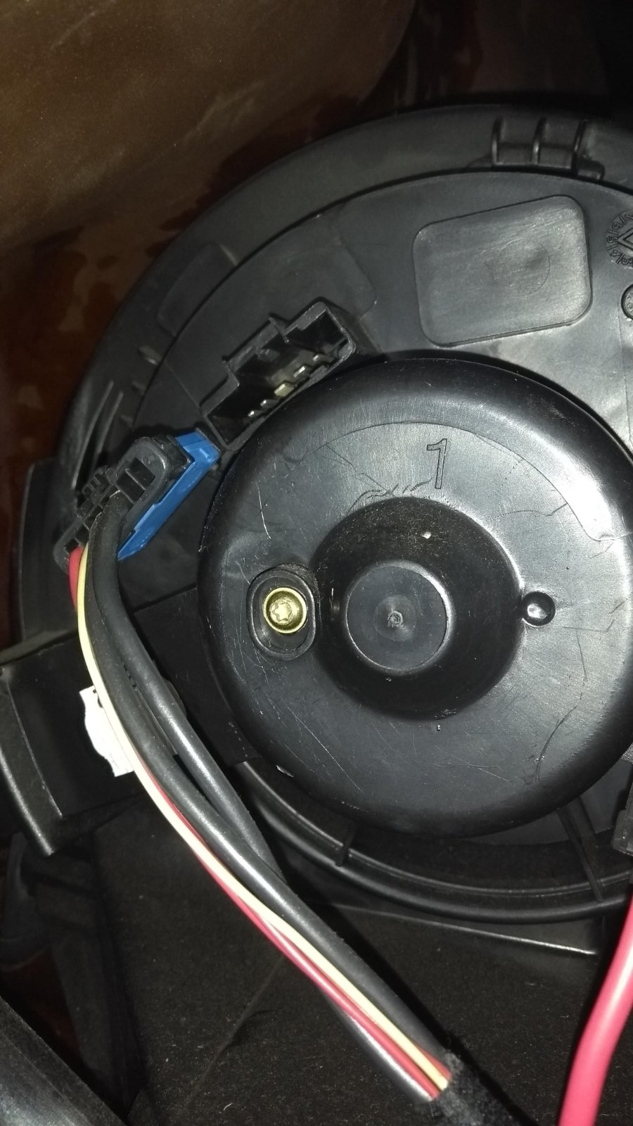

Thanks, I've taken the glovebox out and can see the motor. It's set well back and hard to see what's going on there, so I've taken a photo. I can't see any screws but the blower housing won't rotate. Any suggestions how to proceed please?

You can see one of the little locking tabs, it looks like it rotates clockwise to release to me. There may be at least one screw though to stop it rotating. I it wont be very loose either, they normally need a fair bit of twisting to remove.

I have read that you will have to get a thin screwdriver under this little plastic tab or the motor will not move. Pull it up slightly, then rotate it clockwise around 3cm, then the motor will come out.
