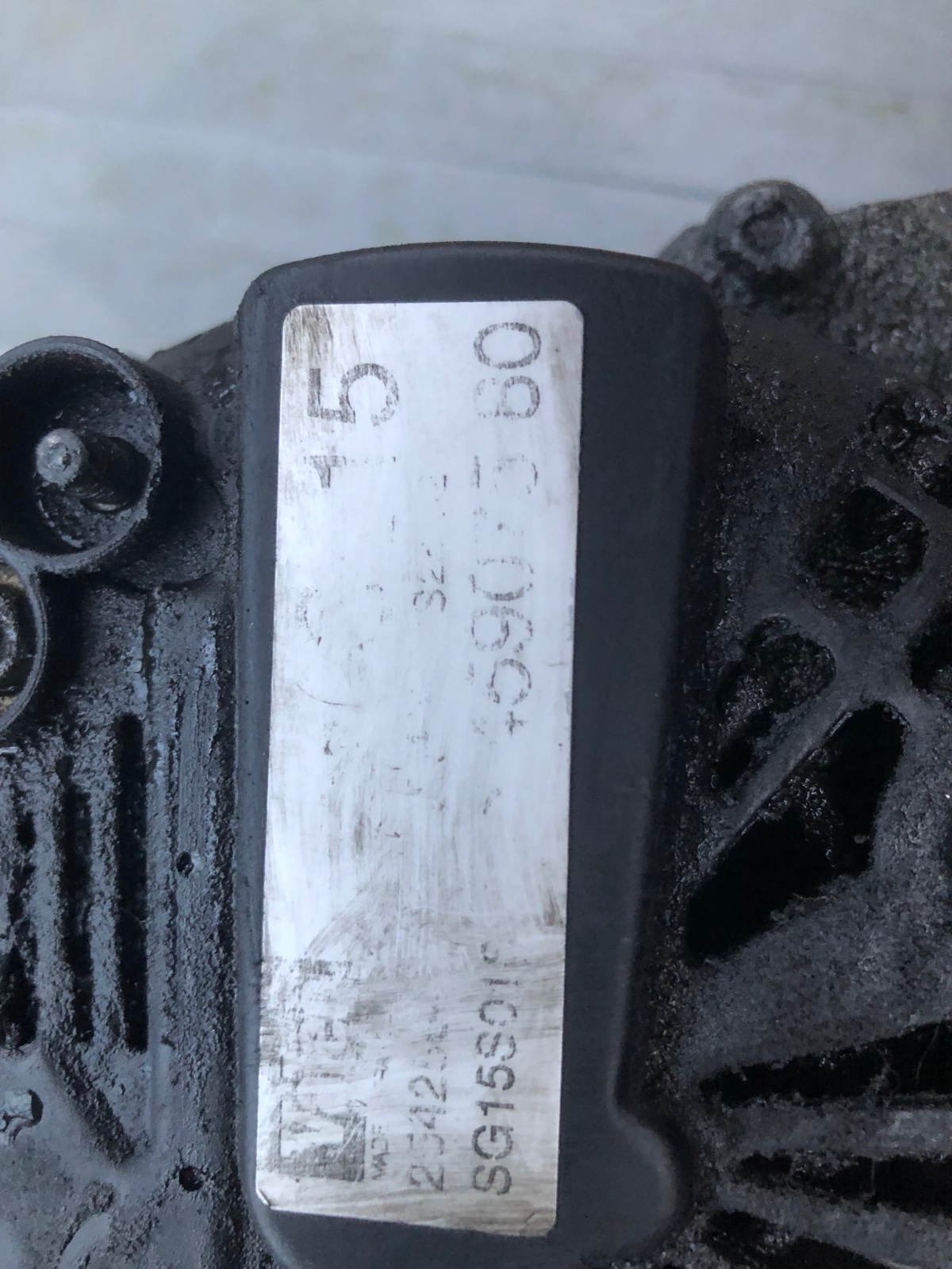

Re: Life on the edge - the Diary of a C5 alternator not alternating
Hello, Friends!
Otterchops here.
I have had an interesting time. Last week, I fried my alternator and Papa had to call the RAC. They lent me a charged battery which got me home. Papa then charged my own and put me on ramps.
The carbon brushes have flowed down the casing and caused the shaft to seize which bust the clutch pulley. So he bought a 2nd hand one. This had the wrong connections.
He then ordered a 120 amp one that has the right connections but he can’t make it fit. Do the different engines have different alternators? And are the bolt spacing different or is he just being a Twit. He says it’s for a 2.0 petrol. The cheek!!!!!
Anyway my old one has this label on the back. Papa thinks it’s a 150 amp unit. Is this right?
Bless him, he’s confuzzled…….

Anyway, he worked out the part numbers from the VERY faded label and it’s a 150A unit.
New one on its way…..
