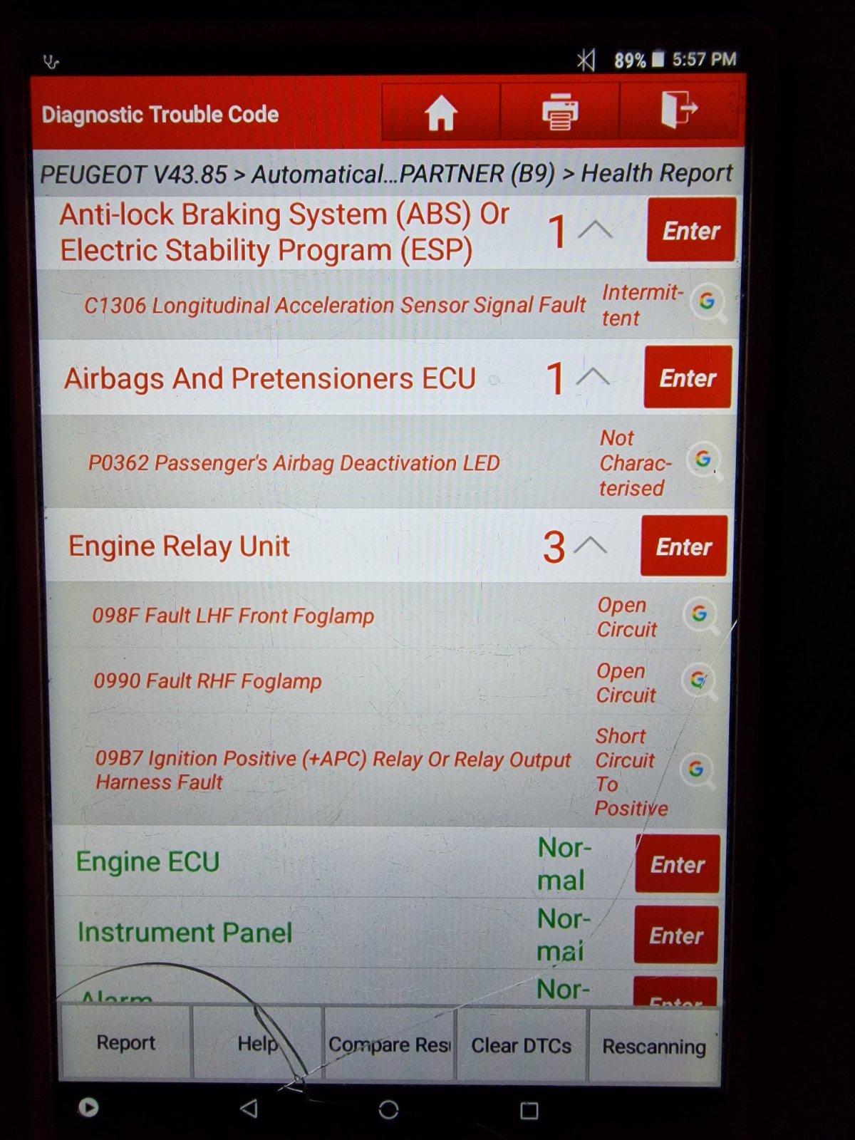

I've just purchased a 2016 Peugeot Partner 1.6 BlueHdi that has a few communication issues. There was was mechanic/mechanics at it previously and it has had an ECU kit fitted to it (Unknown as to why this was done). It had a wire stuck in the engine bay fuse box, bridging fuse 13 to fuse 10. This was said to be allowing it to start. It did seem to be the case, as after I removed it, it wouldn't start. But it is now starting without it. It's starting and driving fine but the power steering isn't working nor are the wipers, with the power steering light on the dash. I have tried replacing the engine bay fuse box with one that I know is good, but it didn't change anything.

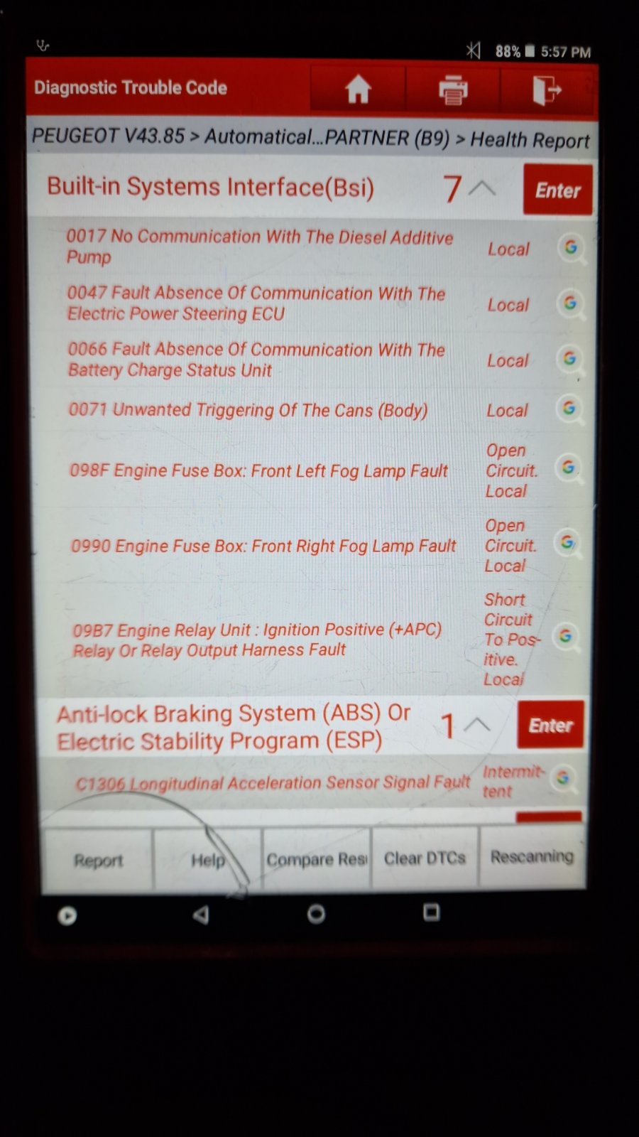

I have attached the fault codes from my launch diagnostics. Any help is greatly appreciated 🤯

Have you carried out a bsi reset and cleared all the codes since removiing the shunt wire you mentioned? If not that is the next step as some codes may be historic and now confusing the issue. So I'd adviise doing that and then scan again to see what codes return. :)

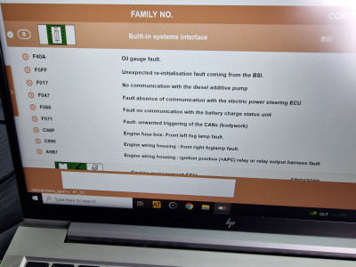

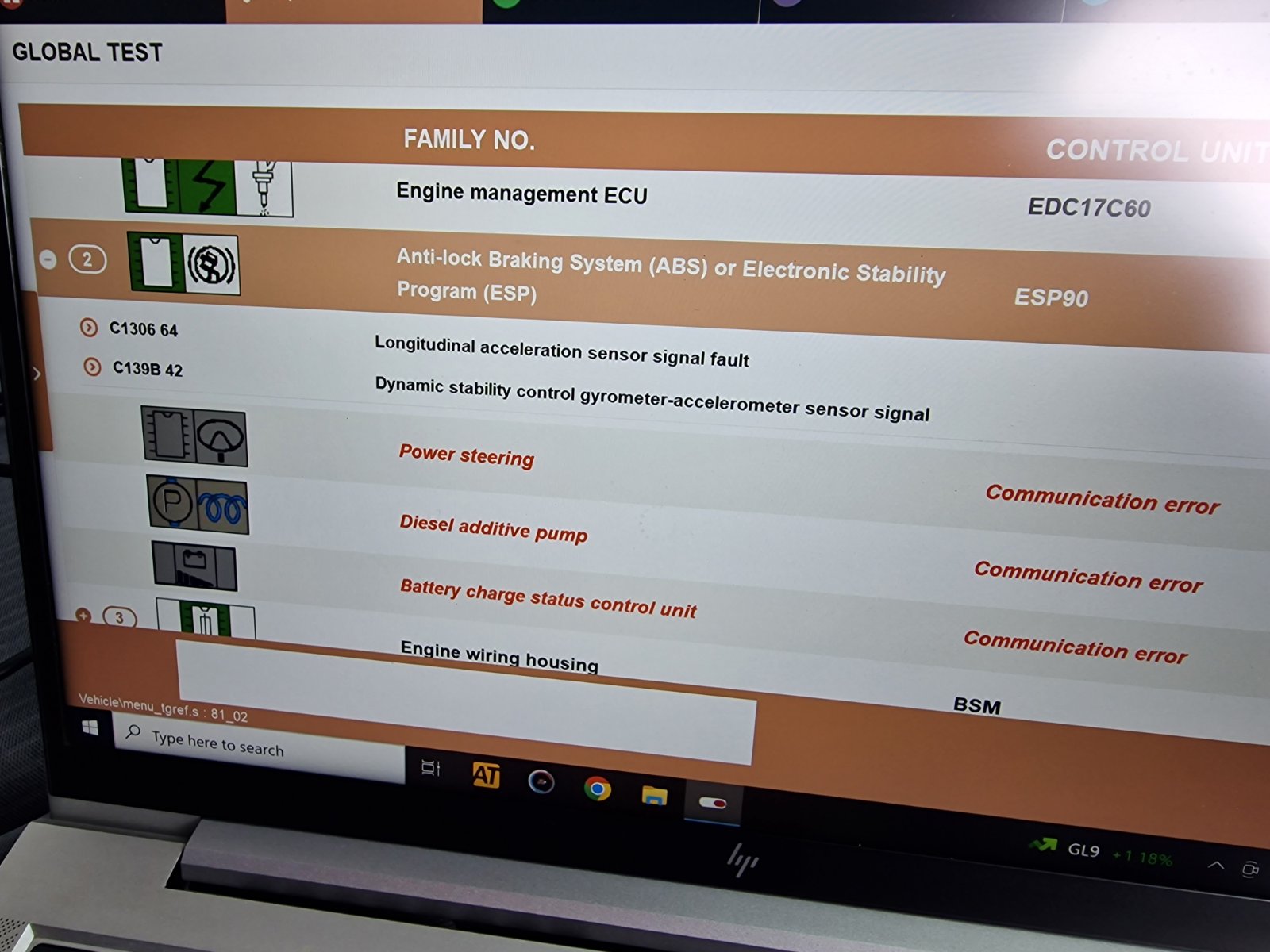

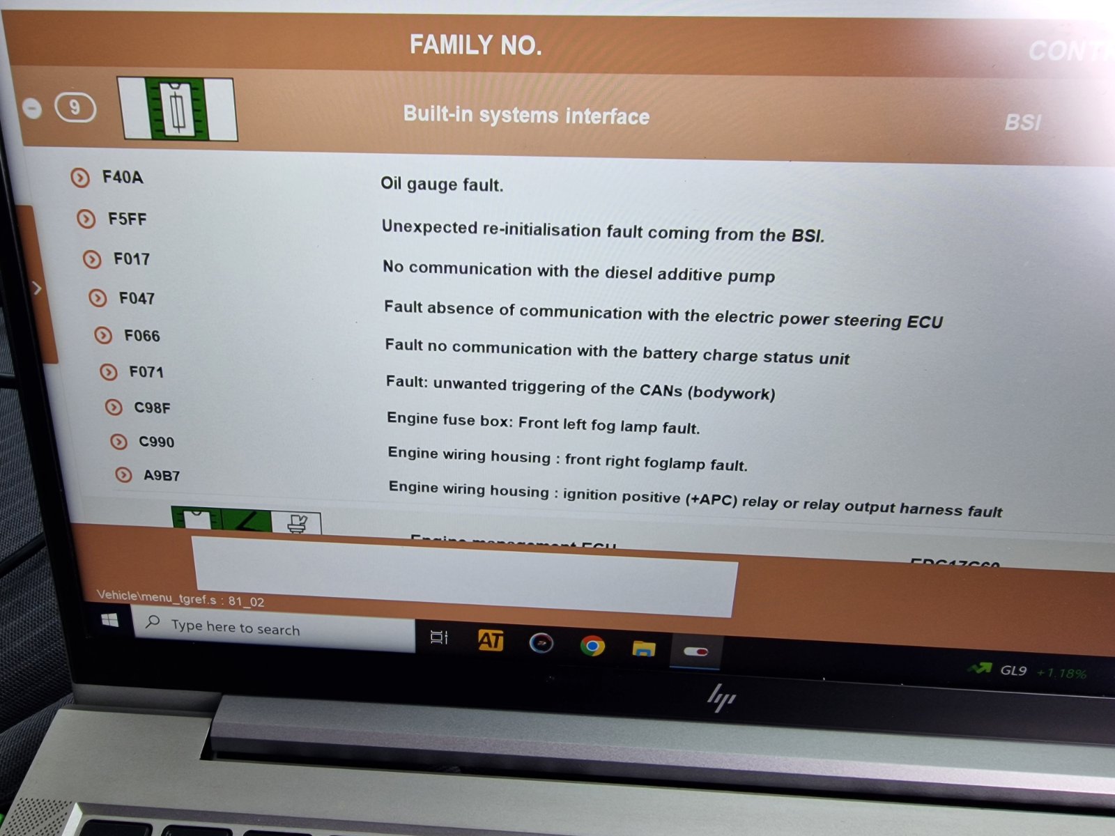

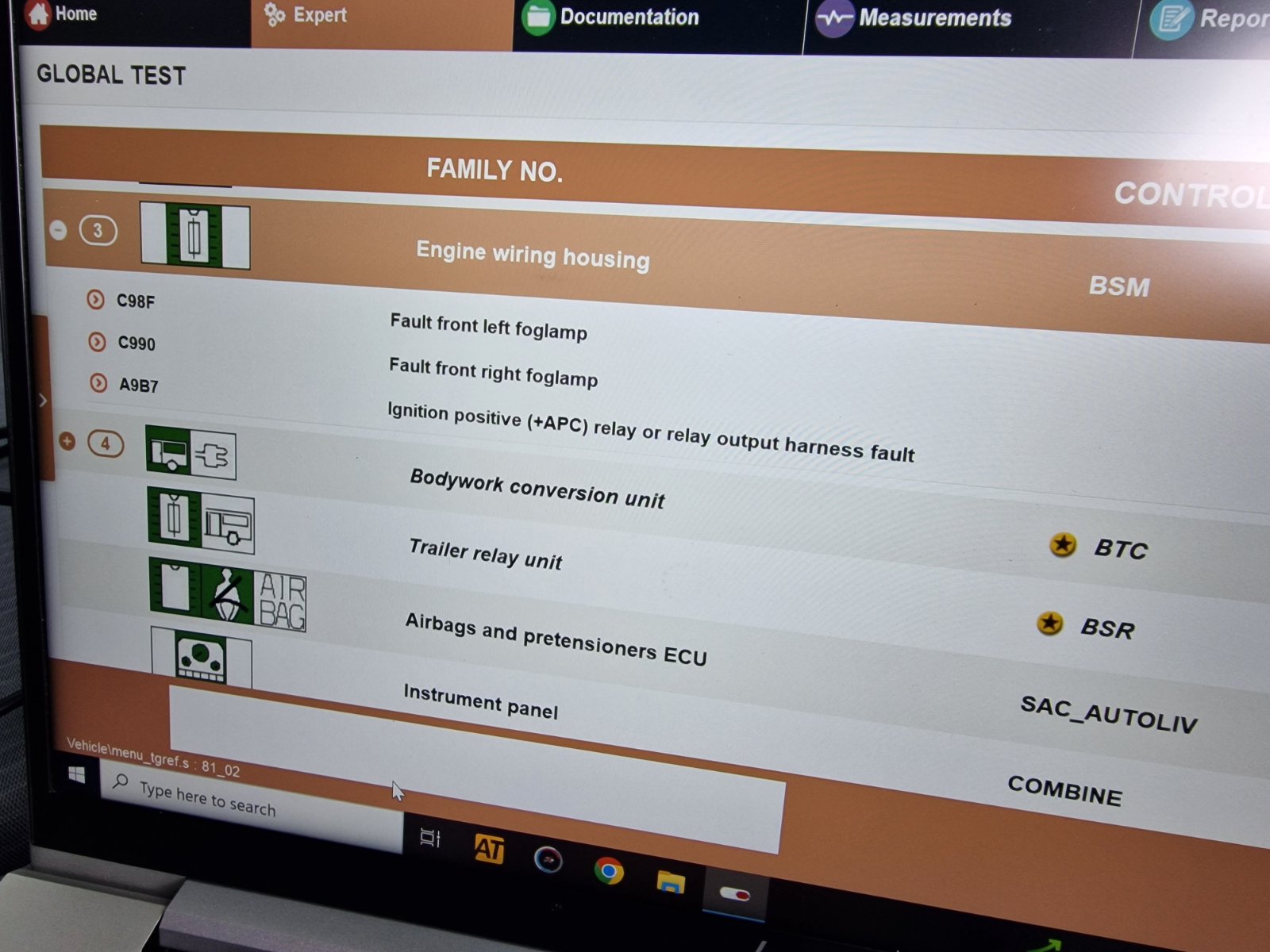

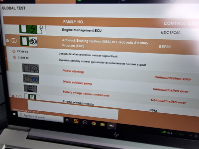

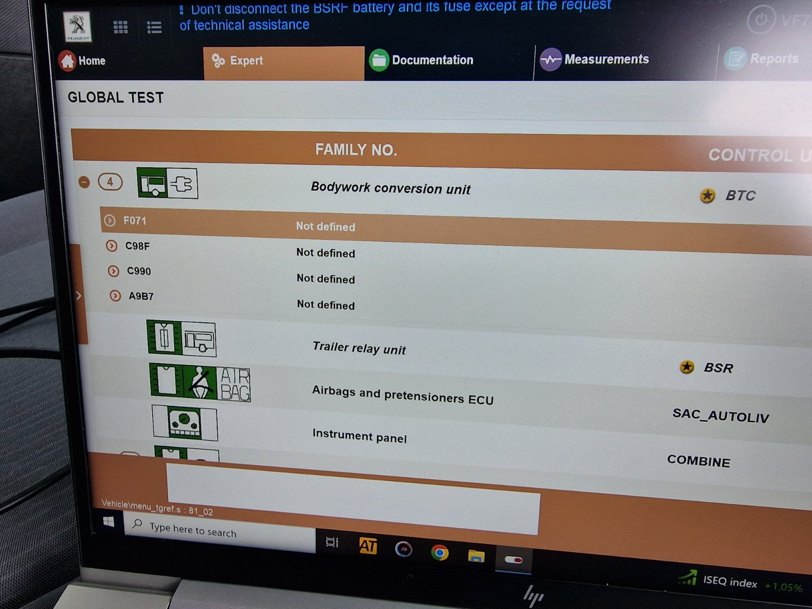

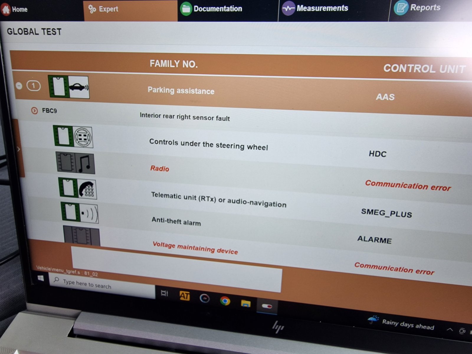

Unfortunately the BSI Reset didn't work.. Just to add. The dipped headlights also turn themselves on randomly when parked. I've had to keep the battery disconnected. And although the wipers don't work, the motor was getting extremely hot, so I pulled the fuse for it.
I have attached pictures of the Diagbox diagnostics, hopefully may be more helpful.
Thanks again.
Posts: 21245
x 8130
Re: Peugeot Partner Communication Issues
It certainly looks like you have a serious issue there but it may all be down to a poor battery/alternator system. I think you need another member with deeper knowledge than me to offer further advice. But check the battery voltage under load and post that figure up . :)
